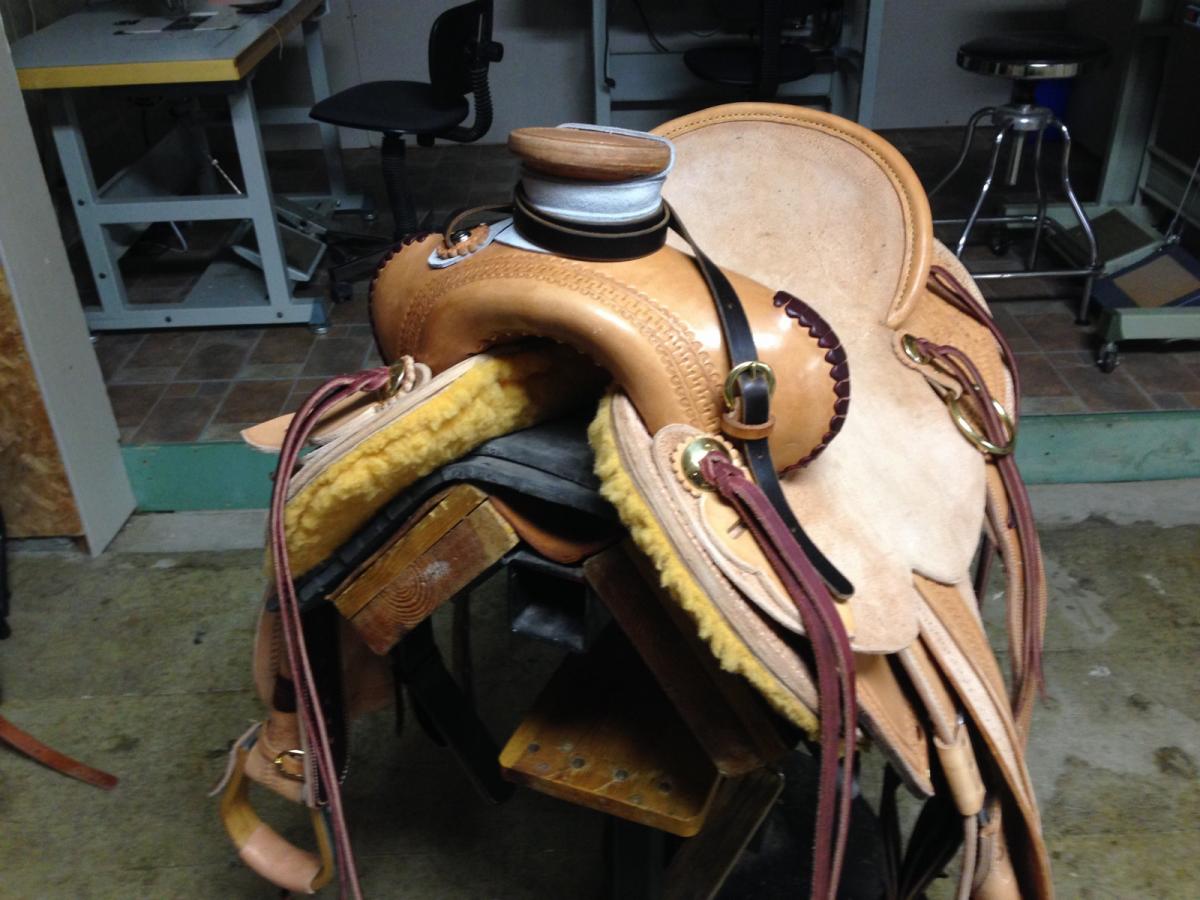

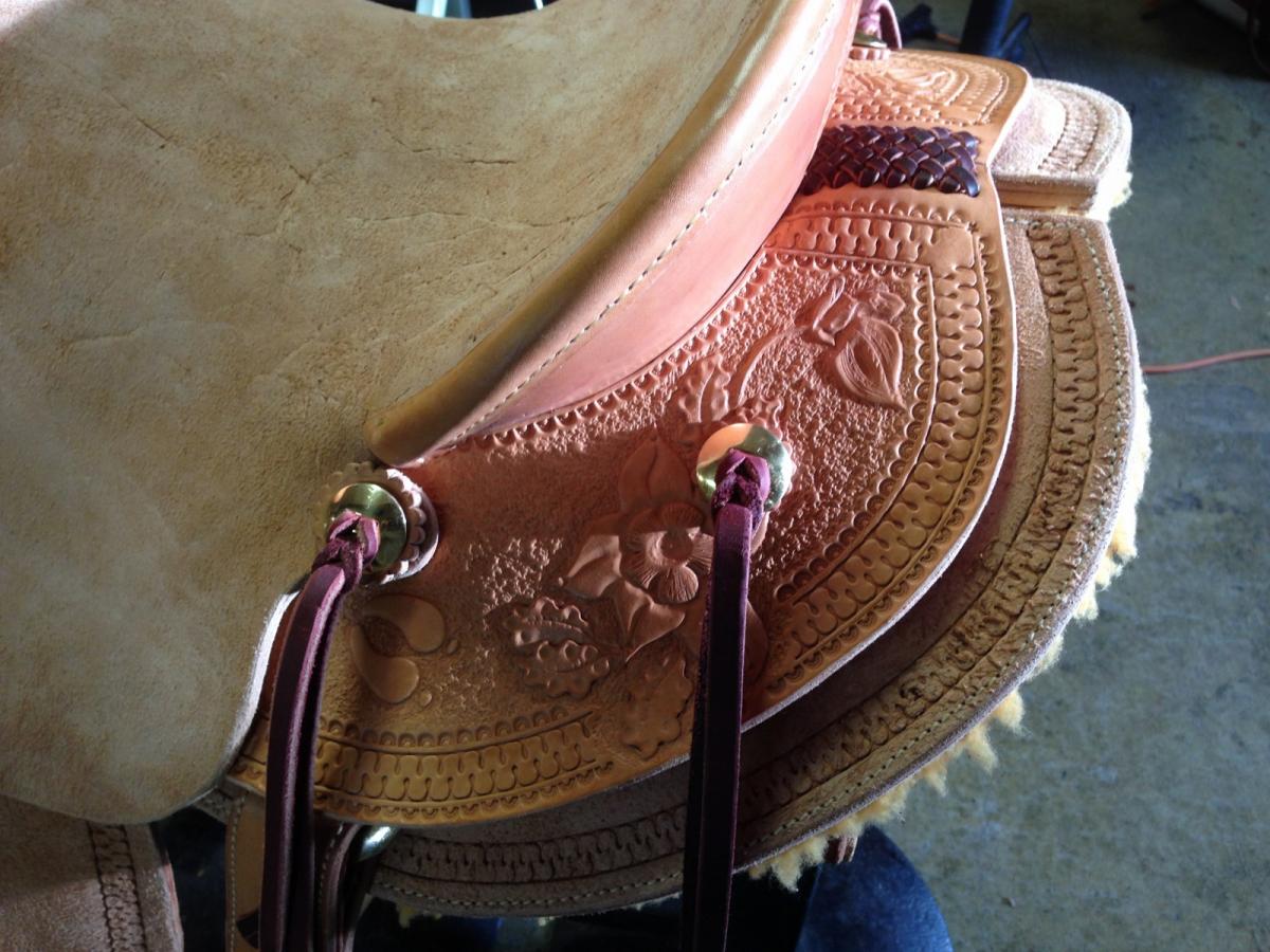

First Saddle - 15-1/2" Wood Post Will James
thecowboy7 replied to thecowboy7's topic in Saddle & Tack Maker Gallery
Thanks for chiming in. I see what you're saying with the skirts, but in person they really don't look all that out of place. Doesn't seem to affect the way it sits on the horse at all. Still, after looking and re-looking at the saddle (ok, I may have spent a good 1/2 hour going over it this afternoon) I agree those skirts are a tad bit high. Thanks for pointing that out. As for the Blevins... was intended to be lower but the inseam measurement I took was off just a bit... couple that with the balanced ride set-up and I ended up having to raise the stirrups up for the shorter inseam. For a taller person I think they'd sit fine. I don't think I'll do the balanced ride again unless someone really presses me for it. I like the way it rides but there definitely isn't very much adjustment in the stirrups! Again, thanks for the advice. Much appreciated! ~ David -
CW, Thanks for the compliment and the advice. The seat jockey was definitely one of those things I would do different. It just doesn't sit right (pun definitely intended) to me. I like your idea of running it to the center of the swells before the upswing. Thanks for the input! ~ David -
Thanks Randy! You'll really like building a Will James. My tree came from Randy at Timberline Trees. Very happy with it. And yep, I do have a shop in Fredonia. My wife's family is from the area. We've only been here since Nov, and the shop is just now up and running (and by that I mean it's in my garage lol). Hey Brandon! Yep, I did work for RTR and remember going on a few rides with ya. You came by to rope with us a few times also, right? My folks live in Del Norte, so I do a few orders for folks in the area that they know. I'm usually there a bit in the summer, and would really like to get some outfitter permits for the area sometime in the future. Next time I'm there maybe I can swing down and say howdy. -

From the album: "Gallatin" Will James
Combination of Columbines and Elk Tracks© 2014 Twin Mountain Saddlery
thecowboy7 posted a topic in Saddle & Tack Maker Gallery
Howdy folks... got my first saddle finished (and starting on another when the tree gets in next week). I built this while at Dale Moore's shop in Belgrade, MT... was very fortunate to get to help build 2 other saddles before starting this as my first solo project. I'm pretty pleased with the results, but definitely see a few things I'll do differently on my next project. Specs: 15-1/2" Will James w/13" swells Wood Post Horn Half-breed design San Carlos Border w/tooled jockeys 7/8 Flat Plate Rigging 5" Cantle (tooled) I'll try to take some more pics today and put them in an album. This is first time posting pics so I hope they show up ok... Any and all feedback would be much appreciated. Thanks! ~ David Twin Mountain Saddlery Fredonia, KS ~ Del Norte, CO www.twinmountainsaddlery.com -
