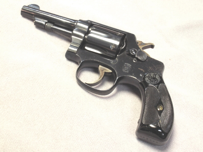

Thanks for the advice, Dan. As I said, my budget is very low and I was hoping to go straight to jail without passing "Go!" but I suspect you are right: I can't get there from here. The two handguns that I want to make holsters for are . . . Taurus Millennium Pro PT40 semi-automatic in .40 S&W, and Smith and Wesson revolver Hand Ejector Model 3 in .32 cal. I've attached pics of the handguns. Is there a way to post pics in line instead of as attachments? Can't find much in the way of FAQ relating to posting pics.
