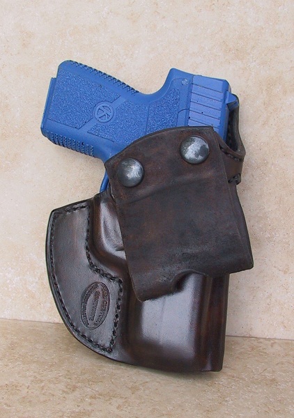

This is a IWB CP-1. I dd it in antiqued Cordovan Horsehide and Black Shark trim. I figured I needed it to go along with the new belt I made myself a while ago. It's hard to tell from the pics, but the makers mark is dyed black to offset the cordovan. I made this to wear right in line with my back jeans pocket. Hope you like it.

LOL, I have my days when IWB is tough on me too. Thanks for the compliment. I really like working in Horsehide. It's much smoother on both sides, because of the tight grain. You can also get away with a thinner weight and get great molding and long term retention. I highly recommend the butts that they have over at Zack White.

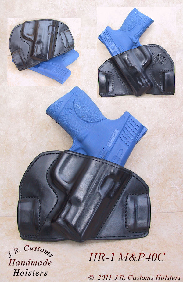

Here are a couple of new ones I just sent out. The High Ride HR1 is for the S&W M&P 40C in Black Horsehide. The IWB-SS Low Ride is for the CW9 in antique Horsehide. It has an extreme rake and sweat guard.
