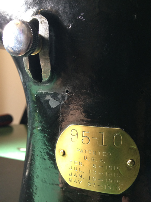

  1. 8 years old, Thanks.

  10. That setup you have there looks like it works pretty good. Bob Thanks Bob, also my 95-10 can sew up to 6mm long stitch, just little modification on regulator groove:
  11. I'm really like 95-10, I'm sewing with it 7mm tick leather belts, with roller, servo motor and 8" pulley instead of original Singer fly wheel, also on motor side I just change 2" pulley to very small 1" pulley: 95-10 with DC motor
