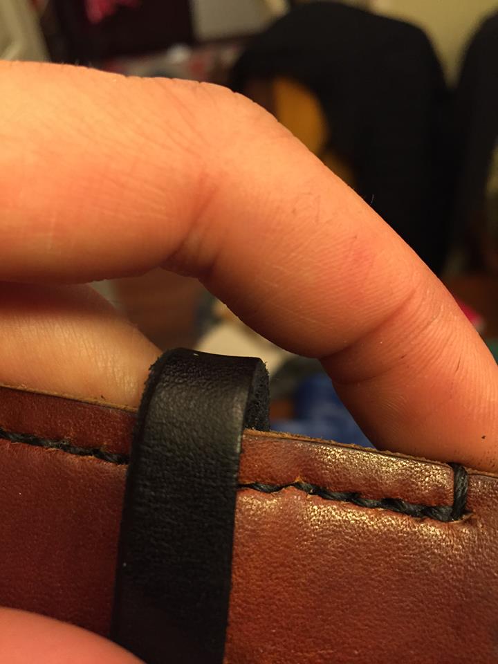

  11. Hi everyone, I was sewing a belt for the second time and I realized that I changed the stitch formation for two-three stitches under the belt keeper and perhaps changing back to the original formation caused there to be a large space in the leather, but it seems like the stitch is holding on to less. Should I be concerned about this tearing and turning two stitches to one, and possibly loosening the belt keeper from its tight setting?
