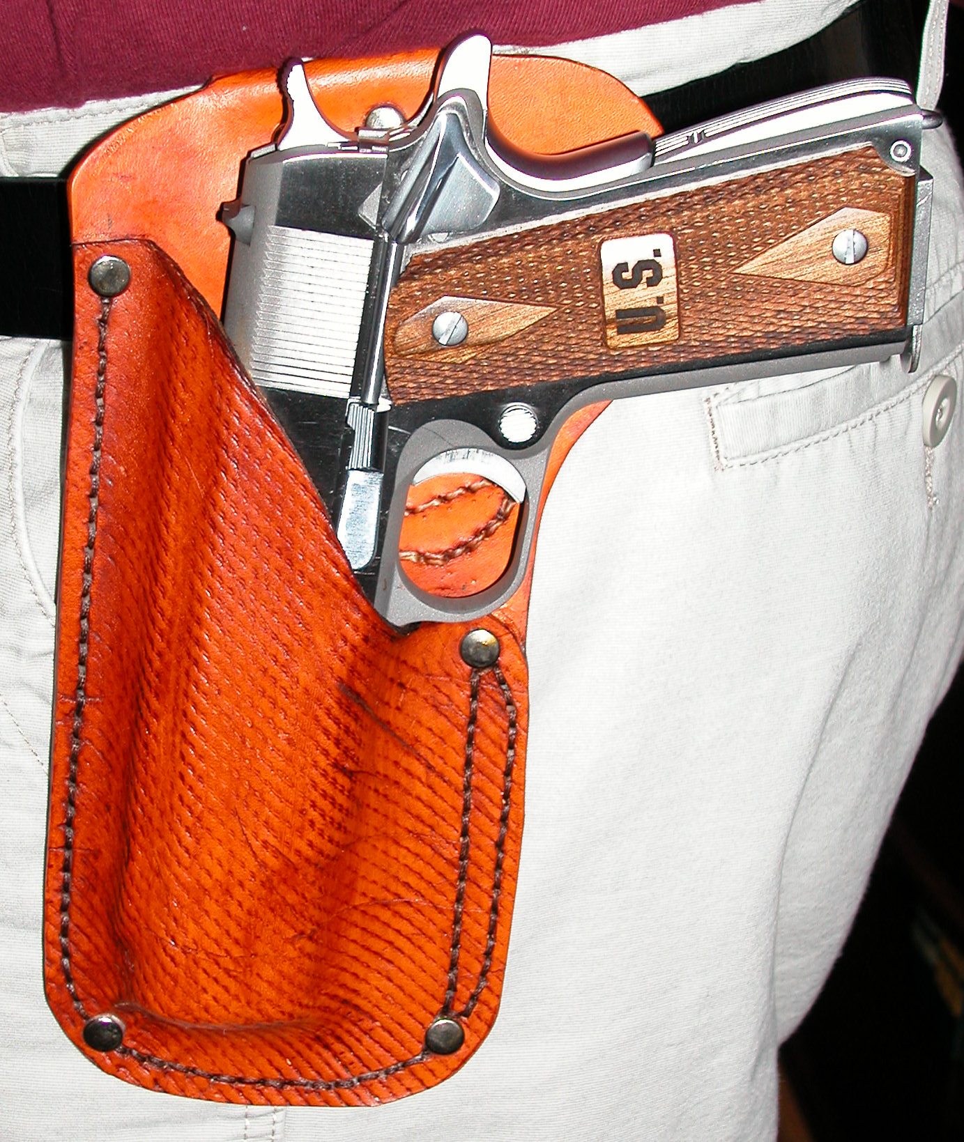

  4. Thanks Big O. Do you have a pic of one you have made? I am still trying to get a good feel for what makes a good holster. I am learning more about what makes a bad holster.

  6. Thanks. I agree with you on the trigger cover after the fact. I just got the bug to do it this morning and did this one to go through the process for the first time. I made many notes on things to do next time.
  7. This was my first attempt at a molded leather holster. I was encouraged by the other great post on this site – thank to all! I used some scrap pieces so there are a few scars. I used a vacuum press to mold the top half. I am a newbie at this and was surprised that the actual labor was only about an hour. I have a few Ruger Blackhawks that I will be making templates for and will post what I come up with. I would be more than happy to leverage anyone else's templates if you already have made them.
