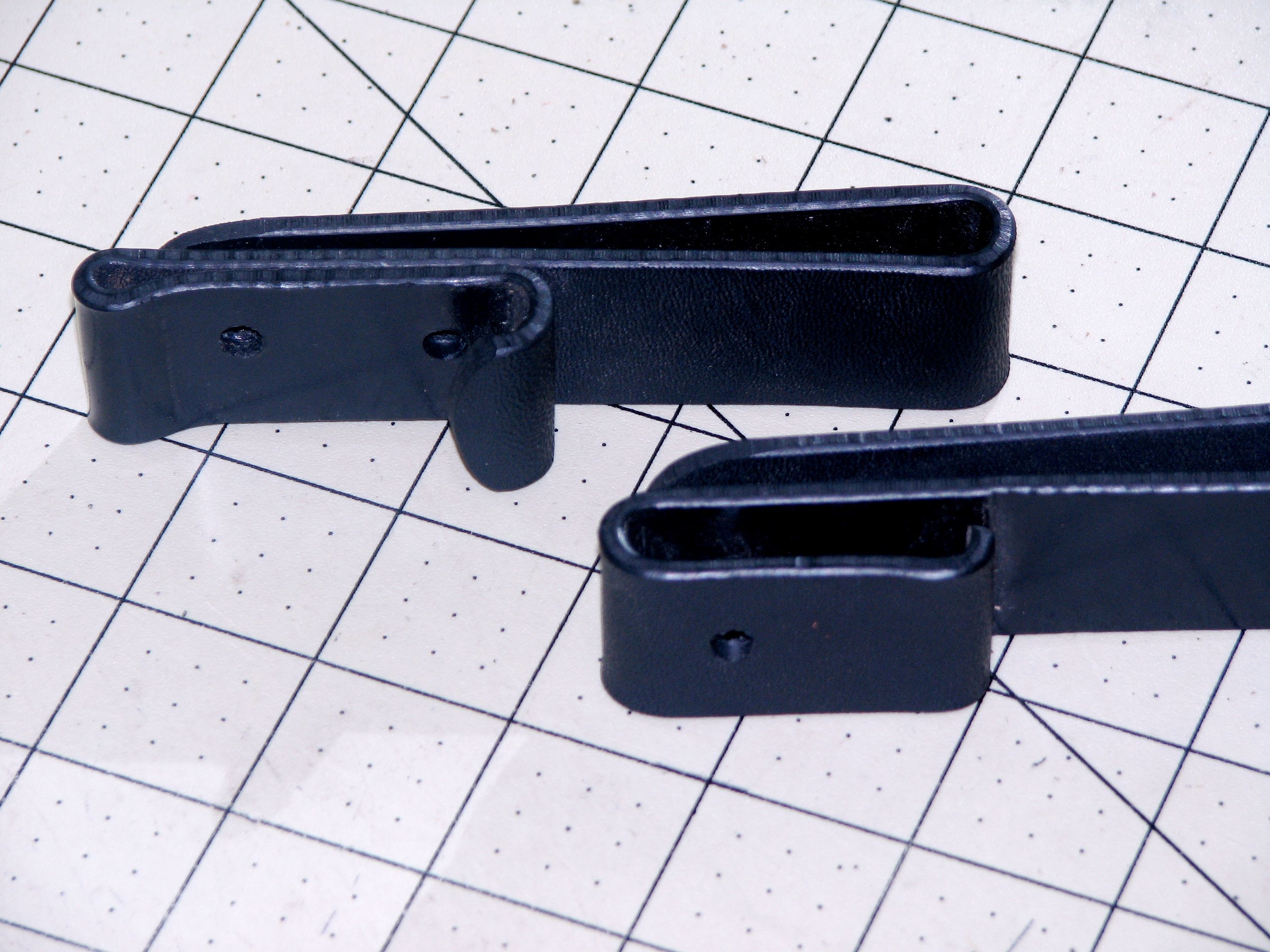

I'll try to take a few photos of my setup this weekend. I make the blanks in batches out of .125" Kydex. I bandsaw the Kydex into 1-inch strips. Smooth the edges with a scratch stock set into a bench vise; then drill two holes on one-inch centers, using a precision jig I made. I round the edges on a bench grinder, and then they are ready for molding. I have a jig made out of heat-proof ceramic tile, with two pins that match the holes in the blank. I put the blank on the pins and heat the blank with heat gun. I use small strips of wood to bend the kydex around. I've made several shapes, like the ones below.... tk -

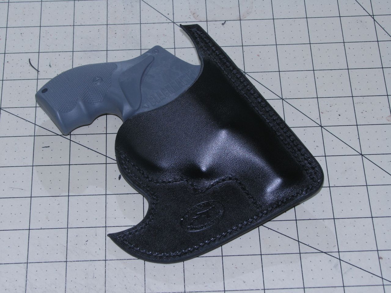

My Version Of The Pocket Holster
malabar replied to OutEast's topic in Gun Holsters, Rifle Slings and Knife Sheathes
One thing that puzzles me is, why do so many folks leave the muzzle-end of their pocket holsters open? One of the primary reasons for using a pocket holster is to protect the gun from pocket junk (also proper presentation, protecting the trigger guard, and disguising the gun's profile). That's an invitation to get crud in your muzzle. -
