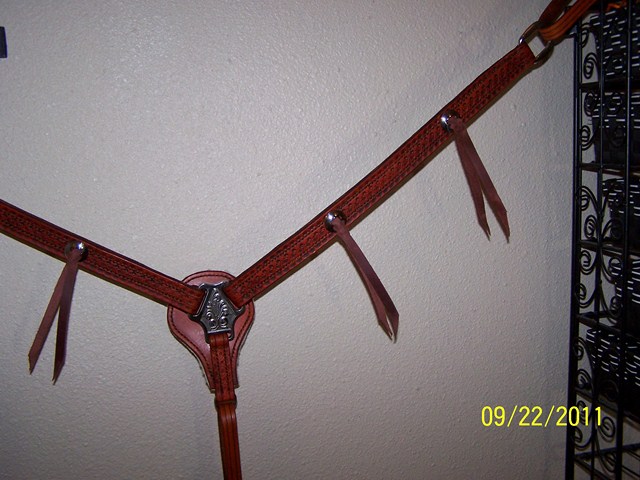

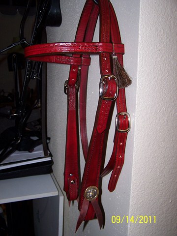

  3. I used 7/9 oz I got from my local Tandy store. I did the dye myself. It's the fiebings oil red and then I used saddle tan antique over that. I gotta say I was very impressed with those conchos, great detail and nice weight to them. Great job on them John! I would like more info on your makers stamps.
  4. I cut a strip of the hide and glued it to a belt blank, then cut another strip which I tooled and then sewed on top of both.
  5. My first attempt at a breast collar.
  6. This was my second try at finishing a belt...the first one ended up in the trash.
