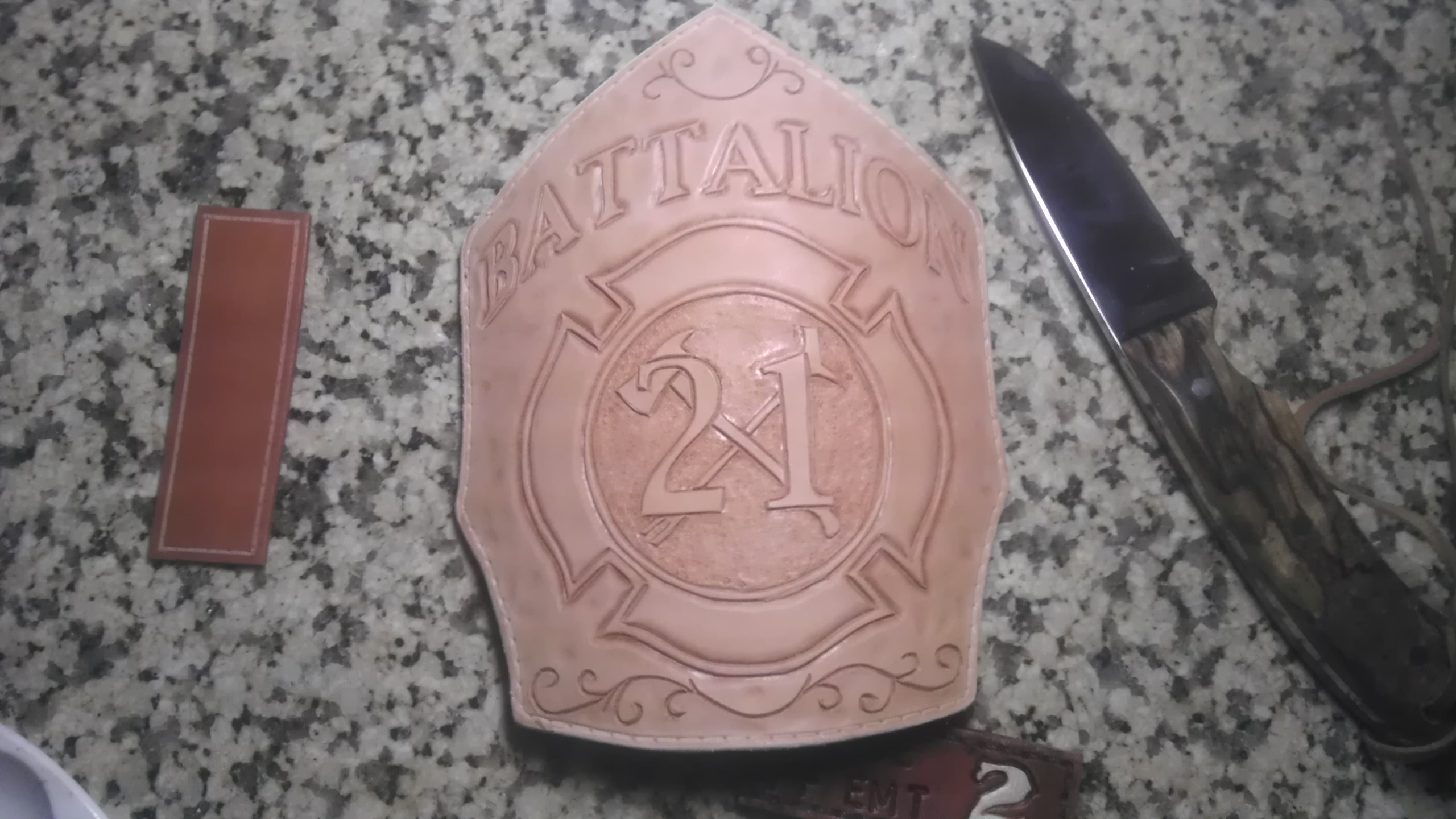

  2. I am doing my second project for a friend and he wants a large part of it white. My question is if there is a white dye? I read in another post that you can add a another color to the white acrylic to dull it down a bit which I think would be my best bet if there is not a white dye. In the pic, he wants the background white.. some kind of Fire Chief thing.. I think it would look great stained and put some anitque on it, but I am not a Chief. Thanks for any help!

    Fire Helmet Shield
    Sorry for the delay in responding. Been out of town. I used veg tanned leather and I think it is 8 oz. I tooled the front and then cut it out just shy of the final size. I then took another piece of leather that was larger then the front, glued it to the back, then immediately wedged it in between 2 - 2 gallon buckets to give it the curve (I put the leather in wax paper to protect it while wedging it in). I let it sit overnight. I cut the back piece of leather down to the same size as the front and then used a dremel to sand it down to the finished size. All I had around for paint at the time was some cheap acrylics that my wife had. I painted it then sheened the paint, then stained it. Unfortunately, the sheened areas of paint rubbed off when I stained it (my mistake) so I then went and bought some better paints ( Wicked by Createx that I can use in my airbrush too) and repainted it. I then stitched it and airbrushed on the final sheen. If you have any other questions let me know.

  9. goose27
    Fire Helmet Shield
    Well I just finished my first leather project. It is a shield for my leather helmet at work. Please let me know what you think and any suggestions and advice. I plan on making some more for the guys on my company, but first I have some leather projects for the upcoming hunting season to try.
