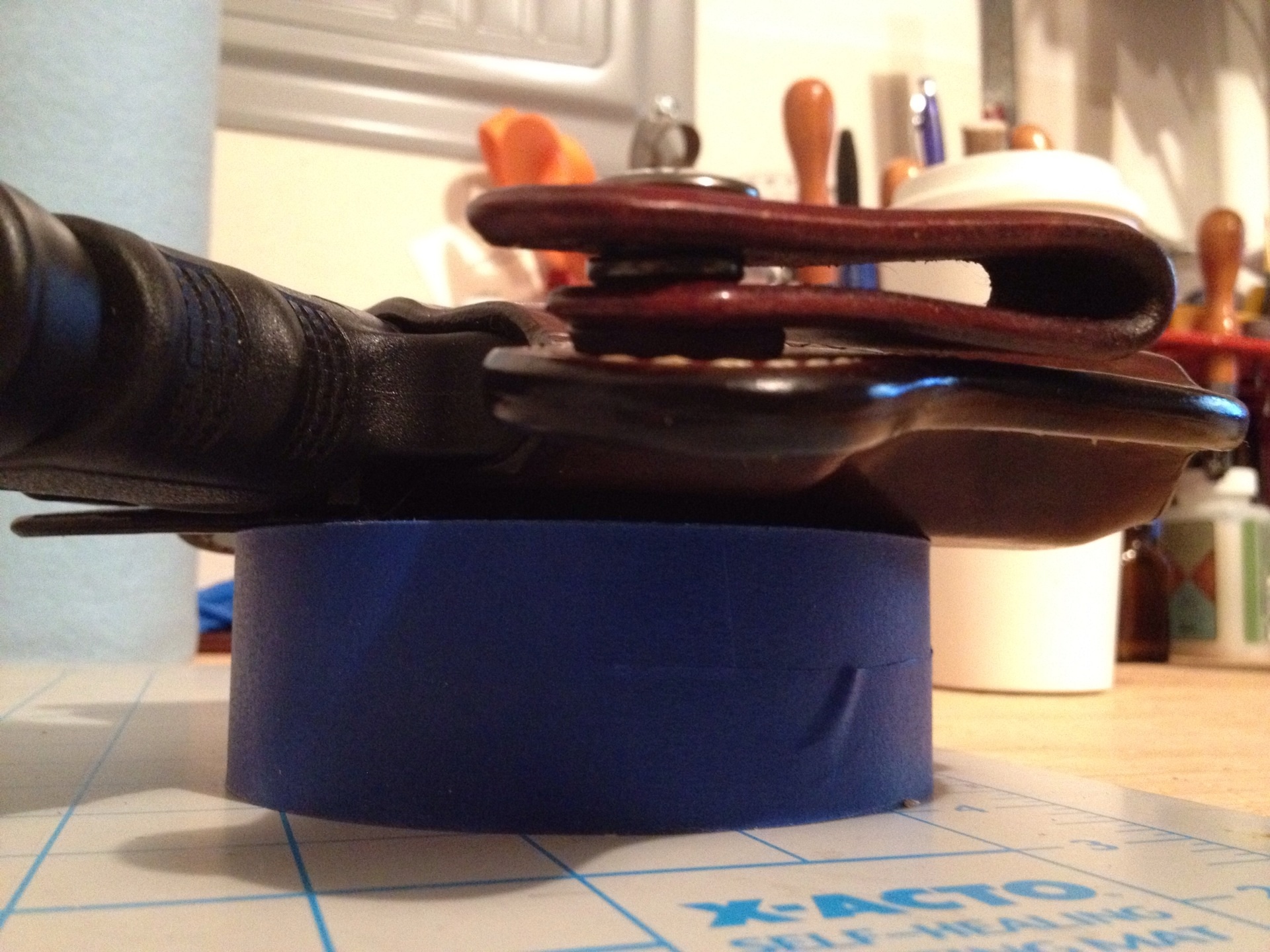

  10. I gave it that cant for concealability and it does conceal great. The butt of the gun is driven into the love handle, basically disappearing. For me though it is a bit uncomfortable on the hip.

  12. Thanks Colt. I am really happy with the edges myself, but I didn't use the Parks method, I wish I had:( I used a plastic slicker, then some antler boning tool I have, then dyed it. After it had dried I burnished it with a dremel tool w/felt wheel and beeswax, I didn't like the results so later I burnished it w/dremel and gum trag. After all that it looked pretty nice but I had to dye the edge again. Finally when I was finishing the holster I put extra coats of rosolene on the edge. So the whole process was kind of a cluster, but happily the result was good. I have decided that the cant of the holster is to extreme.
