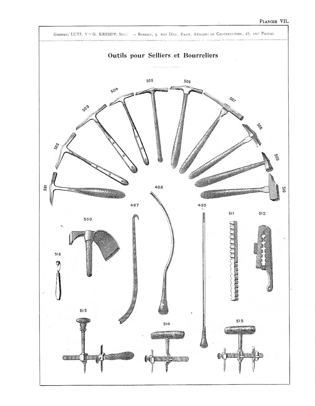

  12. Hi Tor This is quite simple, it is a "thread cage" in French .... "Dividoir a fiscelle" They laid the cord or thread roll into it tightened down through the hole and hung the whole of the workshop ceiling. Whenever they needed a piece of thread they simply left out, so there were no knots or something ...... (((-: they used these parts not only for saddlers, they also pack cord was handy. When you consider what such a casting cost ....... ((-: The model looks like dfas Blanchard, I did, but it differs from the type of 86 Osborne and Dixon on the model, but is otherwise very similar.However, the large model with the pull lever, which is a model fpr belt manufacturer, so for the big belt on the machine earlier. Therefore it was particularly important that the tightening was very accurate, otherwise the belt was not calm and even jumped off the drive wheel of the machine. Leg Saddlers you found the model rarely, because the big companies had always hired a propellant Maschine-Strap-Sattler, and the saddler has these splitter. Rose Knives............ As for the Half-Moon Knife, I used up to now none of Rose, Osborne, etc. Gomph Here are the little known in Europe, and they are much too small. If Bruce once has a 7 inch, I'll buy it. II use the knife liked when they have 8-9 inches, including they are small for me ......... I have Half-Moon with 12 Inches......((((((-: But I have no doubt that there was in the U.S. toolmaker, or .... still, make good knives. I find the wide French edger of Gomph indeed better than anything made ​​Blanchard. Very handy, fine and good to grind. Greeting Walter
  13. Hi Tor and hallo Bruce I have emailed you the files by "Lutz Kremp" and "Blanchard". And here again the link to some good pictures. I hope it works with the large attachments. https://sites.google.com/site/ifojoss/outils-bourrelier-sellier/galerie-1 Walter
  14. Hi Tor .......... Well, the stories of Tor with the hammer I have ever read as a child, along with Connan the Barbarian ..... ((((-: .... and Prince Ironheart ....................... Norway is an unknown country for Swiss Sattler, like they had a unique culture in the harnesses for work. So I gladly give you the PDF, send me your email address. The price lists are also included. This type of H, the so-called Saddle-Maker-Hammer, which I also have some with wooden handle, horn handle and there were also those with bone handles, with the bones I saw only once in an auction catalog. It is quite possible, that was the one knife making as a repair like this. In Blanchard, there were also workers, after they have retired, still continued to work privately at home. I have such a tool with the Brand ......."Portrait of Paris,"....... has made super fine tools, but it is very rare to find. that was the Worker from Blanchard, told me an old Saddler from France. Here's what to look at. https://sites.google.com/site/ifojoss/outils-bourrelier-sellier/galerie-1 You can buy anything from him that all things are sold. In addition, the prices had ..... Wow. Then there was the even of the most beautiful things ever made, the company "Strolz Paris" had only very fine ebony handles with inlaid shield made ........nickel silver........... or as the French say, ............."Argentan".............. Blanchard was indeed famous, but by far not the best. Even in Switzerland there was a tool making, the ......."Niggli Aarburg"............ has worked very clean. Then the best knives from the company .............."Backaus"............. a Knivemaker in Bern. They were better than that of Blanchard. Backaus made the Half Moon Knife for the Swiss Army Sattler. So now I've visited. Yes here is the second of August, yesterday was National Day with us. Greeting Walter
  15. Hello together. I have a whole Blanchard catalog as a PDF and as photos. Even a different dealer of these tools, also from paris, who had wei this same tools but so good. If this interests you, please is it tells me I can set the images here. Here are a few sample photos. Walter

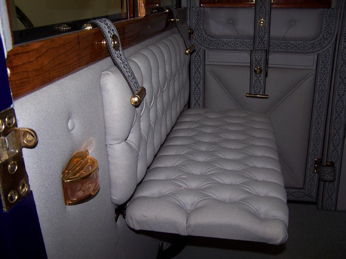

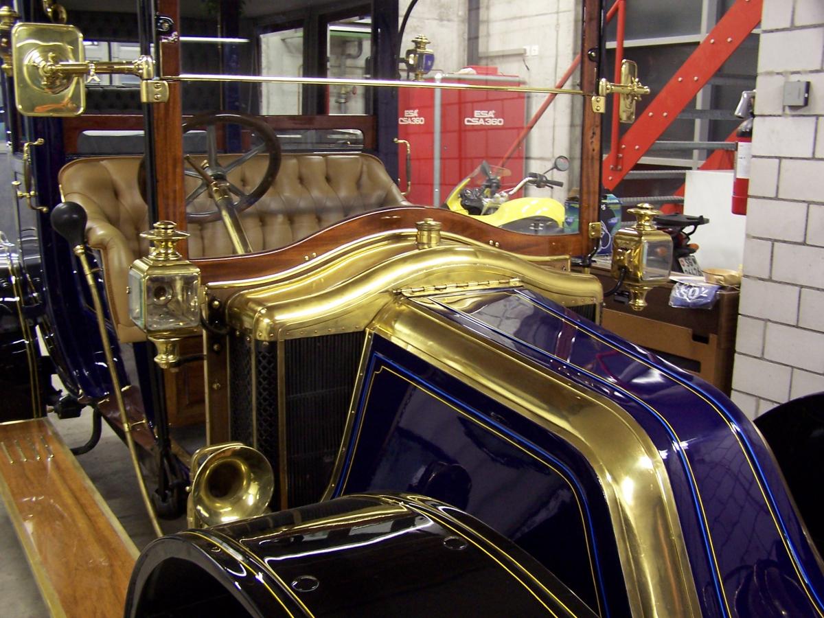

  20. Hi there. Here are some of the few pictures I've taken with the Digitalkammera. It is a Renault from 1911 was built at the Swiss company Saurer Arbon truck. That is, only 1911 Renault supplied the frame the frame and underbody of the car including the engine. Everything else was made in custom. The calculation of the time is still there, it was 13 `000 francs. At that time, the sufficient to build a large mansion. The HOlzaubau was re-made, the engine and everything else obsolete, newly painted Polished etc. The son wanted to get married, owner of the saddlery and always the letzteb craftsmen in such a work, I've spent the last Borden used as approximately 100 wedding guests were waiting. that was the best advertising I have ever had, because these people enjoyed the aperitif, and amused themselves very gutm because something they had never seen before. A Car-Sattler life to work. The borders for the car, I left extra-weave, the brass parts on the car doors I made also new to. The Ortiginale were made ​​of ivory, but since there is a trade ban for it, I took brass, in contrast to the silver mine was little. The material is a heavy Woolen of about 650 grams per square meter. A so-called "Paspoil", swisslangwich, a Cavalry-cCoth, as you previously used this material for Uniforms. The Leather of the Drivers-Bench is here color not good, I have photographed the Car in the Collection and in the Evening. So I hope it makes you much pleasure. Walter Roth
