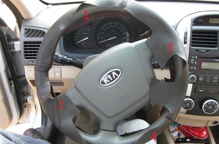

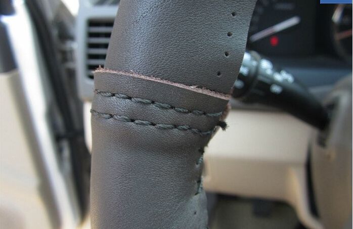

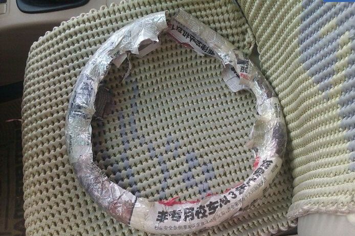

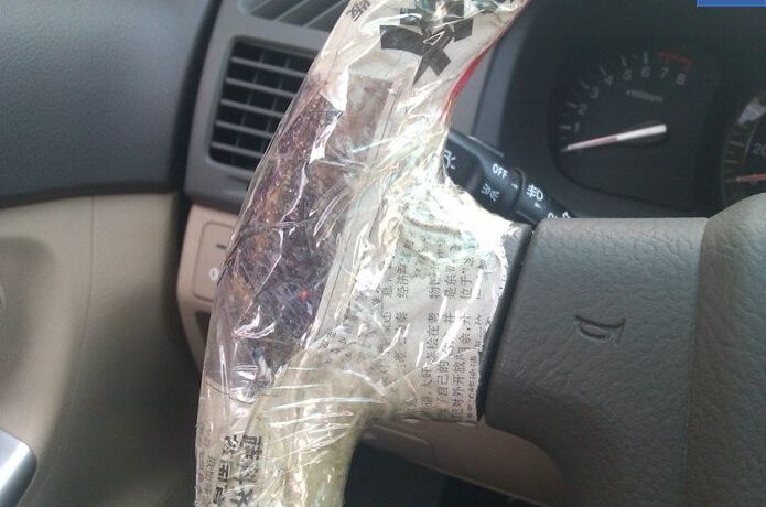

I am a professional leather pattern designer. Different steering wheels have different pattern, you can't follow its update steps. Let me show you a kind of special way to get the pattern from your steering wheel with old newspaper and scotch tape, this kind of way is used by shoe smiths a lot. Do notice: you must wrap the tape firmly Steps: 1, wrap the tape and newspaper on your steering wheels firmly, the more the better, a thick pattern is easy to be tracked by pen. 2, cut off it, along the inner side. 3, track it on thick paper or kraft. 4, you can try to punch some small holes with your chisel or awl. 4, sew your sleeve. Nothing is easier than that This way is suitable for all kinds of steering wheels.

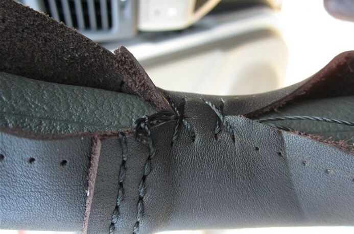

One of my guest change the construction a little and send me a tutorial, let me share you here Look at the pictures in the attachment, I named them as aaa bbb ccc ddd eee fff ggg hhh ggg, so you can follow the alphabet order as the steps.

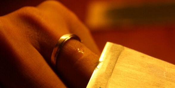

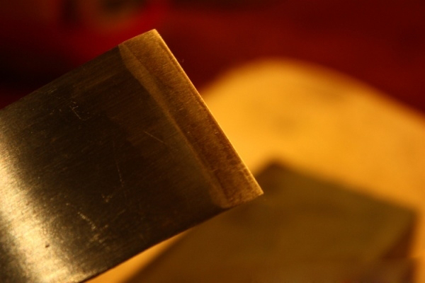

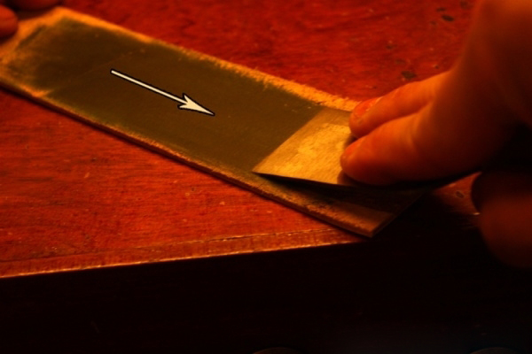

Step 3: this is a trouble step, use 1500# stone to repair the curled part, also polish the blade. Draw only from the top to then end 5 times, and then turn back draw ONLY 1 time. Do it looooots of times, until you can't see the curl part. Do take care: You must only Draw not grind it back and forward, it is very important. And do remember 5 times for the oblique side and 1 time for the straight side. Step 4: After step 3, your knife will be very sharp, but it is not shining, want it shining right? Go on. Paint grinding paste on the flesh side of a piece of leather, and then repeat Step 3---- 5 times for oblique side and 1 time for straight side, do it sometimes as your wish.

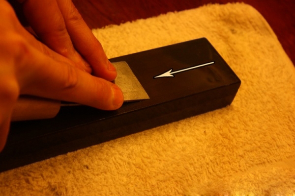

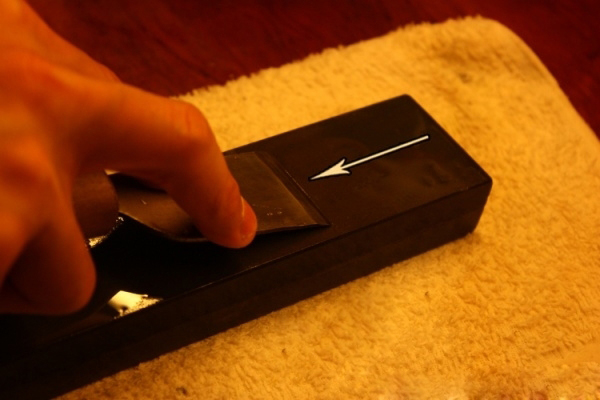

Step 2: Make sure the blade attach the 1000# knife stone firmly and grind it back and forward, make sure your hand won't shake during this time, grind it about 50 times, you will see the blade curl to the opposite side.
Lots of people asked me how to sharp the cutting knife, let me show you a simple tutorial, I think it will be helpful. Keep your knife sharp any time, that will give you a good mood. Step1: Prepare two sknife stone, one is 1000# and the other one is 1500# or higher, Put the stone into basin full of water, dip them 5 mins.
