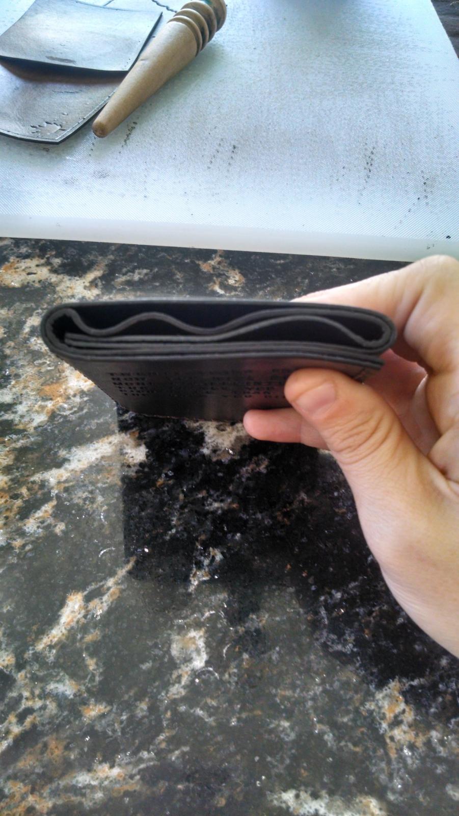

Hello everyone! I just made my first trifold wallet and it turned out really good, except that because the 2 pieces of leather are exactly the same length it causes rippling when it's folded. I'm wondering if I use a thinner leather if that would prevent it from rippling? Or at least not do it as bad? I use a 3-4 oz so I was thinking I'd go to a 2-3oz. I appreciate any thoughts or suggestions!

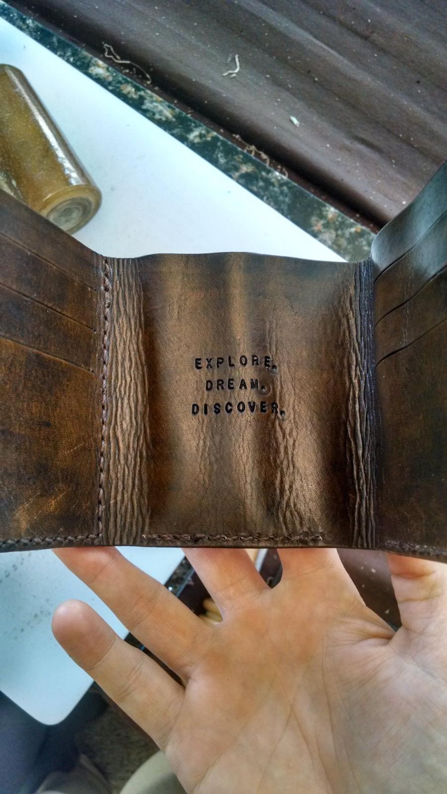

Thank you all so much! That really helped me out. I definitely wasn't getting the leather wet enough. I tried it again and got much better results, but still need to practice I think It's hard to tell in the picture but I think I was hitting a little too hard on the one on the left, the letters looked a little smashed and mushy, but overall much better than my original attempt! Thanks again - I really appreciate all your input! I'll definitely check out the acrylic paints because I want to have fun colors
Hey Chief! Here's a picture for you. It actually looks a little better in the photo than it does in real life... haha I just feel like the lettering is not near as crisp and sharp as when I stamp then dye things. It's 3-4 oz veg tanned leather from Tandy and I don't have any problems when I use it for stamping and dying so I'm not sure what the deal is. Maybe I'm using too much water (like you suggested - not casing properly). I will try spraying with water and then letting it dry a bit longer before stamping. I use the Atomic Beeswax sealant, not sure if that matters. From the picture can you see what I may have done wrong? While I've got you, would you mind giving your input on something else? I've only used gel antiques up to this point and I've loved them, but they only have tan/brown colors and I want to start using really vibrant colors like run, green, etc. When I stamped my name into leather and used Eco Flo Professional Waterstain (red color) and it just didn't stick in the lettering at all. When I put the sealant on the dye that was in the lettering wiped right out with it so the lettering didn't stand out at all. Do you know of any vibrantly colored gel antiques or any other dyes that are colorful and work with stamping letters? Thanks so much for your help!

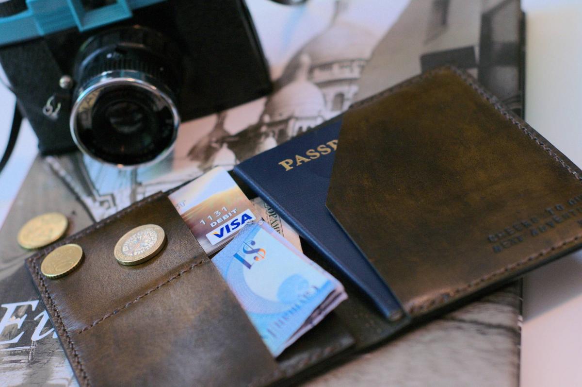

Hey everybody! I've been making leather products since February and really want to start branching out a bit. I love thin wallets and want to start making wallets with more pockets. Up to this point I've only been making wallets with 2-3 pockets because any more than that makes the wallet too bulky. I've seen a few wallets that Nigel Armitage makes where he uses leather that's 1-2 mil (is what he says, I'm assuming that oz) and they look SO nice I want to start making them. The problem is I worry if that is too thin for me to stamp on? Will it just go through the leather? Also, he said something about tooling on leather that he bought pre-dyed, is that possible?? I always assumed you couldn't tool on something unless it was undyed... I've been using 3-4 oz Craftsmen Oak Tooling Leather if that helps I attached a wallet I just did the other day so you can see what kind of stamping I do. Thank you for your help!

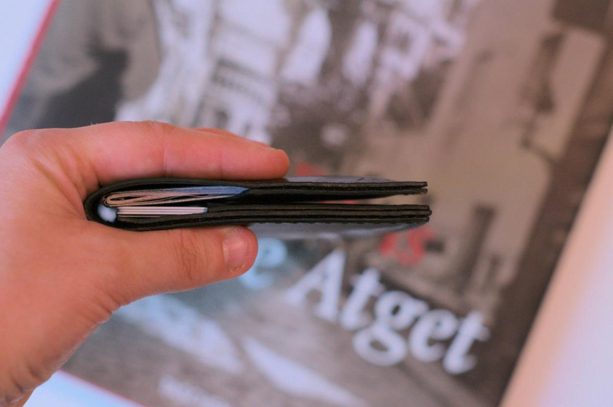

Hey everybody! I've been making leather products since February and have mostly done really simple, basic things but wanted to see what you all thought and if you had any suggestions/ideas on how I can improve. I feel like my edges could be more smooth but am not sure how to best do this as my leather is too thin (I use 3-4 oz) to really use an edge beveler.... Thanks
