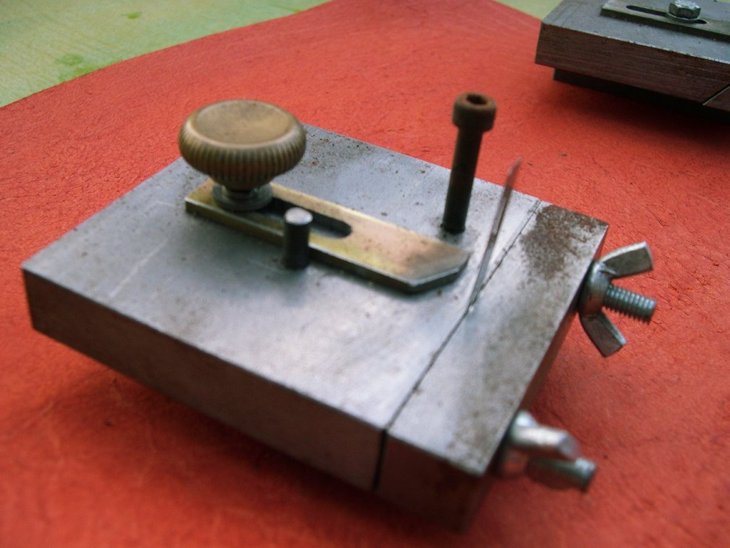

  3. I just cut my lace with a Aussie Strander then I have these little jigs made up of scrap steel one I use to resize and taper the stretched lace the other to bevel it....I posted the pictures big so people can see to copy them if they wish Tony
