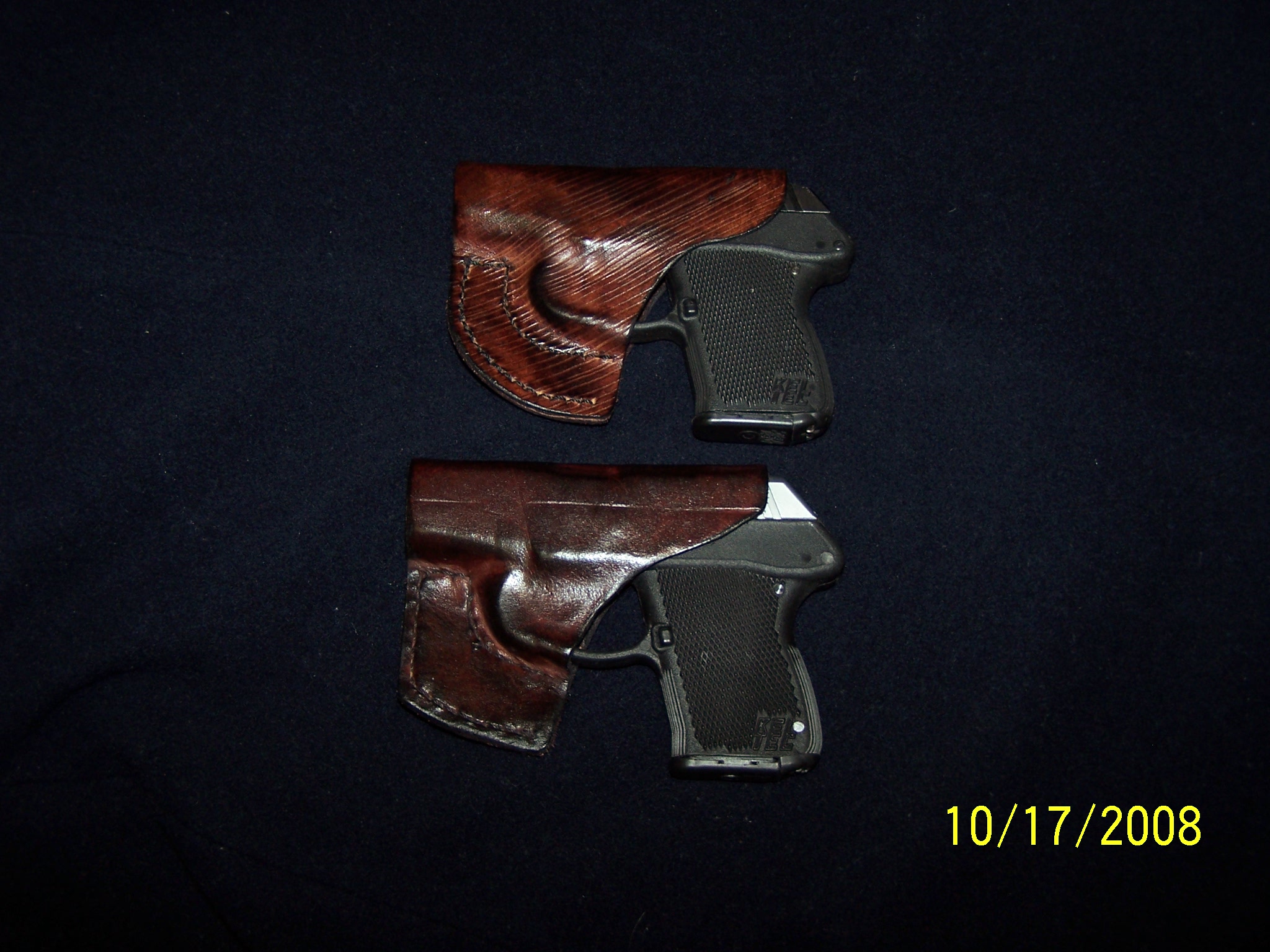

not to try to pad my post count ( )- but the guy who I did the striped holsters for just emailed me a picture of the two holsters together...... IMO the first (the CW45) holster is by far better looking than the second (P3AT) holster..... I think it was wetter when I tried "striping" it, plus I have a lot more stripes per inch Note - the stripes on the two holsters are (or were intended to be) at the same angle - if the pocket holster is oriented with the gun vertical and the pancake holster is worn on a belt...... the pancake has a fairly steep rake

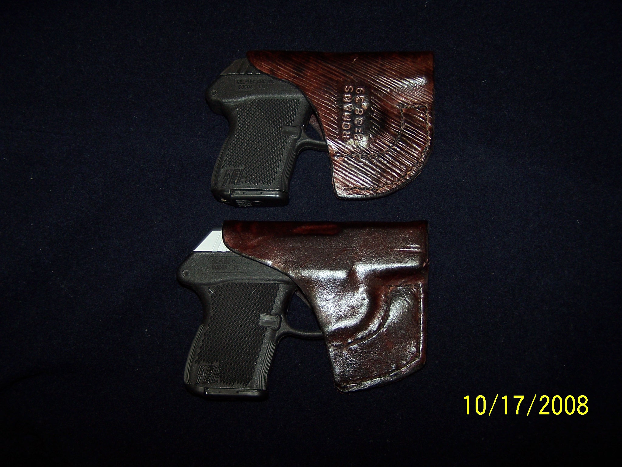

My first post - have been a lurker for a while. Followed RandyC over to here from Glocktalk after he posted a pic of his PM45 holsters in the kahr club (actually googled his user name). At any rate - here are my most recent holsters (#9 for the black 1st gen and #10 for the hard chromed 2nd gen) - I got everything from Tandy, 7 - 8 ounce shoulder, punch holes with awl, tandy thread, wet mold then dye (mahogony), super shene, etc..... The diagonal stripes on the holster for the black P3AT are a long story and go back to a previous holster I made for the same guy - my #7 holster was a RH pancake for a CW45 (for a coworker) and I tried to put a stripe along the slide / frame contour & screwed it up, so I ended up putting pinstripes across the entire thing (basically making passes pulling a screw driver along a metal ruler across the surface).... long story short coworker wanted me to do the same thing on his P3AT holster.... I think it looks pretty cool myself..... These pocket holsters might have a tiny bit too much retention of the gun but if you have hand in the pocket / on the gun (and sweep gun towards the back of the pocket opening when you pull it) the draw is maybe good enough & the holster stays in the pocket. I was going to make the #9 pocket holster rough out but my coworker wanted it smooth out & it seemed to work just fine..... I was sufficiently impressed with smooth out that I did #10 the same way. Also - on #9 I stamped my coworkers favorite Bible passage on it (and had trouble lining up the letters). At any rate - all suggestions / criticisms are appreciated.....
