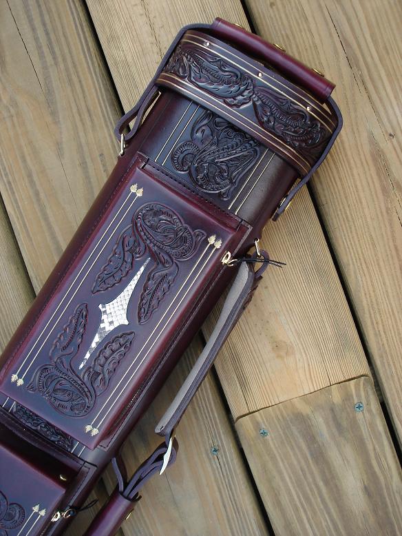

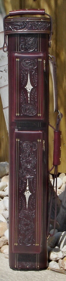

  4. Here are a couple more pics of the Sheridan style tooled cases.
  5. Thanks a lot everyone for the kind words. The cases are built around a solid PVC tube with sewn in liners to separate the butts from the shaft. I make 3 models (1 butt 2 shafts), (2 butt 4 shafts), and (3 butt 6 shafts). The amount of time to make a case is dependent on the options but I can make a standard case without inscriptions in about a day (12 hours). Below are a couple pics of the interior. I look forward to reading the threads and will help out whenever I can.
  6. I though this might be a good place to start....I specialize in custom pool cue cases and though I should show a couple examples of what I make. Comments welcomed.
