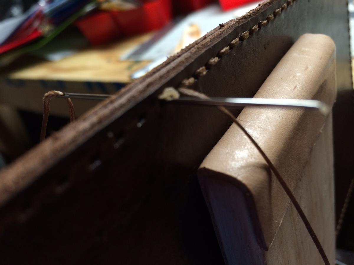

  1. Wasn't sure if I should post here or in Adhesives forum but since it's more a newbie question I went with Getting Started forum. I'm trying to use Tanners Contact Adhesive (was using their water based "elmers" type glue). It's a brand new can and wasn't gloopy or anything so I didn't use any thinner. I followed the directions to use light coat on each side, wait til tacky, put together. It dried over a few days under a book with a weight on top of that. I tried stitching it up and when I pushed the awl thru I got cement residue coming out in little rubber globs. Then the thread went through and picked up more. What did I do wrong? I'm finding Tandy stuff to be less and less satisfactory as I learn more. Should I ditch the Tandy cement and buy Masters or Barge that I see most more advanced workers use? Is it possible I used too much (I don't know how I could have made a lighter coat unless I used a different brush than the one attached to can lid) As a side note did I damage my awl blade?
