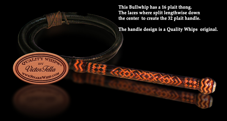

Hi all Just a pic of a whip I made as a donation for the whip enthusiast get together in Dallas. The thong (that's the flexible part of the whip) has 16 laces. The handle has 32. Interesting thing is that they are the same lacea. I split them lengthwise to make the handle. The design is a one off original that I made using photoshop. It's never been done before. All the best Victor www.SnakeWhip.com
