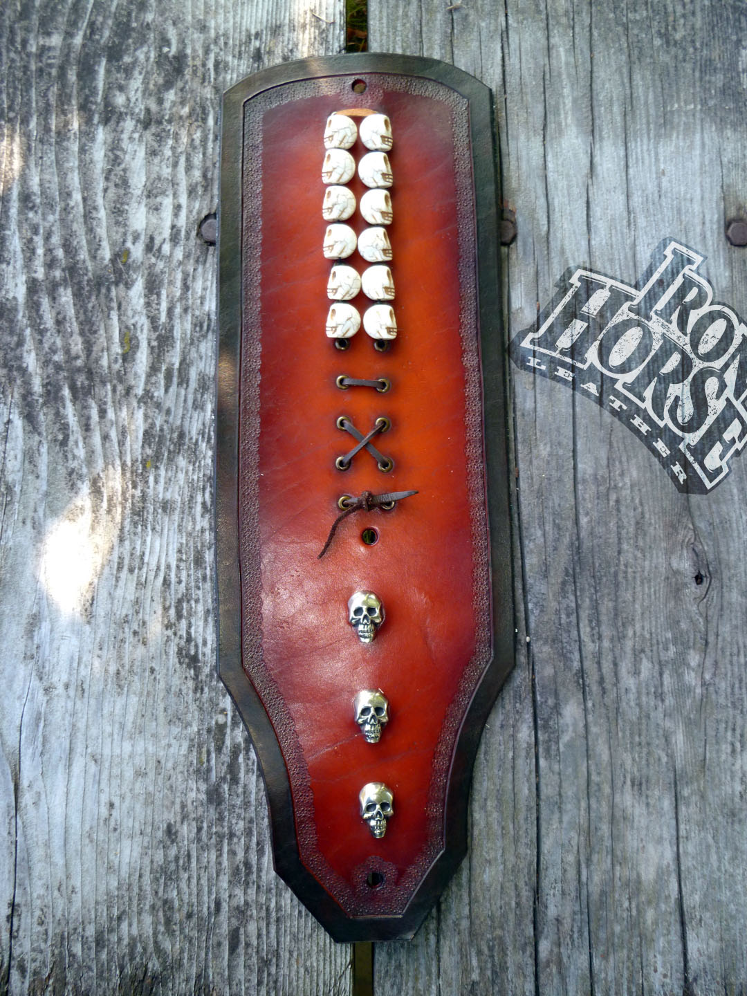

	Won't all fit in one...here's some more... the last one is the seat and fender bib I did for myself (finally) on the bike. Let me know what ya'll think. Gary

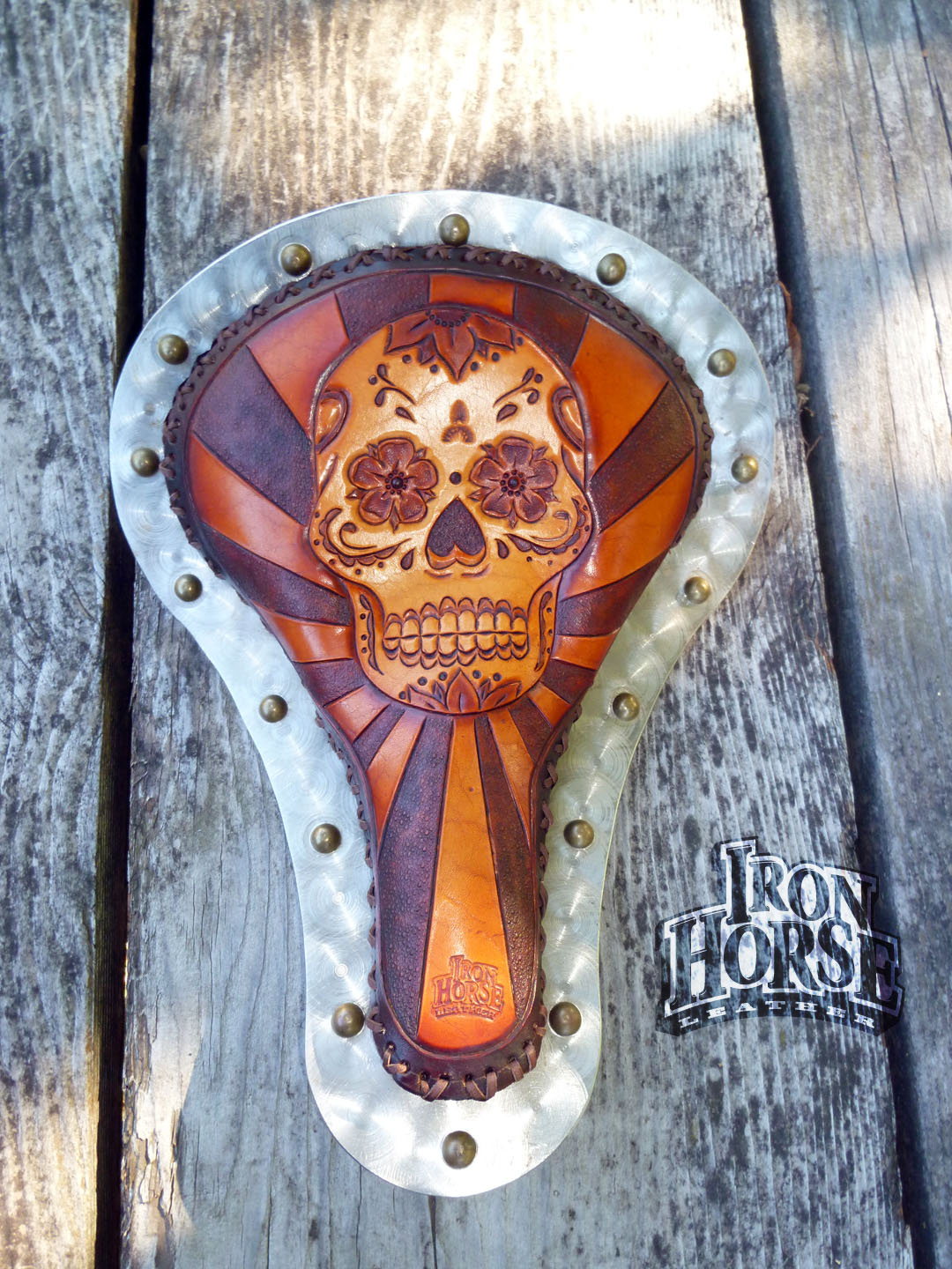

Copied and pasted from one of my other posts... Once I glue the foam to the pan, I make a pattern for the top piece, including hole spacing. If I'm going to use 1/4" lace, then I space the holes 1/4" apart and about the same from the edge. I then cut out a pattern for the bottom of the seat, tack the two patterns together while still on the seat. Mark your holes for the bottom piece from the holes for the top piece...it takes time but this works best for me. -
	Once I glue the foam to the pan, I make a pattern for the top piece, including hole spacing. If I'm going to use 1/4" lace, then I space the holes 1/4" apart and about the same from the edge. I then cut out a pattern for the bottom of the seat, tack the two patterns together while still on the seat. Mark your holes for the bottom piece from the holes for the top piece...it takes time but this works best for me. Hope that helps!

	Here's a look at a seat I did for a Euro/Chop/Rat bike street party in Milwaukee las weekend. Was a lot of fun to do! Cheers! Gary

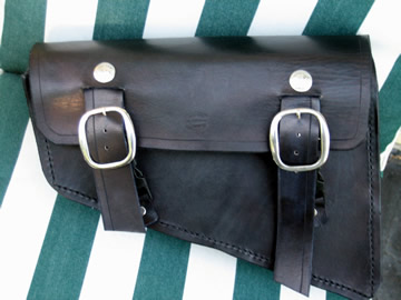

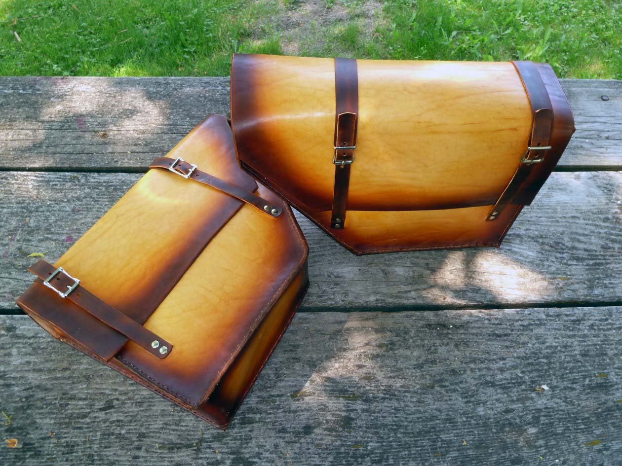

	Thanks. Yeah, it's basically just a day bag for the one side. I have tools, extra pair of shades, and an extra pair of gloves in mine.
	Just finished up a sportster solo bag. It's 4.5 inches deep, works out great if you remove the passenger pegs. Cheers! Gary

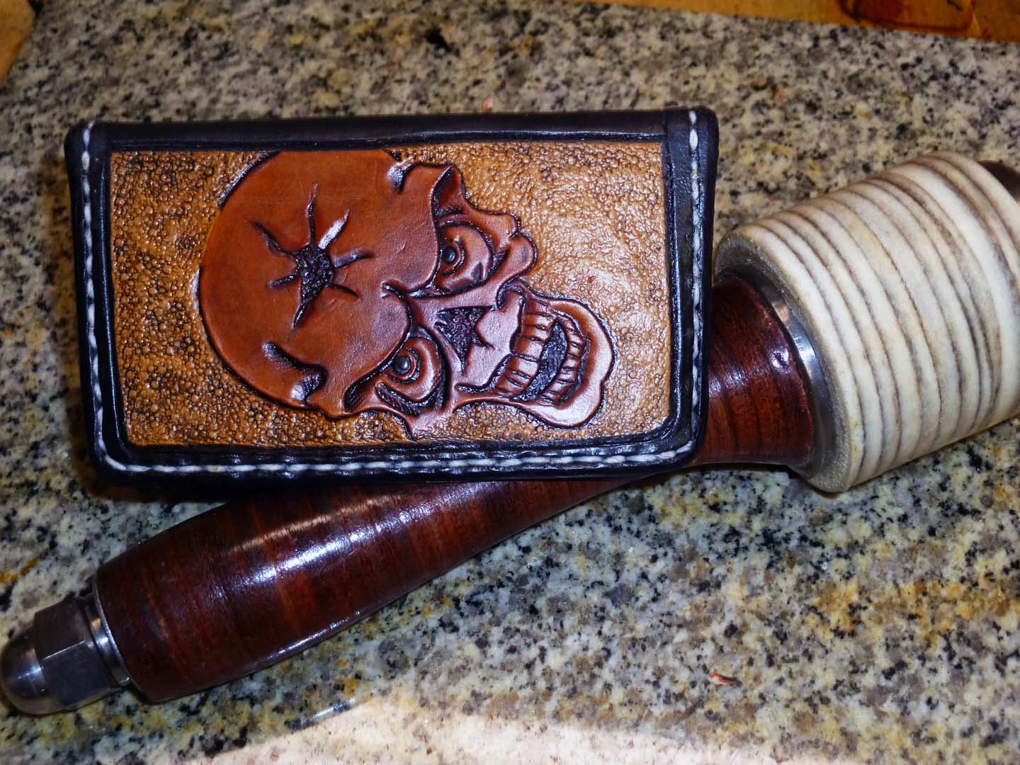

Skull Purse in Progress
HarleyChef replied to HarleyChef's topic in Purses, Wallets, Belts and Miscellaneous Pocket Items
I just realized I never uploaded the finished product...sorry for the delay. I swear, sometimes I'd loose my head if it wasn't attached... -
