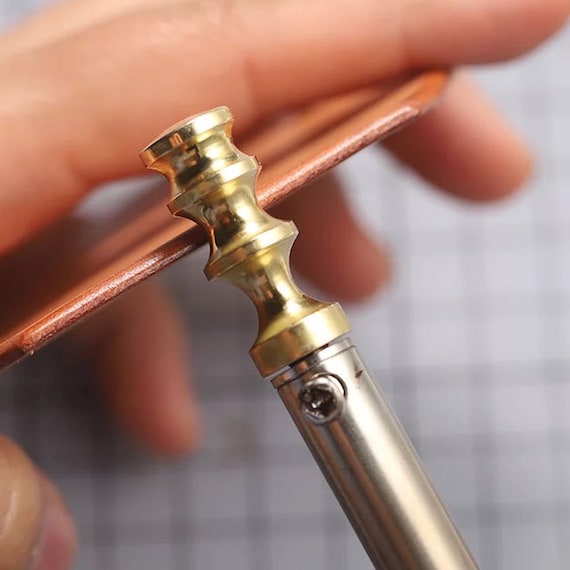

Contributing Member fredk Posted August 4, 2023 Contributing Member Report Posted August 4, 2023 Would not using a pyrogravure* on low heat not be a lot easier and safer? I don't use edge paint much but mostly a beeswax mix. Rubbing that in and buffing it real good with a coarse cloth rubbed hard and fast builds up enough heat to soften the wax and get it into the edge * or an old electric soldering iron on low heat, maybe with a brass burnisher? as seen here Quote Al speling misteaks aer all mi own werk..
Members SUP Posted August 4, 2023 Author Members Report Posted August 4, 2023 (edited) @fredk I do not use edge paint much either but this is soft chrome tanned leather and it just does not get burnished. So I have to paint the edges. I did not think of a pyrography instrument; do such machines have low enough temperatures? I will investigate that. I have just received my soldering iron. I did not have one earlier. Will try to use that too but I did wonder about using the stove. It makes everything so easy and fast and the leather does not have to be firm or medium-soft. Firm or even medium-soft leathers , of course, can be burnished, which I much prefer. That is a beautiful brass burnisher by the way. Is it yours? Edited August 4, 2023 by SUP Quote Learning is a life-long journey.
Contributing Member fredk Posted August 5, 2023 Contributing Member Report Posted August 5, 2023 No, that is not mine, but I have one like it and another of different profile, more square-ish. They are, or were, fairly cheap to buy. Altho I've not used mine for a while since my last soldering iron died With these you don't need any pressure, just a light swipe along the edge A pyrogravure is just a glorified soldering iron. Most good ones have some sort of temperature settings Main point is tho, keep the heat localised to protect your hands. Too much dry heat can dry out your fingers and hands, You'll need to put hand cream on after each session to prevent dry cracks forming on your skin, which can be very painful Something for only those who know what they're doing; when I was a bee keeper I put a resistor into the mains supply feed line of a 40w soldering iron to make it reduce its heat so it would just about melt bees' wax Quote Al speling misteaks aer all mi own werk..
Members SUP Posted August 5, 2023 Author Members Report Posted August 5, 2023 @fredkI'm afraid I am completely ignorant about things electrical, mechanical etc., so cannot modify anything. But the soldering iron I just bought has a lowest temp setting of 80 so hopefully that should work. Besides, it has bad reviews that the temp soon stops going higher than about 90 so it would, hopefully, work for me. Let's see. Until then, the stove and lots of hand cream. I would love to get a brass burnisher like the one above. My search for this evening. Quote Learning is a life-long journey.
Contributing Member fredk Posted August 6, 2023 Contributing Member Report Posted August 6, 2023 15 hours ago, SUP said: I would love to get a brass burnisher like the one above. My search for this evening. They are becoming hard to get I just remembered I got one of mine free. I bought it from China via ebay. I ordered the one with round profiles and they sent a square profiled one. I complained through ebay and the seller apologised, told me to keep the wrong one and they sent me the correct one. I tried to pay for the wrong one but ebay isn't set up to do that. I didn't want to take advantage of the seller. Found these on ebay. a reasonable price. You can use these in a mini-motor tool as well https://www.ebay.co.uk/itm/364008622688?_trkparms=amclksrc%3DITM%26aid%3D1110006%26algo%3DHOMESPLICE.SIM%26ao%3D1%26asc%3D20201210111314%26meid%3Dfad5ee17d88a4ad181cff908186f64e3%26pid%3D101195%26rk%3D4%26rkt%3D12%26sd%3D385165560986%26itm%3D364008622688%26pmt%3D1%26noa%3D0%26pg%3D3458402%26algv%3DSimplAMLv11WebTrimmedV3MskuWithLambda85KnnRecallV1V2V4ItemNrtInQueryAndCassiniVisualRankerAndBertRecallWithVMEV3%26brand%3DUnbranded&_trksid=p3458402.c101195.m1851&amdata=cksum%3A364008622688fad5ee17d88a4ad181cff908186f64e3|enc%3AAQAIAAABUPqB0EgCndAssfMWNy0AT0GytGzF9%2By0G%2BlcW69DgBK3Qlz4BjwJQqPkN4K8I7qz9GoVciN1QNWqyS8EeqYS8rZRsDvyvw34m3N%2FyJKokwCTIIc3RNym2SNW8ARudP72DyiwgIY0dfUnIr5%2BMZDTaovm%2F9i6HbqogXHgrRtlBOXJBpTaj6VaBdDGueRiM2kTHzxVZaNY4y9kDOJFMEzaakQx%2F4NYu00LohEwG8x9DCOSYMhS%2FBQrbdnB6WWKKU1tfGkQW7bnrhnZ5hb0JQ34JDg1V91Cmh8qr1TGWwphIOclAnOdqvKdlYxe6unAQ8BeCUaEimvhqgrmtaM%2BmgXL5in5TYj58%2F7uLCGik9Ckbim5JtD0%2BuJ9hhuvSwgPwjOeSg0GYE8j82MG1o1pTbwbM6uqSkP4OXTLl6GzgCb4eKApLrXBP1rDpe7P6Ynzux5OGA%3D%3D|ampid%3APL_CLK|clp%3A3458402 Quote Al speling misteaks aer all mi own werk..
Members SUP Posted August 6, 2023 Author Members Report Posted August 6, 2023 (edited) @fredk thank you. That is a reasonable price. I found the same on Ebay US and will be ordering it today. You are right about them becoming more difficult to get. Just one or two sellers selling the brass ones; the rest sell the wooden ones. Same on Amazon. Edited August 6, 2023 by SUP Quote Learning is a life-long journey.
