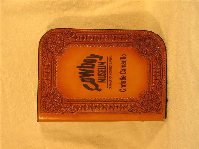

Moderator bruce johnson Posted November 21, 2007 Moderator Report Posted November 21, 2007 Randy, I have done exactly one, so am no expert. I talked with a guy who has a family-run store beforehand. They were sourcing out the the glass engraving and leather lasering. He just got one, but knew the nuts and bolts of it. Basically laser on unoiled leather, the oil will bring out the darkening even more. I have attached a planner I did. It was a bit scarey, because I did the tooling first, and then took it over to her. I was dang sure hoping she had it set up so the engraving would come out centered, it did. I wasn't relishing the idea of doing it over. It turned out pretty well. Quote Bruce Johnson Malachi 4:2 "the windshield's bigger than the mirror, somewhere west of Laramie" - Dave Stamey Vintage Refurbished And Selected New Leather Tools For Sale - www.brucejohnsonleather.com

Moderator bruce johnson Posted November 21, 2007 Moderator Report Posted November 21, 2007 Randy, In a nutshell, I wouldn't. I don't think it would hold up to use and abrasion very well. You have to have some bevel around to hold up I think. One thing I have considered is lasering in a pattern or logo, and then using that as a base for beveling and dyeing, much more accurate than a tracing and stylus. You could even just laser in the tooling pattern outline, and use that as a guide for swivel knifing. For several items the same, It would save stylus and tracing time for sure. I sure see some possibilities with lasers. Quote Bruce Johnson Malachi 4:2 "the windshield's bigger than the mirror, somewhere west of Laramie" - Dave Stamey Vintage Refurbished And Selected New Leather Tools For Sale - www.brucejohnsonleather.com
