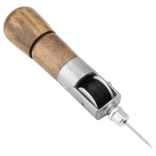

Members Aventurine Posted July 12, 2024 Members Report Posted July 12, 2024 Does anyone use this set of awls? The ad doesn't say what exactly the measurements are. https://www.amazon.com/gp/product/B07L3ZY9M2/ Quote
Members zuludog Posted July 12, 2024 Members Report Posted July 12, 2024 (edited) OH NO! -- this looks like the 4-in-1 awl that is infamous throughout the leather craft world for being expensive and not very good (that's the polite version!) ..... besides which, in general, tools with interchangeable parts are fiddly, and you'll be constantly swapping & playing about with the blades It is better and cheaper to buy a scratch/round awl and a fixed blade saddlers/diamond awl Traditionally you bought a separate blade and haft then fitted them together yourself, but this is fiddly, try to find something already made up -- I'm sure people in the USA will suggest suppliers and models/types of awls Generally go for a thin blade, <2mm but as I think you might be using thicker leather you could go up to 2,5mm but others will advise, or ask the supplier A diamond awl needs to be super sharp but it does not have a fine needle point, it is more like a small rounded chisel tip, you'll see the idea from videos Whatever you get you'll need to sharpen a new blade, there are YT Videos. FWIW I use mostly 0,6mm thread and Osborne # 42 or 43 awl blade (can't remember which) that I mounted myself in a typically pear shaped haft Edited July 12, 2024 by zuludog Quote
Contributing Member fredk Posted July 12, 2024 Contributing Member Report Posted July 12, 2024 Wot he says but I have two of this type They have their uses. Kept one with me for 'emergency' repairs when I did historical presentations Quote Al speling misteaks aer all mi own werk..
Contributing Member fredk Posted July 12, 2024 Contributing Member Report Posted July 12, 2024 On 7/12/2024 at 9:47 PM, Aventurine said: Does anyone use this set of awls? The ad doesn't say what exactly the measurements are. https://www.amazon.com/gp/product/B07L3ZY9M2/ Expand The pokey hole bits are large. They are more suitable for sail making/repairing Quote Al speling misteaks aer all mi own werk..

Contributing Member Ferg Posted July 12, 2024 Contributing Member Report Posted July 12, 2024 On 7/12/2024 at 9:47 PM, Aventurine said: Does anyone use this set of awls? The ad doesn't say what exactly the measurements are. https://www.amazon.com/gp/product/B07L3ZY9M2/ Expand I have this set of curved awls for shoe stitching on sale for $75. I assure you I paid almost that much for each separate awl. They are made in USA. Quote
