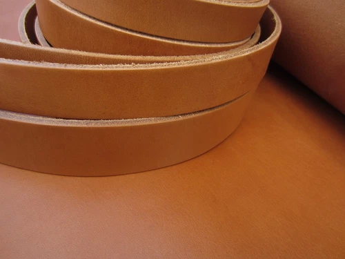

Anyway I have been asked to make some Jeans belts for a shooting colleague at our club,
He is looking for something quite sturdy at 3.5 to 4mm thick and 40 mm wide.
I know its a lazy way but I am thinking of buying some dyed through belt blanks in the correct width /thickness,
and then finishing the edges, punching holes and fitting buckles/keepers
  looking at choices available to me I have oiled tan , buffalo veg tan, italian veg tan or plain simple cowhide veg tan.
could someone please advise??

veg tan
75" EXTRA LONG SADDLE TAN 3.5mm THICK FULL GRAIN COWHIDE LEATHER STRAP ALL WIDTH - Picture 1 of 7
