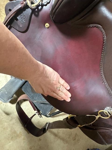

Members KathySemi Posted March 19, 2025 Author Members Report Posted March 19, 2025 On 3/15/2025 at 2:54 PM, Goldshot Ron said: Kathy, It sounds like you removed the oil from the leather by cleaning it the way you discribed. I would recommend using Neetsfoot oil to condition the leather. Start in an obscure area first to see what it does. If you do not have Neetsfoot oil, a virgin olive oil will work also. I am not familiar enough with Lexol products to comment on them; I haven't used Lexol in over 40 years. My basic procedures is to brush off dirt and dust, wash with saddle soap, and when dry, oil with Neetsfoot oil. Once the oil has penetrated the leather and is dry to the touch, buff the saddle with a cotton cloth. Ron Hello Ron Thank you so much for responding to me. I attached a couple of pics for your to look at if you can. I'm just a little worried that i will be adding to the problem by using more oil. thanks you so much for your time and assistance. Kathy Quote
Members Goldshot Ron Posted March 19, 2025 Members Report Posted March 19, 2025 Kathy, Your pictures suggest that it had a factory finish on the saddle, and you washed some of it off. The seat jockeys do not appear to be dry, and the type of leather they used looks like burgandy latigo. Latigo does not shine naturally, but has a dull finish. What I use on latigos and strings is Rudy's Leather conditioner. I use it on saddle seats where you do not want oil wicking into your jeans. Springfield Leather carries this product, which is made in Vancouver, Washington. It is a non-oil product, but it does not shine up. It works to prevent mold and mildew on leather. So, you are correct, I agree that you need to oil the saddle. When I have a really dirty saddle, I will use a formula of water, a few drops of Ivory dish soap, and amonia (enough to keep the amonia smell) to cut the grim and gease. Your saddle would not need this treatment. Good luck, Ron Quote
