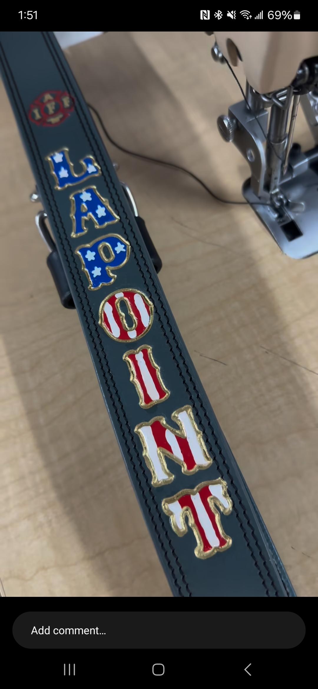

Members rcon1991 Posted yesterday at 12:25 AM Members Report Posted yesterday at 12:25 AM Someone asked me if I can do this color strap but I am unable to find anything close to it. Is anyone here able to help me figure this color out? Quote

Members TonyV Posted yesterday at 03:24 AM Members Report Posted yesterday at 03:24 AM Manufacturers often use custom made colors. You might want to blend your own color to match. That color looks more gray than blue, so I would start with gray and tint with blue to suit. The only gray dyes I've found are in water-based dyes. RIT dye, generally a fabric dye, is a water-based dye that can be used on leather, and they have the widest range of colors that I'm aware of. Quote
