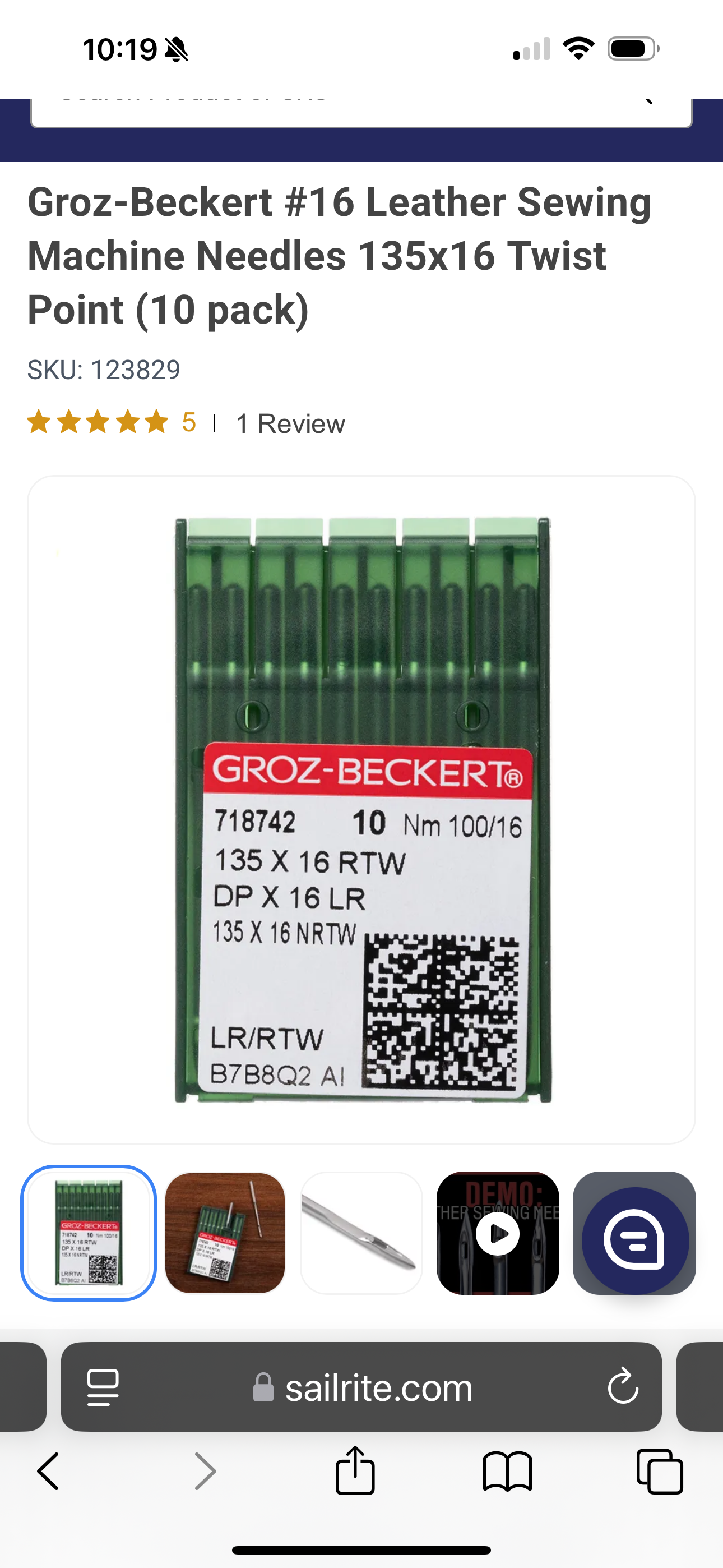

Hey Kgg,
Thank you so much for the info. I remember reading the needle sizes somewhere on the Artisan website and was searching through the manual etc but missed it right in front of me on the first page. Thank you for that.
Now I just need to find the right needle. I am gonna look for 135x16 size #16 leather point, right? Thank you.

1 hour ago, Piko said:
I ve found this at Sailrite.
You also might want to check wawak.com for needles 135x16 x size 16 needles ( https://www.wawak.com/sewing/sewing-needles/industrial-sewing-machine-needles/schmetz-leather-industrial-machine-needles-135x16-tri-dpx16-d-10pack/#sku=smnl135116  ). I would not advise you to use a thread larger then V69 with #16 needle.

I already bought them from Sailrite but thanks for the website, I’ll save it for next time.
