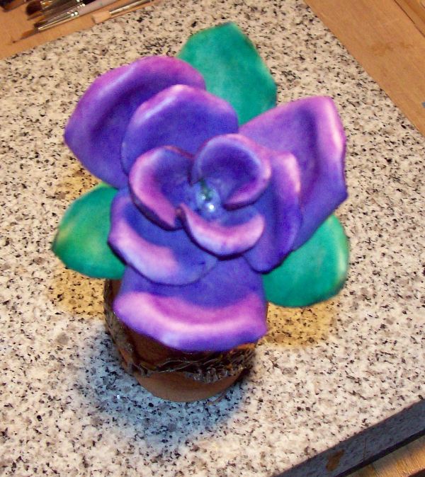

I had posted the first of these along with an offer for the pattern, under the topic of "teaching wetforming" in the youth groups forum. Here is my second - my sister is a nut about purple, so I thought I'd make her one for her birthday. The pics don't do the color justice. It's the new eco flow Thistle Purple and it's very pretty.
This time I wrapped the whole stem/wire in green florist tape and I think it looks nice - 'course that doesn't show in these pics...I'd still like to try these smaller with thinner leather...maybe after I get settled in at the new place!

Very nice Holly. The color looks great, and I bet it looks better in person. Cameras always muck up the colors.
Edited by outcast
Awww, that is sweet, even in fuzzy pictures. I will look up the pattern as that looks fun!

You can also shrink the pattern and make smaller roses - my best friend did them as little pins by riveting the rose straight onto a small piece of leather, then gluing on a pinback.
Here's how I did it:
1. trace and cut each piece. Punch hole in center.
2. dunk a piece in water, remove immediately, shape to desired form.
3. stain.
4. using needle nose pliers, bend the tip of the wire around a bead
5. put the pieces on, smallest (bud) to biggest petal piece. Finish with leaf piece.
6. put another bead up the "stem". Wrap the stem with florist tape to keep everything in place at the top.
7. poke a hole in the bottom of a plastic or paper cup. Stick "stem" down in, allowing flower to rest just inside the top of the cup to dry. You can also use a rubber band around the flower, but ours were so "bloomed" looking, it wouldn't have stayed on. If you formed it more into a bud shape, you could put a band around it. That's what we did in 4H when we'd gotten the leather too soaked to shape very well.
The instructions called for the use of glue, but I don't usually have time in classes to wait for it to dry before moving on.
