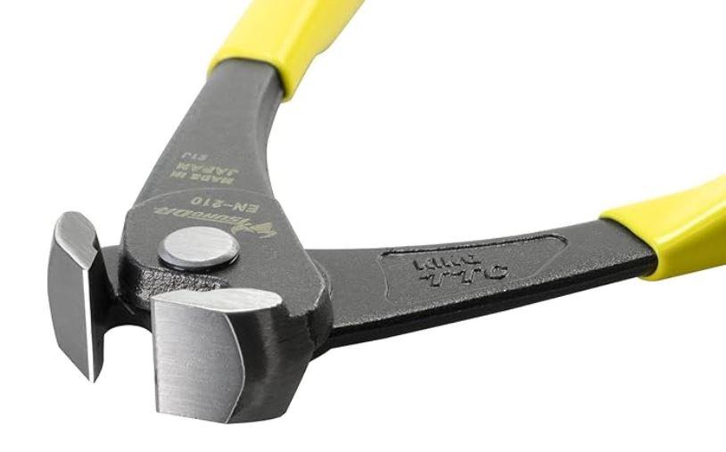

I needed a new set of pliers and came across the Japanese Brand Tsunoda and said for badness will they cut #9 copper rivets. The Tsunoda cable cutter cut through the #9 shanks like a hot knife through butter so I order their 9" Tsunoda EN-210, End Cutting Pliers.

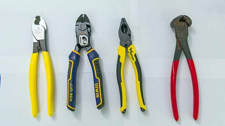

I did a unprofessional test of four styles of 8" cutters that I have on hand.
Here is a photo of how I rated them from best to worst and a photo of what I ordered. The difference between the Irwin "PowerSlot" and the Tsunoda PP-175TG, High-Leverage Linemans Pliers was so ever minor but I had to choose one.
Cost:
Tsunoda cable cutter are about $24 CAD
Irwin "PowerSlot" are about $40 CAD
Tsunoda PP-175TG, High-Leverage Linemans pliers are about $36 CAD
End Cutter (Canadian Tire Special) was about $40 CAD
Tsunoda EN-210 End Cutting Pliers are about $27 CAD
