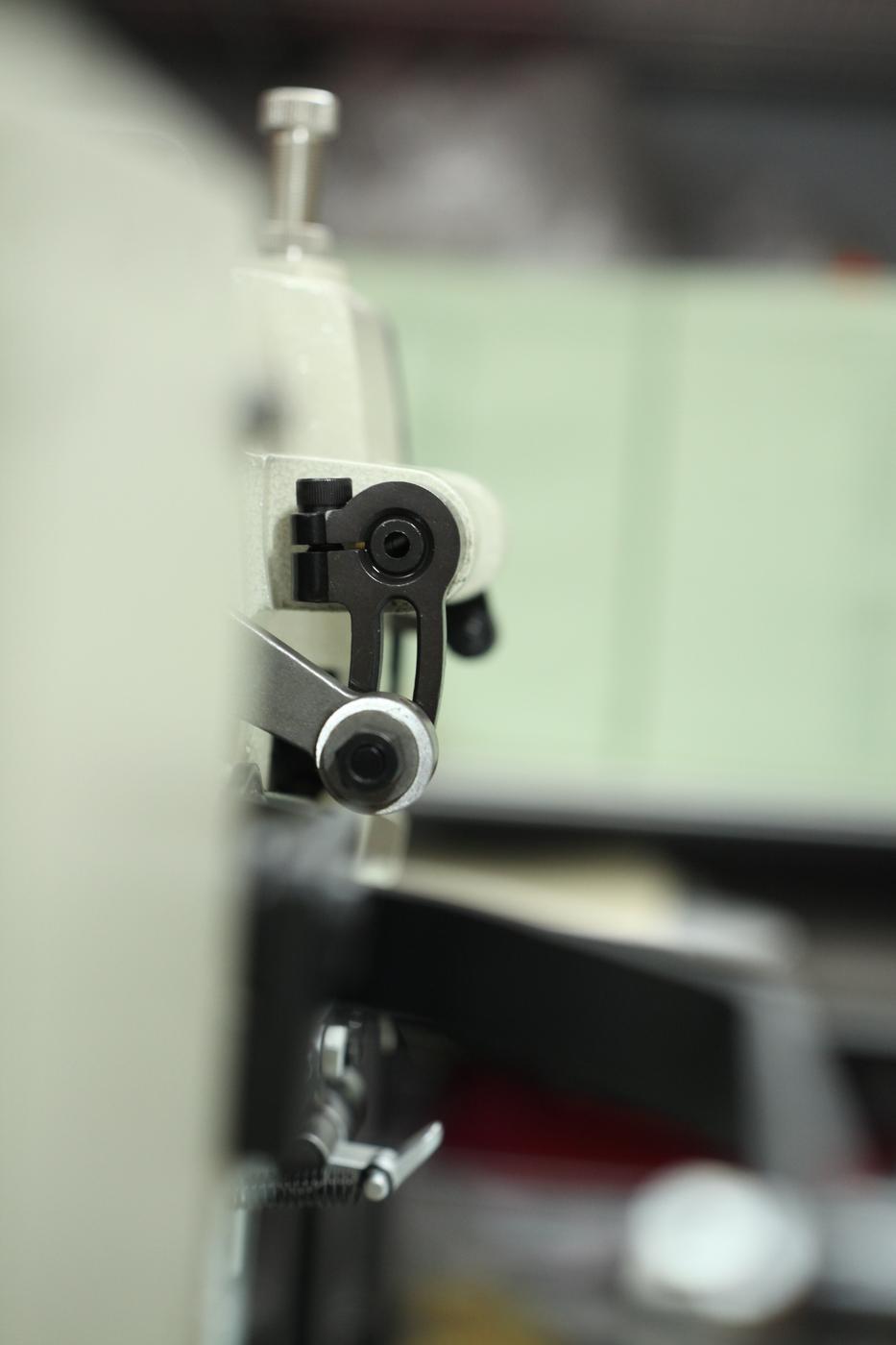

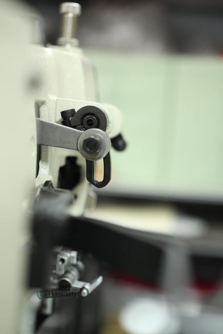

Here are some additional photos and measurements that may show what's going on.
Before taking these photos, I verified that the the top feed cam timing was correct based on pp 15 of the Juki 1341 engineer's manual.
Then I set the needle even with the throat plate, and took these pictures first with the hinge bolt at the bottom of the banana slide, and then with the hinge bolt at to top of the banana slide.
I conjecture that the design length of the top feed cam rod, combined with the radius of the arc in the banana slide are supposed to be such that sliding the hinge bolt from one end of the banana slide to the other does not actually move  the upper feed driving shaft. (Assuming correct top feed cam timing, and assuming both presser feet are against the throat plate.)
But on this machine, it DOES move the upper feed driving shaft. That is, starting at the first photo (both presser feet against the throat plate, and needle at the throat plate, and verified balanced lift height) then sliding the hinge bolt to where is shown in the second photo, the upper feed driving shaft moves away from the main shaft, lifting the vibrating presser off of the throat plate by 5mm.
