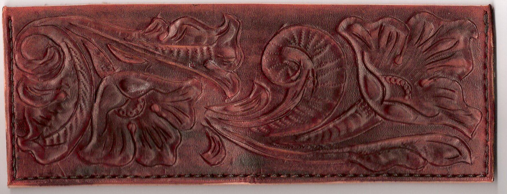

Here's a sample of the stitching after I use the 4 hole punch. Does the stitching look correct? Kate mentioned a loose look when she tried. Does this look loose?
This is just a practice carving peice that I used to practice stitching so I'm not making anything particular.

  • Ambassador
Regis, I know what Kate is referring to when she mentions large holes, etc., since that was my experience with these types of tools. However, your stitches look just fine to my eyes, so if what you're doing is working for you, I say keep on doing it! :)
