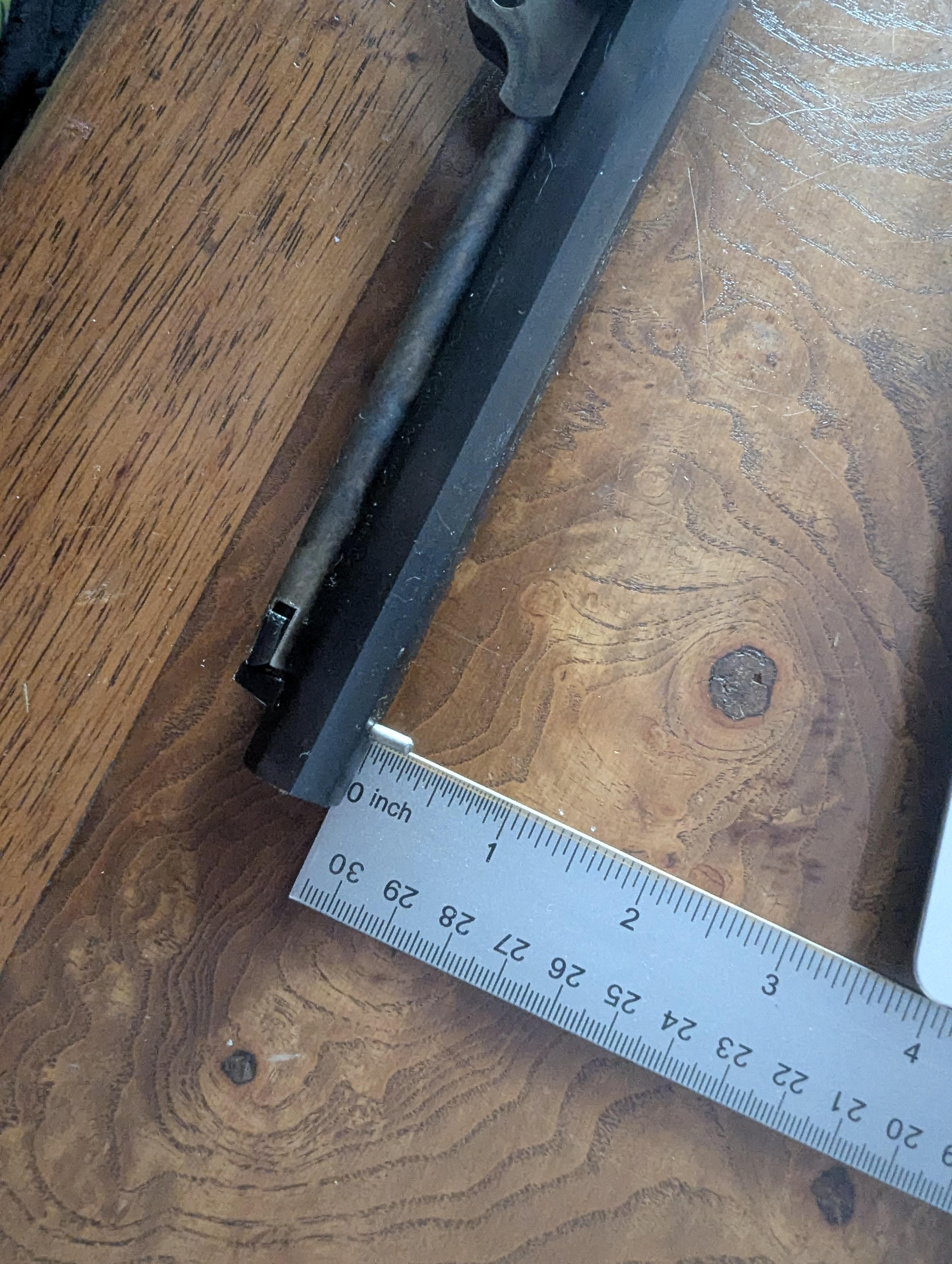

Members aaroncrafts Posted October 16 Members Report Posted October 16 Hey all, I'm hoping to make a holster for my 1851 Navy replica in the next week or so. It has a long front sight, ~1/4". Are there any considerations I need to take in making a holster for this gun, so the sight doesn't get damaged, or caught when I'm drawing the gun? TYIA Aaron Quote

CFM chuck123wapati Posted October 16 CFM Report Posted October 16 2 hours ago, aaroncrafts said: Hey all, I'm hoping to make a holster for my 1851 Navy replica in the next week or so. It has a long front sight, ~1/4". Are there any considerations I need to take in making a holster for this gun, so the sight doesn't get damaged, or caught when I'm drawing the gun? TYIA Aaron use a thin piece of wood or something to tape from the front sight when wet forming your holster to the back sight or your holster will develop a hump, and your front sight will drag on the holster. Post pics Quote Worked in a prison for 30 years if I aint shiny every time I comment its no big deal, I just don't wave pompoms. “I won’t be wronged, I won’t be insulted, and I won’t be laid a hand on. I don’t do these things to other people, and I require the same from them.” THE DUKE!
Members aaroncrafts Posted October 16 Author Members Report Posted October 16 (edited) 1 hour ago, chuck123wapati said: use a thin piece of wood or something to tape from the front sight when wet forming your holster to the back sight or your holster will develop a hump, and your front sight will drag on the holster. Post pics I figured it might be something like that, thank you for your insight! That little extra space wouldn't cause the gun to be too loose after it dries, would it? Edited October 16 by aaroncrafts Quote
CFM chuck123wapati Posted October 17 CFM Report Posted October 17 10 hours ago, aaroncrafts said: I figured it might be something like that, thank you for your insight! That little extra space wouldn't cause the gun to be too loose after it dries, would it? nope, most of the fit comes from the cylinder and the sides. once wet formed and dried it will fit like a glove. Post us some pics !! and have fun with it. Quote Worked in a prison for 30 years if I aint shiny every time I comment its no big deal, I just don't wave pompoms. “I won’t be wronged, I won’t be insulted, and I won’t be laid a hand on. I don’t do these things to other people, and I require the same from them.” THE DUKE!

Members 1961Mike Posted October 25 Members Report Posted October 25 Hi I've HEARD of this being done, but haven't needed to try it yet. You can glue and / or sew a strip of leather, roughly the height of the sight, for the sight to ride up and down the holster when drawing and re-holstering. One strip on each side of the barrel. again, HEARD of it. it would be worth a try though, use scrap leather for the first try. Later Quote
Members AtomicLeather Posted November 25 Members Report Posted November 25 Just be careful if you use tape and it gets on the bluing or gun finish… some adhesives will strip bluing, or cause rust quickly. I buy EVA foam that they use for COSPLAY armor and stuff… for pistols, I use the foam “dowels” and cut a V-shaped channel, then use Saran Wrap and wrap the entire gun to prevent the dowel from shifting and to keep moisture away from the gun while I’m forming since I don’t have a bunch of blue guns. Quote
