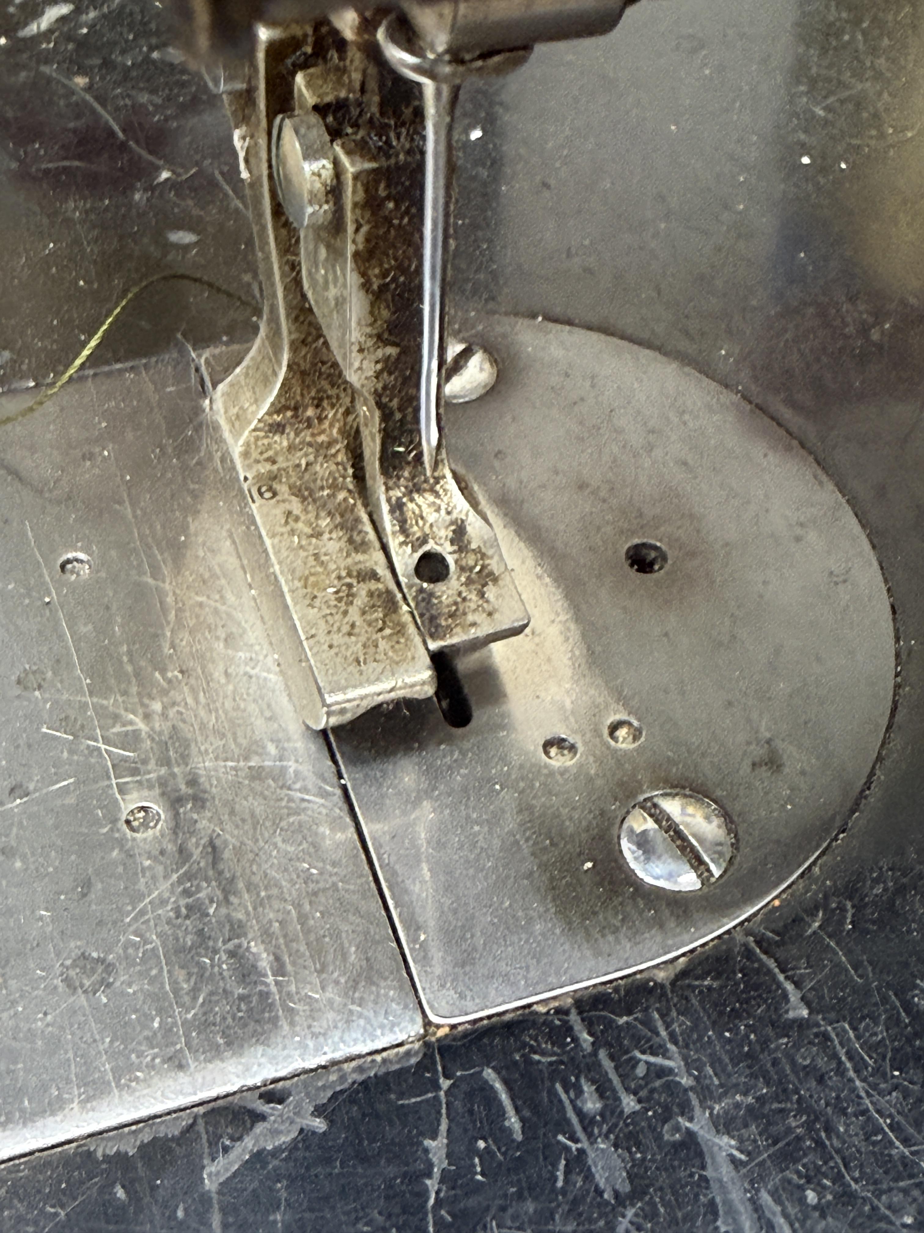

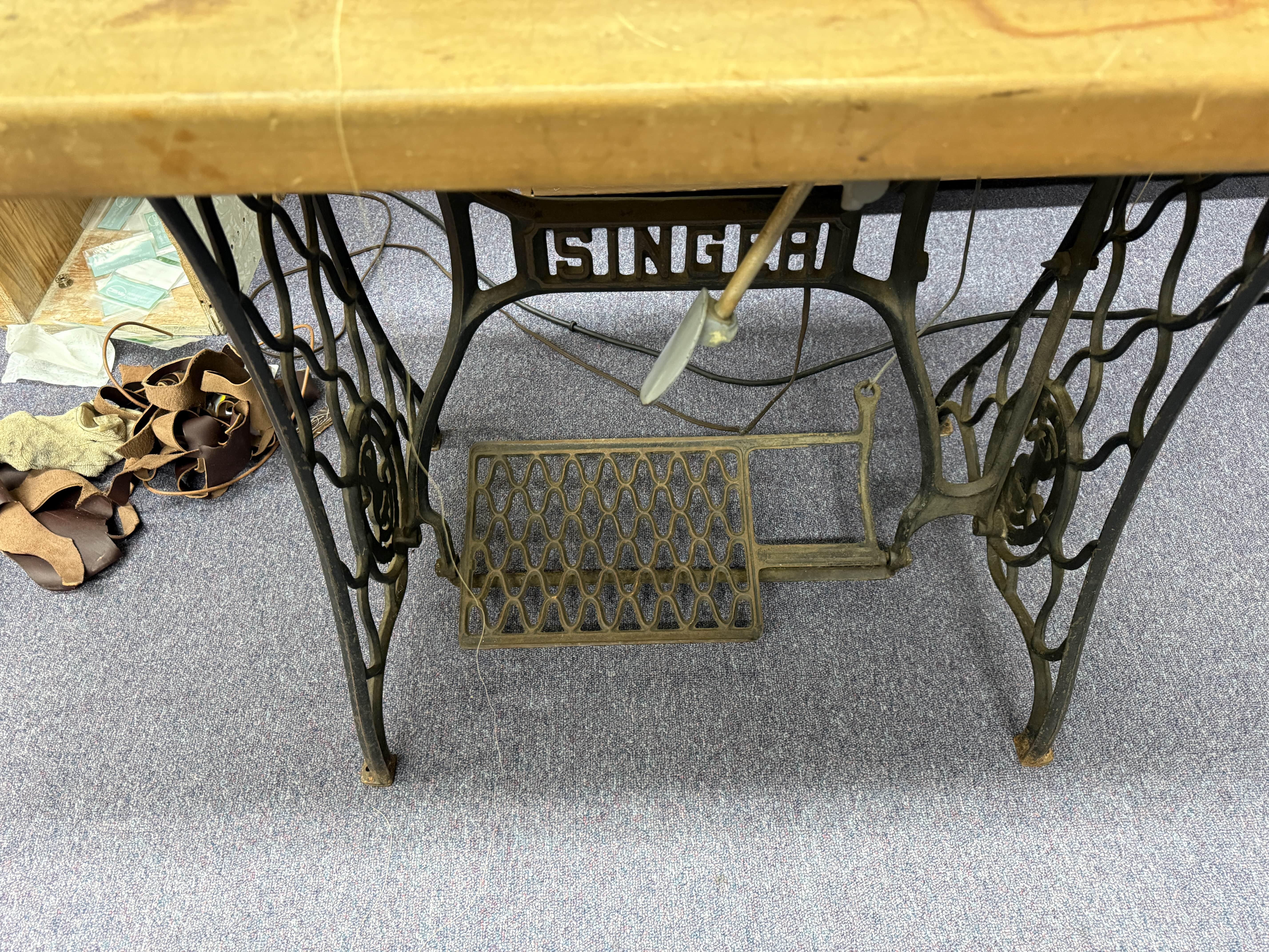

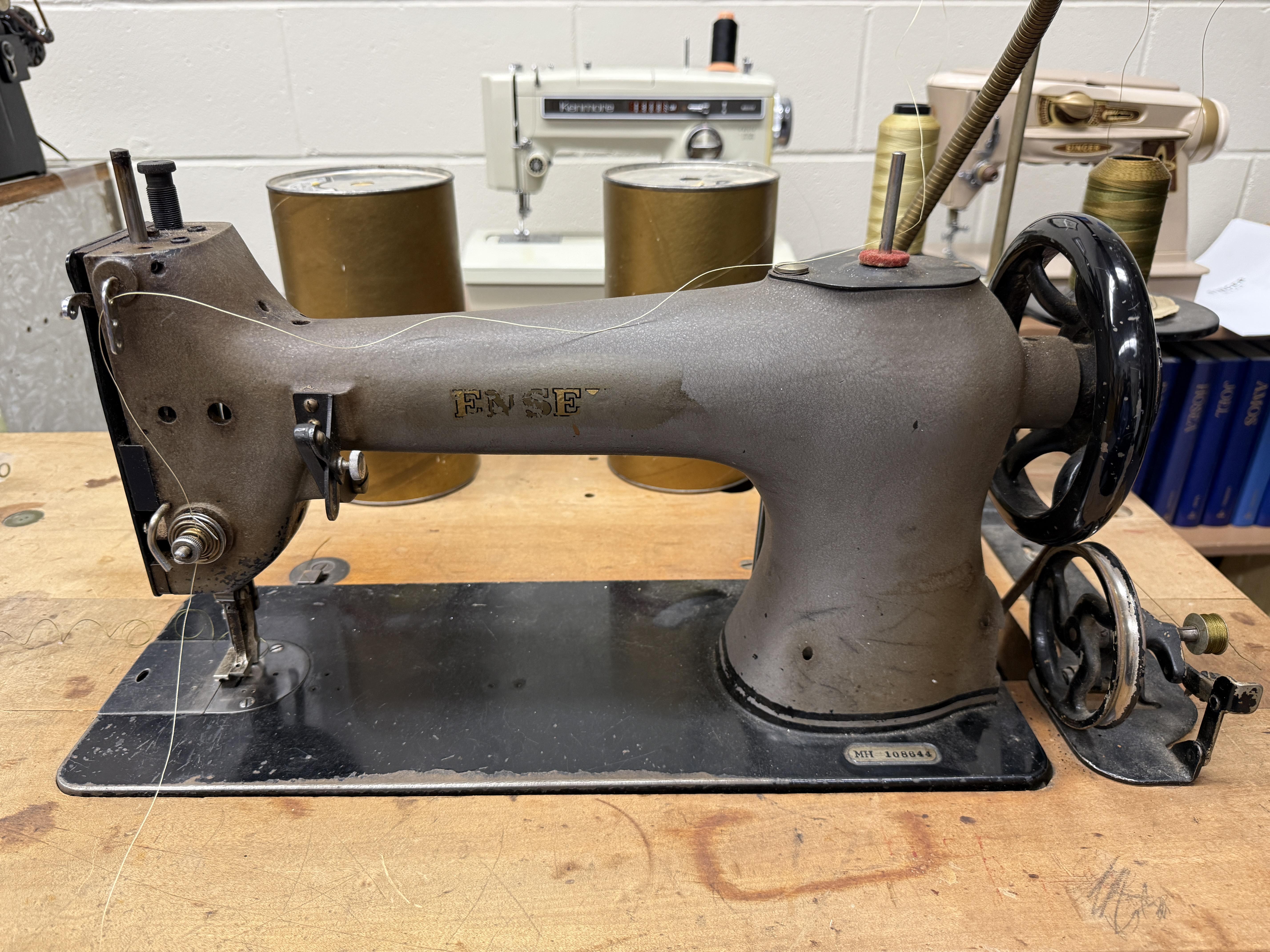

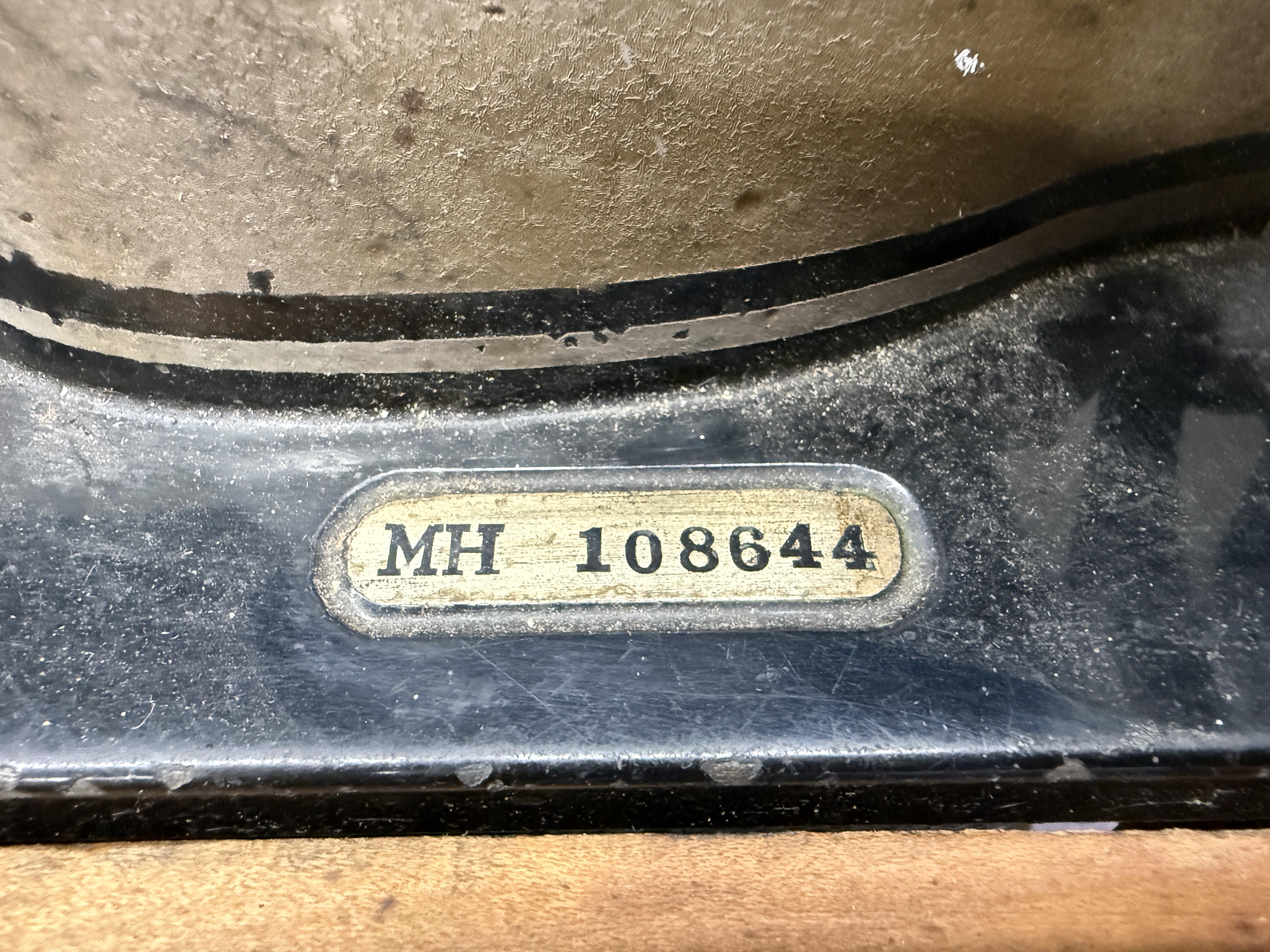

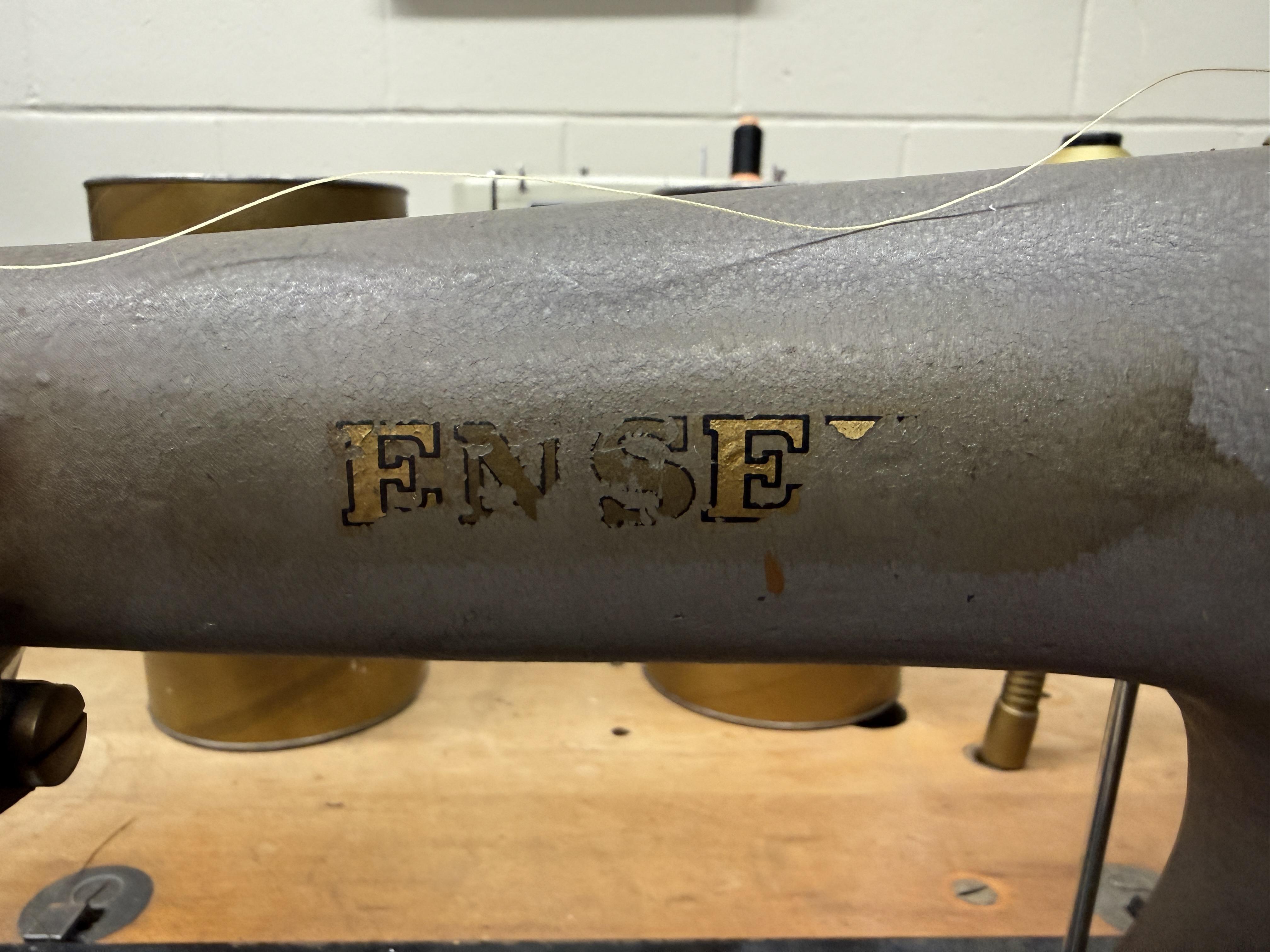

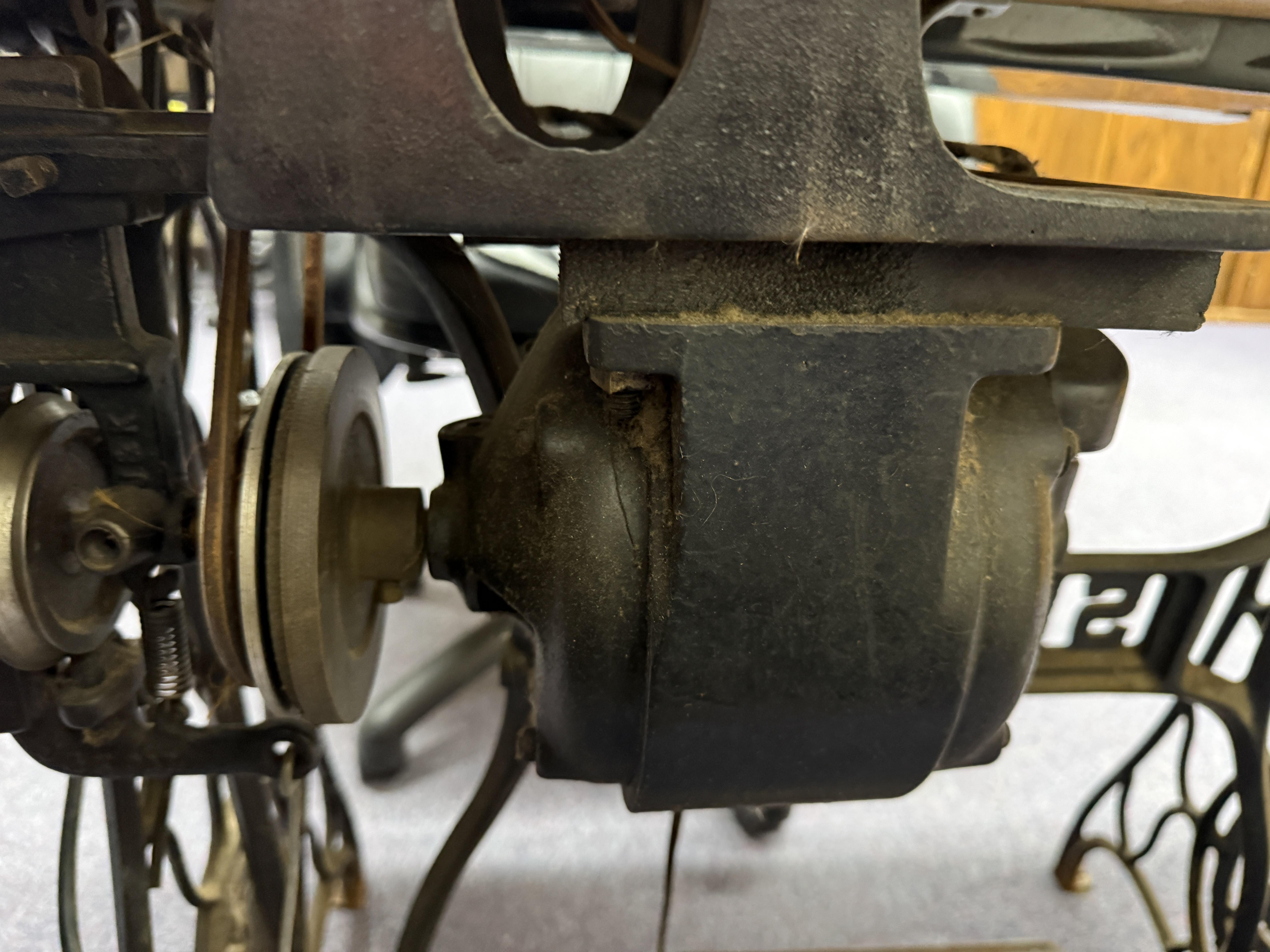

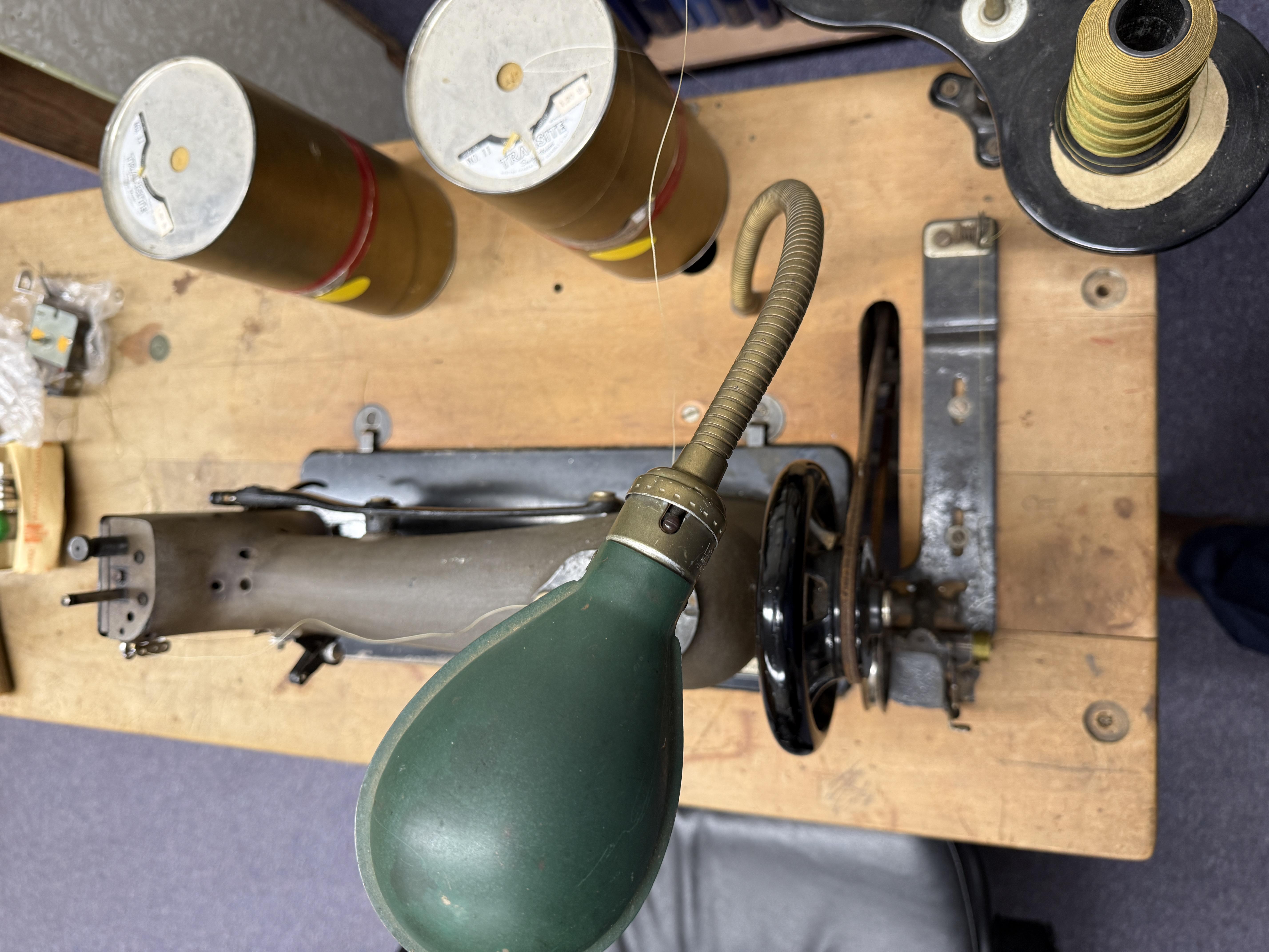

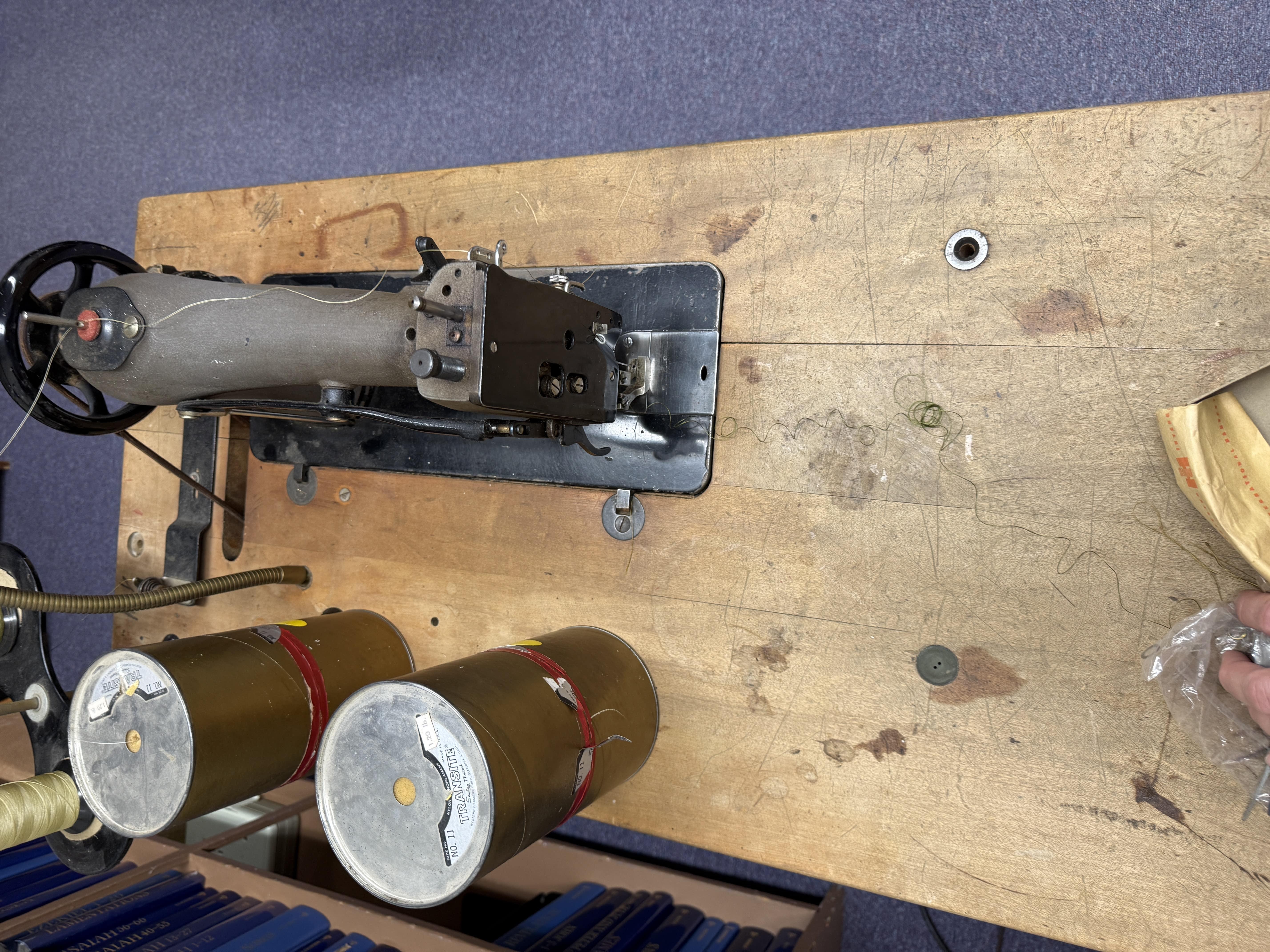

Members boatmaninc Posted December 15, 2025 Members Report Posted December 15, 2025 Recently, I was given this sewing machine. From what I have been able to figure out (not much) is that it's a Consew Model 28 made by Seiko as well as a copy of the Singer 78-3. It's on a Singer Table which appears to be in great shape. I'd like to figure out more. Age? It's the dark olive matte green finish with a black line above the black base. I'd like to restore and use. Any oil recommendations beyond the premium sewing machine oil? Anything need grease? Any idea of the age? I've scoured Google using "Consew Model 28" and only really 2-3 pictures appear in this vintage. Who do I contact at Consew regarding the serial number? Any tips on restoring table? It's age? What is the best think to do to the table top. Any instructions that come with this table? Large factory pin holes found in 4-5 locations on top. Motor maintenance? Can anyone identify the walking foot on this machine? Finally, can anyone explain the weird letter arrangement on this machine? Appears to be two different similar styles of letters. Appreciate any advice, tips and even some criticism. Noah Consew 28 Operating Instructions.pdf Quote
Members dikman Posted December 15, 2025 Members Report Posted December 15, 2025 The feet look like they might be piping feet, a photo of the bottom of them would confirm it. Quote Machines wot I have - Singer 51W59; Singer 331K4; Seiko STH-8BLD; Pfaff 335; CB4500. Chinese shoe patcher; Singer 201K (old hand crank)
AlZilla Posted December 15, 2025 Report Posted December 15, 2025 I've got a 78-1 just because it was unusual, fairly close by and inexpensive. It's really just a run of the mill needle feed machine. And it uses an unusual needle, but it's available. It seems like there were some feet or attachments available for it, that were maybe it's schtick? Look for the parts lists for the singer versions. They might give you an idea. Later this evening I'll get to a real computer and see if I can find them again. EDIT: Attached is the publication I found. I don't know if those attachments are specific to the class 78 machines. But I'd like to find the full set in a box some time ... Singer 78 Beschreibung.pdf Quote “Those who can make you believe absurdities can make you commit atrocities.” - Voltaire “Republics decline into democracies and democracies degenerate into despotisms.” - Aristotle
