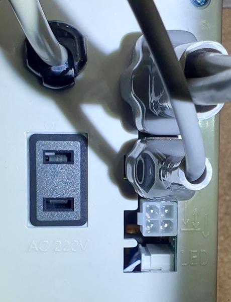

Contributing Member friquant Posted December 27, 2025 Contributing Member Report Posted December 27, 2025 8 hours ago, beefy said: Nothing happens when I attempt to check the needle positioner setting, so my questions are: 1). Is it typical that without a needle positioner connected, you cannot enter the setting for needle positioning. No, this is not typical from the 3-4 models I've used. Are you able to view the other settings? Can you upload the user manual that came with the motors? Is there a 4-pin connector on the back of the controller to accept a needle positioner? Quote friquant. Like a frequent, piquant flyer. Check out my blog: Choosing a Motor for your Industrial Sewing Machine
Contributing Member friquant Posted December 27, 2025 Contributing Member Report Posted December 27, 2025 8 hours ago, beefy said: 2). I cannot find a needle positioner in the seller Ebay store, so will any needle positioner that's meant for a brushless servo drive work. I'm not sure. I've seen two different sized 4-pin connectors used for needle positioners. Have not tried mixing and matching. Quote friquant. Like a frequent, piquant flyer. Check out my blog: Choosing a Motor for your Industrial Sewing Machine
Members fibersport Posted December 27, 2025 Members Report Posted December 27, 2025 If they all have the same connector, then I would say they are probably interchangeable. However, this is also similar to saying are all digital servo motors the same. While the positioner is really nothing more than a switch to mark where the needle is in the up and down position, there is the issue of quality - much like servo motors. I recently purchased a Kinedyne motor and positioner, the positioner when compare to a less expensive model actually feels better. When opened up to dial it in for my machine, it's obvious the quality is much better. I should also say that there are separate dials that are adjusted for the needle positions and an optical sensor for those wheels, whereas with the cheaper model, you rotate the hub that connects to the handwheel to dial in the needle positions. Just my experience with a couple of them ..... Quote

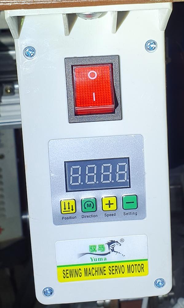

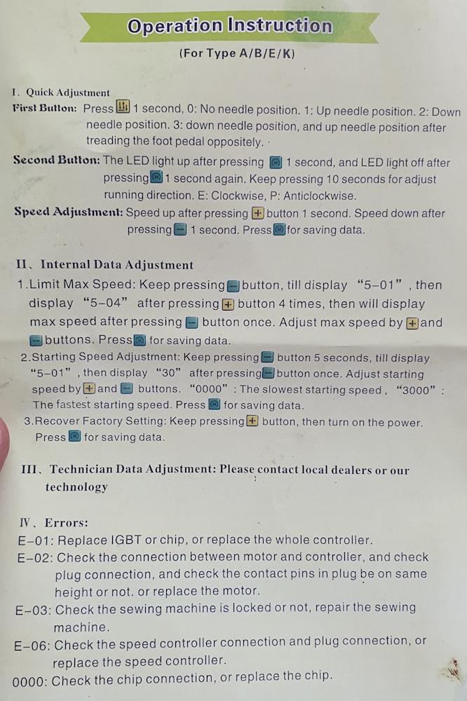

Members beefy Posted December 27, 2025 Author Members Report Posted December 27, 2025 Thanks very much guys. I found pinouts for another servo brand on this thread so I checked mine and I got +5v at pin 2 of the needle positioner connector (referenced to pin 1), so it appears this may be a standard for these types of drive. I've sent a message to the Ebay seller telling them I cannot access the needle positioner settings so I'm currently at the mercy of their service and knowledge of the product they sell. According to the pinout on the above referenced thread if I can access the settings I may be able to test the positioner operation with a simple switch to inject signals onto pins 3 and 4. I've attached a few photos of the drive and the instructions. Keith Quote

Contributing Member friquant Posted December 28, 2025 Contributing Member Report Posted December 28, 2025 1 hour ago, beefy said: I cannot access the needle positioner settings What happens when you hold down the needle positioner button (far left) for 3 seconds, then release? Quote friquant. Like a frequent, piquant flyer. Check out my blog: Choosing a Motor for your Industrial Sewing Machine
Members beefy Posted December 28, 2025 Author Members Report Posted December 28, 2025 1 hour ago, friquant said: What happens when you hold down the needle positioner button (far left) for 3 seconds, then release? Absolutely nothing. I've tried pressing it for various periods of time, up to over 10 seconds, and nothing changes. Quote
Contributing Member friquant Posted December 28, 2025 Contributing Member Report Posted December 28, 2025 38 minutes ago, beefy said: Absolutely nothing. I've tried pressing it for various periods of time, up to over 10 seconds, and nothing changes. I see now why you're asking if a needle positioner is required in order for that button to function.. What about the other menu functionality? Are you able to set forward/reverse and min/max speed? Quote friquant. Like a frequent, piquant flyer. Check out my blog: Choosing a Motor for your Industrial Sewing Machine
