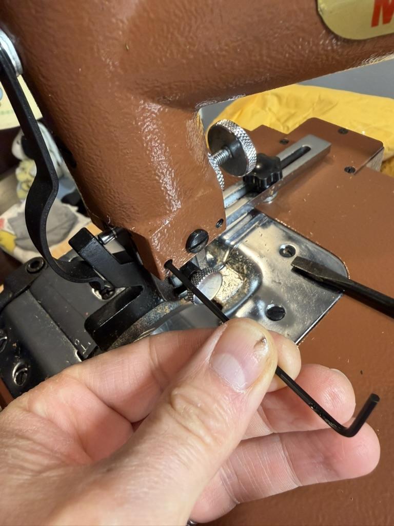

After some phone tag, I got some guidance.  I loosened the Allen screws on the sides and the black screw, but it didn't help.  I didn't think anything was in those holes.

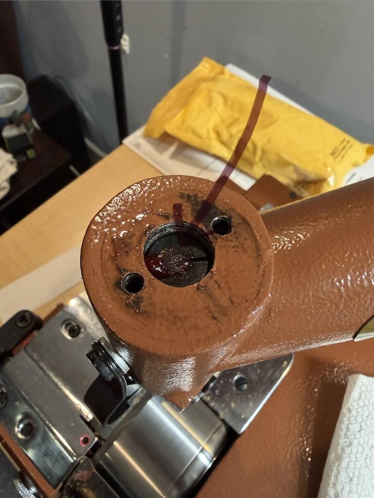

I was told that if that didn't work, then it probably needed a new bushing and was to take the top mechanism off.
965628B7-BBFC-45E6-9C54-5F5329D58A0C_1_105_c.jpeg.6ac150b47625c3c0151a8f007fe73835.jpeg
Well there's no bushing, just a screw that covers up the spring.  As fas as I can tell that's it in the tube.  I put everything back together and it worked better for about 7 pulls then started binding up again.  Less than before but still not right.
