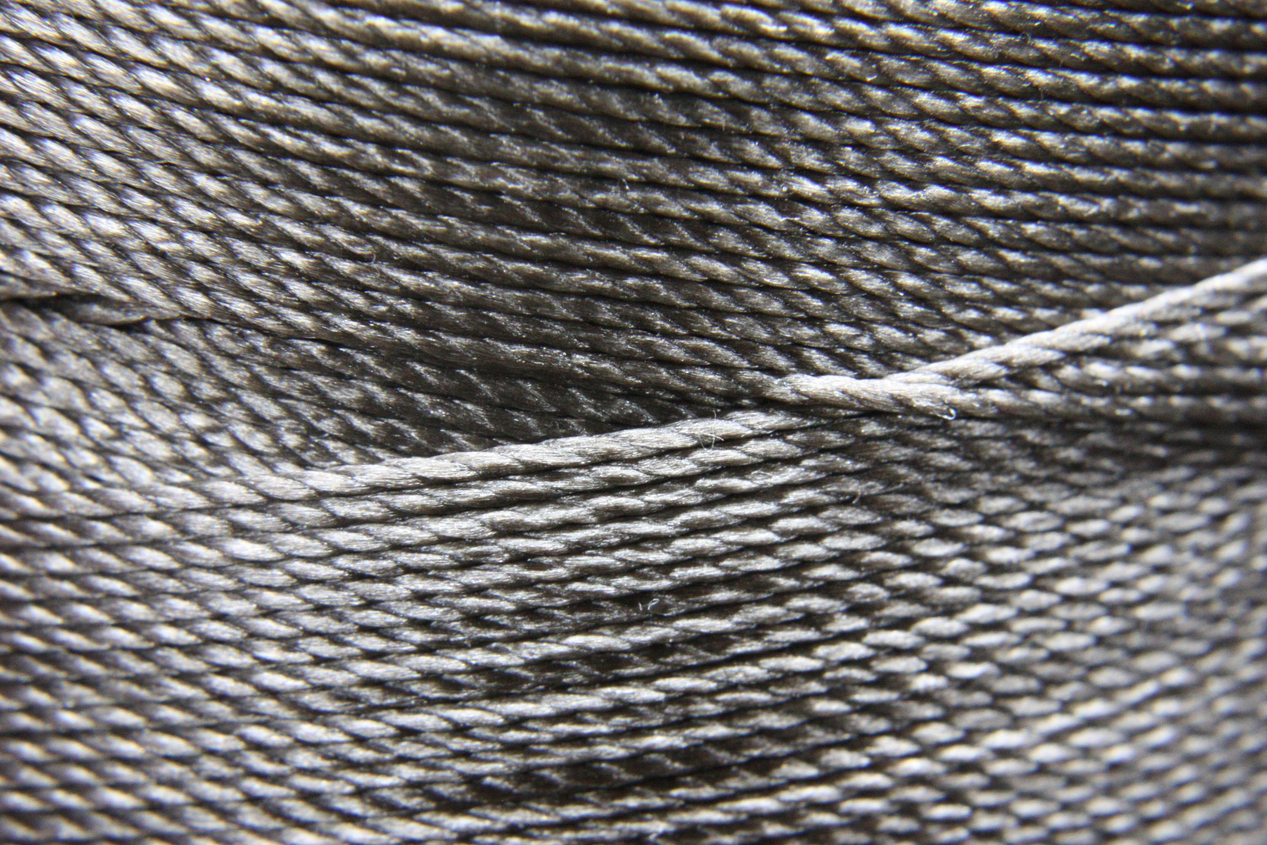

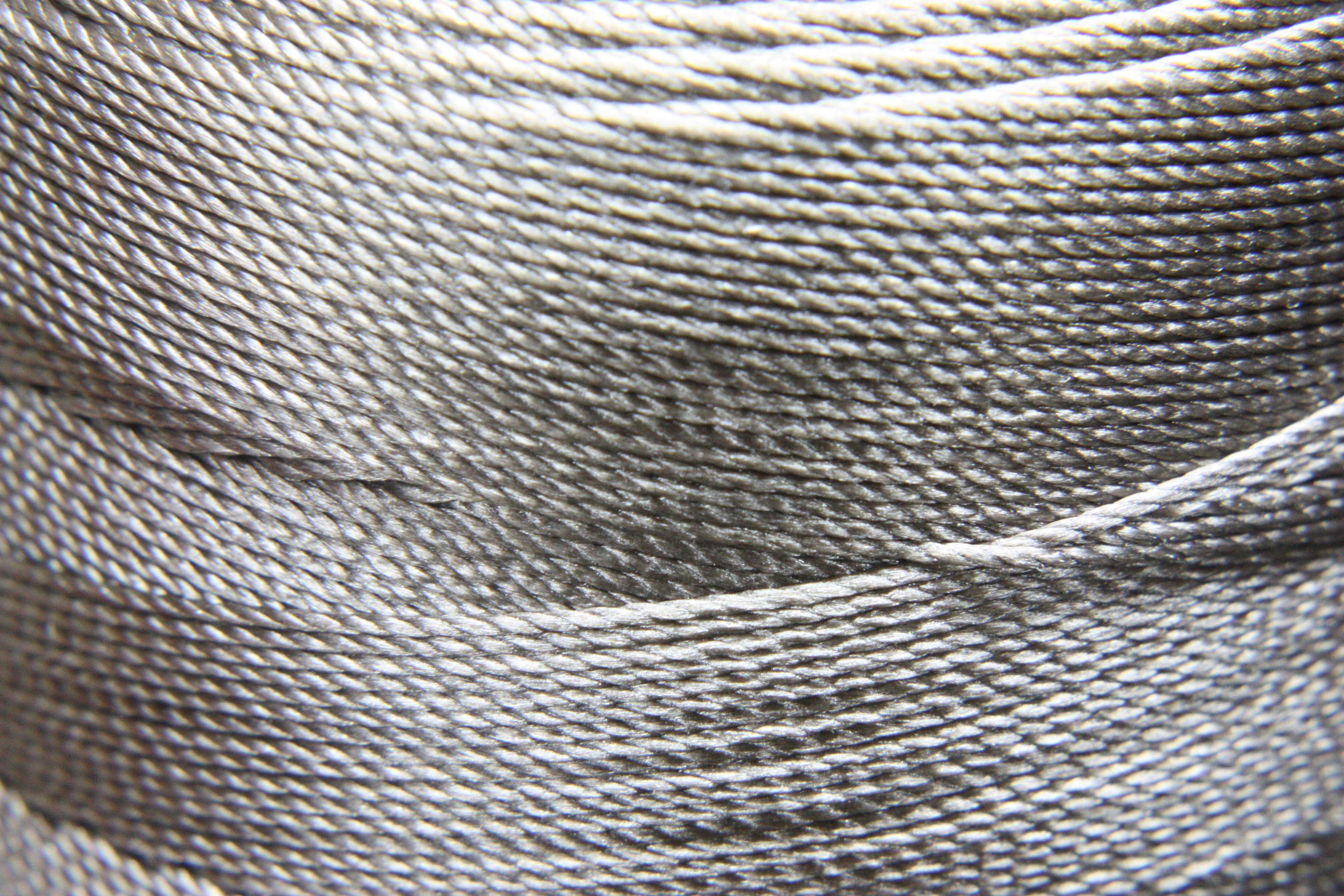

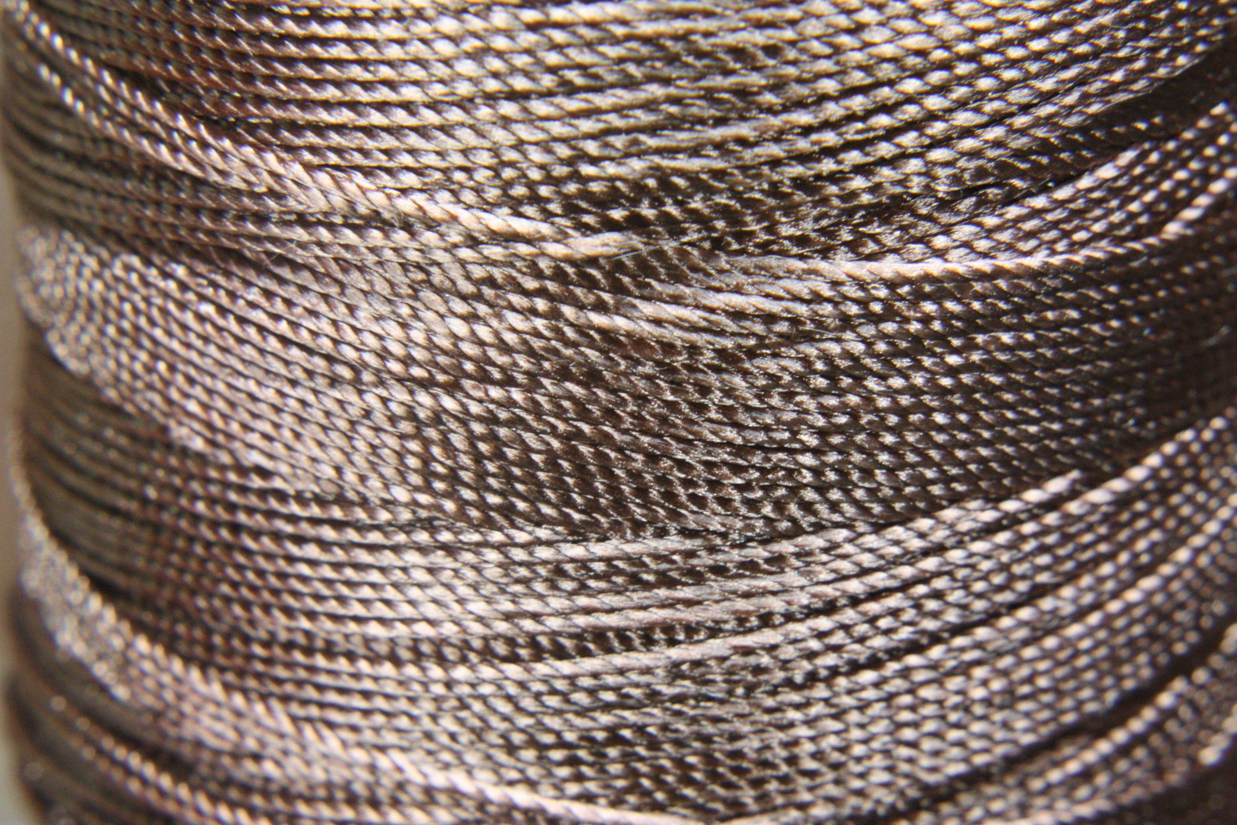

So I thought I would add this thread, haha, because I see a lot of machine problems and solutions, but not many folks question the thread quality. I took a couple of photos to show the problem I encountered.
1. The thread was wound so tightly on the spool that at every crossing, the thread was flattened.

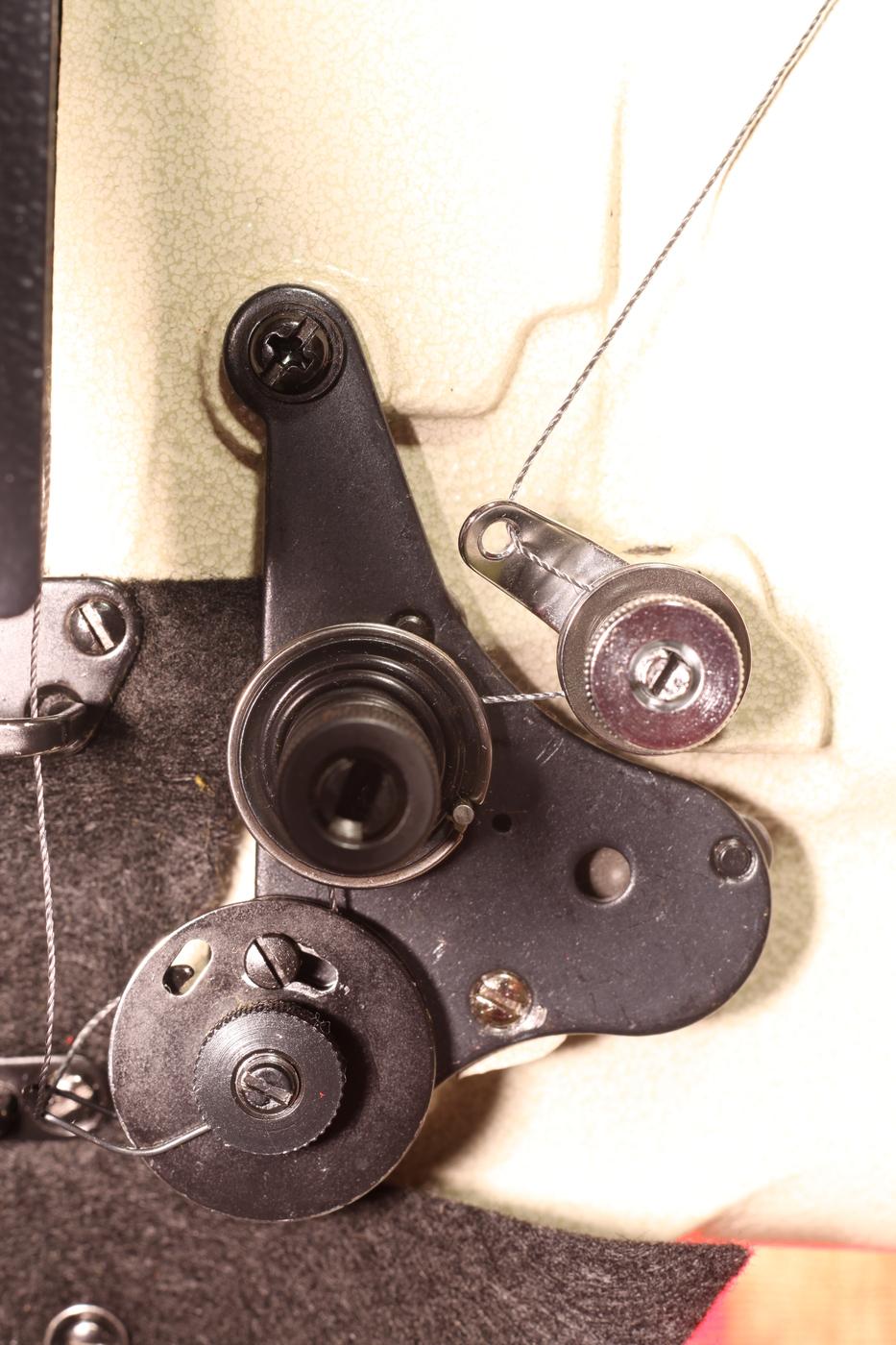

2. The thread was also spun very tightly and was very slick; the second capstan-type tension thing couldn't work correctly. This would cause me to have to overtighten the first tension knob, causing the thread to twist and eventually kick out of the tension discs altogether.
My only half a**ed solution was to put a double wrap on the capstan tension thing. Then I could loosen the first knob and get a decent amount of work before the thread popped out of the first discs.

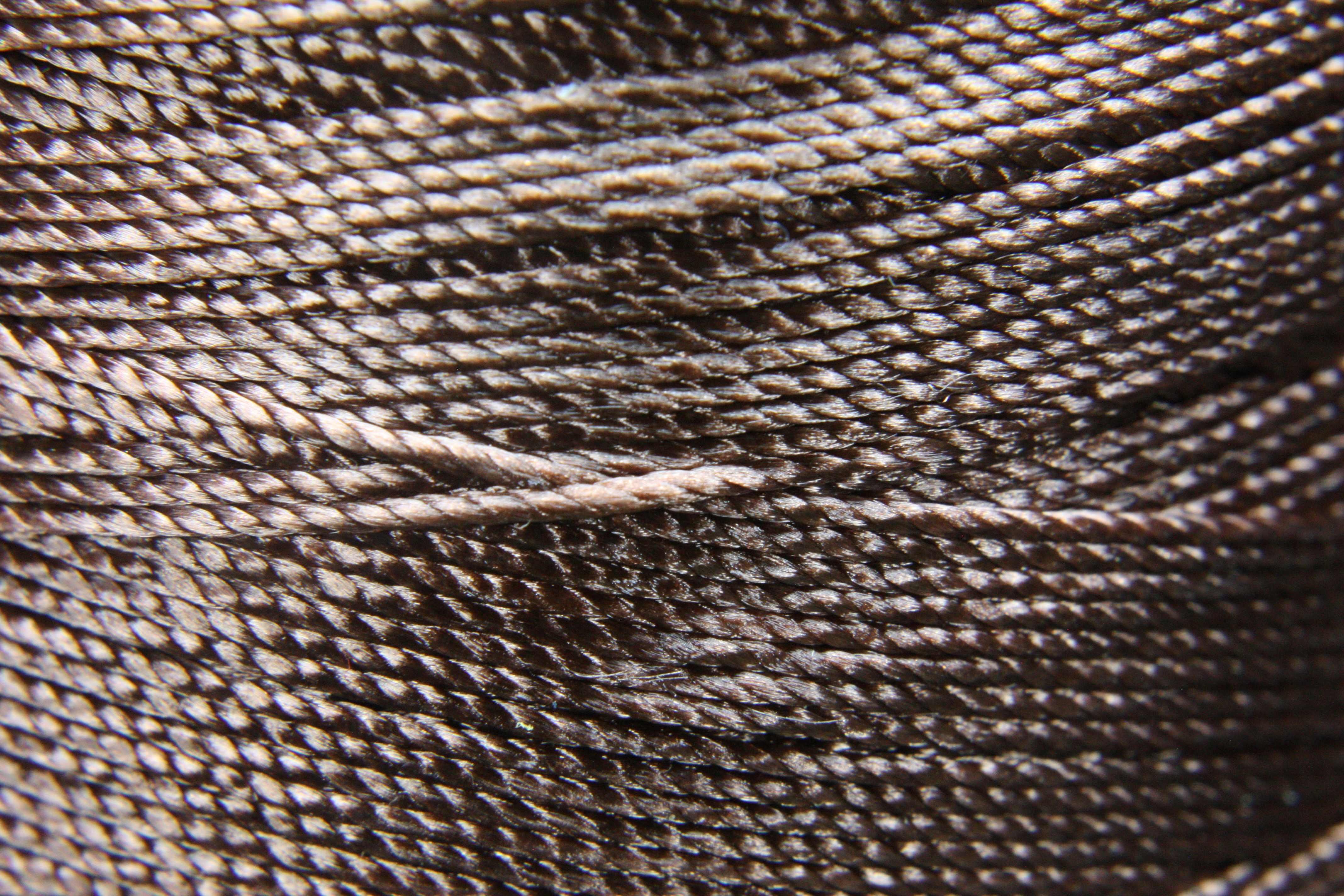

My only gripe about the Springfield thread is it's not brown. The sticker says brown my eyes, and the camera says grey. You be the judge. The brown thread is the Mandala, and the grey thread is the Springfield thread. Great thread, but at what point does someone looking at a case of grey thread with stickers saying it's brown question it?
I purchased the problem thread from Amazon, its brand name is Mandala Crafts. I wouldn't recommend it.

It does seem to be on the gray side in the pics.  It might look more like brown when it's laying against brown leather.

Getting thread to stay in tension discs may require some trial and error. Upstream drag is on your side, and angles can also be on your side too.
Angle
On my 341 class machine using small threads (TEX 70 and TEX 135) I can get by with only tightening the second tensioner. But for TEX 270 I needed to add some tension from the first tensioner to keep the thread from popping out of the second tensioner. And to keep the thread from popping out of the first tensioner, I tilted the (silver) entry guide to the left about 55 degrees as shown in this photo.
Upstream Drag
Drag upstream of the actual tension discs is good for a couple things. It makes it harder for the thread to pop out of the tension discs. It also makes it harder for the thread to curl into loops.
Here are a couple ways to increase upstream drag. The first option is to use all four holes in the thread guide pin (assuming your guide pin has four holes). Also note the post is installed in the machine such that it is not a direct path entering the first hole or exiting the last.
Another way is to only use two holes. Go through the first hole, then do a full 180 or 360 around the post, and finally go through the second hole.
