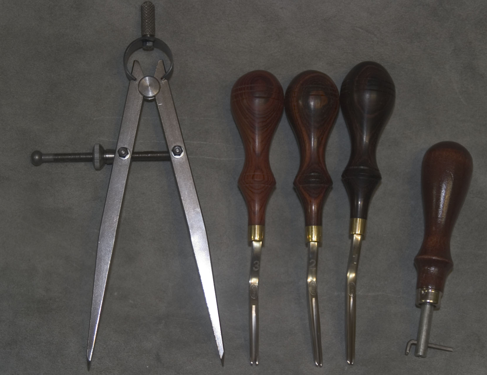

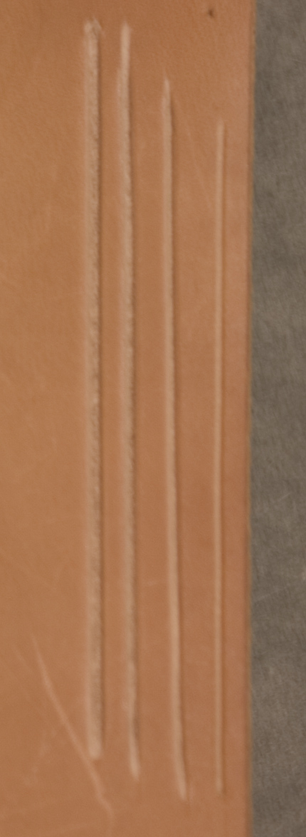

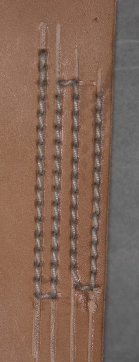

Art Report post Posted February 26, 2008 I use a few different ones. I use Ron's for stitching, especially where I like to lay the thread below the top surface like on belts and harness where they go through buckles. I use the Tandy more for decorating now, however it works for small thread. I use dividers to draw scratch lines then follow those with Ron's. In the following pictures, I dug as deeply as possible to show what maximum is, I am usually a little lighter handed when following scribe marks and correspondingly a little shallower. First, Four grooves made by (from left to right); Ron's #3, Ron's #2, Ron's #1, and Tandy Groover. I laid 346 T\Rice Nylon in each Groove. I Stitched 346 Rice Nylon in each Groove, I backed tacked the ending stitches (Ron's #3), note that in a large enough groove this does not show prominently. I didn't back tack the starting stitch as the groove (Tandy) was too small and it would have looked off. Here's the culprits: Dividers, Ron's #3, Ron's #2, Ron's #1, and the Tandy Groover. If you like the way the Tandy works but want something heavier like the Ron's, you can either use your finger as a guide (takes a little practice), or you can use the Tandy and then go back over with the free hand edger like Ron's. Douglas, Jeremiah Watt, and CSO make the old patent style divider groovers also, and Watt also makes a free hand groover. These are all good first class tools. There is also a Craftool edger similar to the Tandy but a little better, they all take a little practice getting used to. Danny Martin used to make one that was pretty big like a Ron's #3. I use the #1 and #2 most and the #3 if I really want a trough. Art I saw a post on here a while back with a custom stitch grover... Who makes good groovers? Whats everyone use? Quote Share this post Link to post Share on other sites

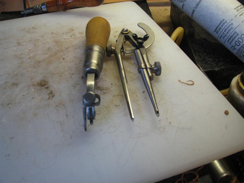

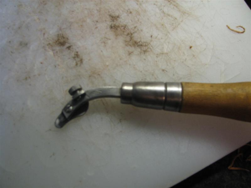

bruce johnson Report post Posted February 27, 2008 I use the TLF saddlemakers groover when I want to make small grooves on thinner leather. I have modified my blades a bit. I took my dremel and narrowed them up some, you really don't need that much blade thickness sticking out on either side of the hole. It mkaes more of a crease than cutting a groove. I thin them up from the bottom for the same reason It puts my cutting edge closer to the bottom of the blade tip. You have to go slowly and carefully or you might go too far. It really does improve their performance for me. I have attached pictures of the two I use the most. One is the Osborne probably like Marlon has (#30, I think). Not one to be satisfied with most Osborne tools as they come, I have modified it too. I don't need one to pivot on a sharp point, I need one to ride an edge. I ground the point off and left the inside flat. It rides like the oldies. Even the smallest grooving point is size #207 thread and up for me. The loop type blade will cut as deep as you want to go. A plus for me for some applications, but not for the "save the grain" consortium. My favorite is the wooden handled one. It is marked H&R. It is a nostalgia tool, and I bought it from my old tool buddy. I liked trying it out. He never would sell it to me directly, always figured he might need to "make himself a belt". Belt time passed and you all had a chance to buy it on ebay too. It is an old shoe tool, used for grooving soles. The downside is that the fence extends down pretty far. It is designed to ride off an edge and works well for double layers of skirting or heavy belts. Not so good for anything under 10 oz, unless you hang it over the edge of the bench. The upside is that is cuts a nice narrow groove, again as deep as you want to cut one. Apparently you can use it like a channeler, and glue up a deep channel and tap it closed if you want. Most of us have some tool(s) with a history, and this is one of mine. Quote Share this post Link to post Share on other sites
