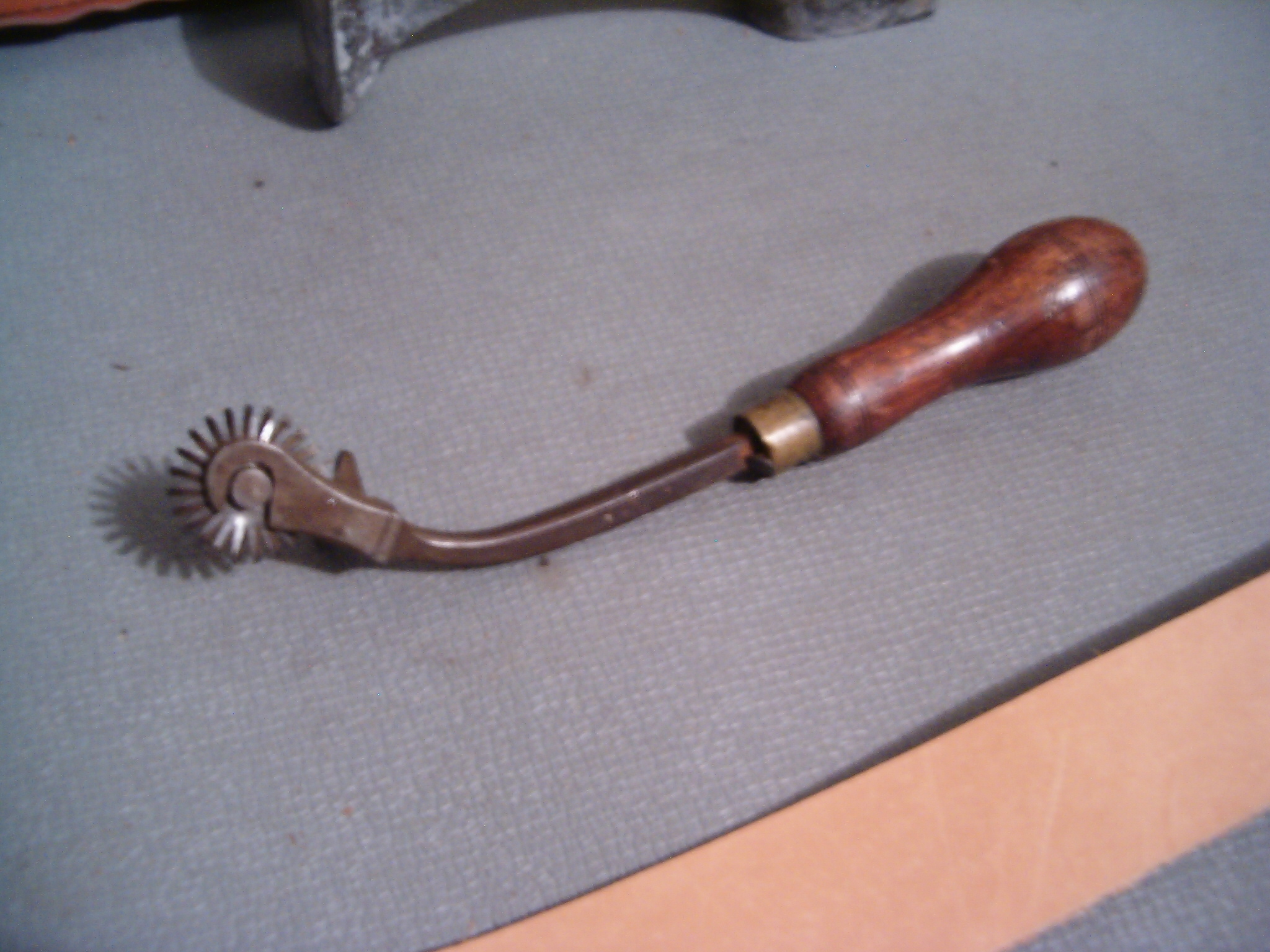

Pricking irons and wheels.
When I was taught the saddlery trade we used pricking irons to mark out our stitch length. 6, 7, 8, 9, 10 and 12 stitches per inch (SPI) were the common sizes. When I bought my tools form a retiring saddler he had pricking wheels. I had never seen these before, but now quite like them.
From the pics.
Pic 1 is my pricking wheel carriage with a 6 SPI wheel.
Pic 2 is a pricking wheel on it's own before it is attached to the carriage.
Pic 3 is a pricking iron. As mentioned either version is simply to mark out your stitch interval and is not intended to make holes, that is what you awl is for.
Pic 4 is probably blurry a bit but I hope it shows how the pricking wheel (or iron) lays down the marks at a 45 degree angle. The bottom row of marks has been made with a common stitch marker/over stitch wheel. The combination of the mark at 45 degrees and pushing your diamond blade awl thru at the correct angle (forming a kind of parallelogram shape) helps to lay your stitches at an angle. This is indicative of good hand stitching.
From the pics.
