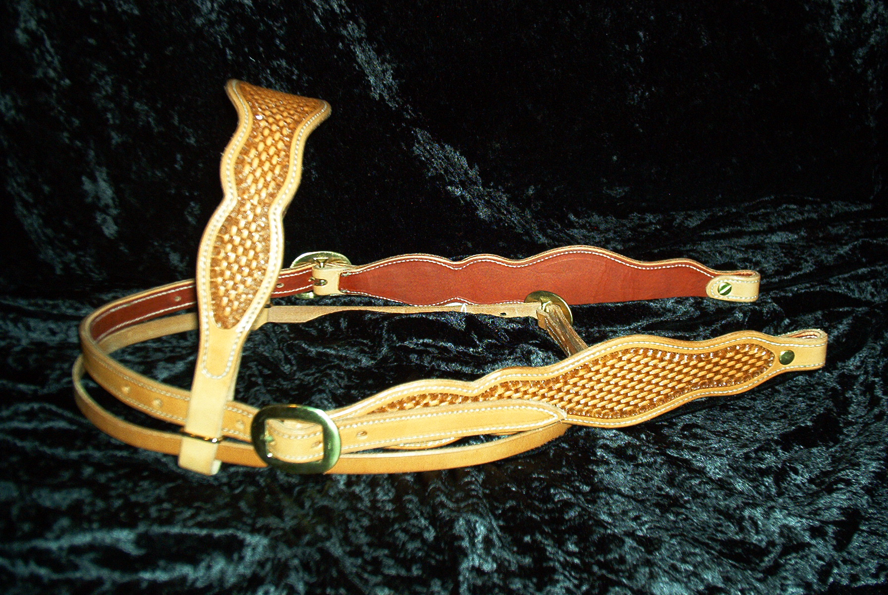

MarkB Posted March 9, 2009 Report Posted March 9, 2009 I use 8-9oz. strap from Hermann Oak Leather Co. for the outer piece and 5-6oz. Latigo for the lining. I use latigo because of horse sweat. I use Harness a lot to, for that I like 10 oz. or heaver for a single piece headstall. Here is a headtsall that have made. www.cowcampsaddlery.webs.com Quote Visit My Website To succeed you must try, Not trying your sure to fail.

Members RunningRoan Posted April 14, 2009 Members Report Posted April 14, 2009 I use 8-9oz. strap from Hermann Oak Leather Co. for the outer piece and 5-6oz. Latigo for the lining. I use latigo because of horse sweat. I use Harness a lot to, for that I like 10 oz. or heaver for a single piece headstall. Here is a headtsall that have made. www.cowcampsaddlery.webs.com Hey thanks for the info! Nice headstall BTW! I just asked this very question (leather weights) on another thread on here. Have you found 5-6oz to be the best for lining? Have you ever lined with something besides latigo? I found some oily chap leather the other day that I really liked, but wondered if it was too buttery for lining? Wasn't sure if it'd glue to the backside of the veg tan well enough to sew together? Quote
