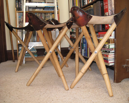

I make quite a few of these stools - the picture is of the batch I finished this weekend. My legs are always 2ft long with the hole for the tri-bolt drilled halfway. I get the legs made by a wood turner which isn't cheap but they look much better than anything I can make myself.
IMHO, the best way to design one of these is to built a tripod from broom handles and use it to work out how large a seat you want to make. I make the pocket pieces exactly the same size as the rest of the pattern and it works fine for me. Check out the picture.
I order the tri-bolts in quantity so if anyone wants any please get in touch by PM. They are not too expensive but, being quite heavy items, shipping can add a bit.

I generally take the seat off the legs and wrap it around them. I have been known to attach a strap to the seat to tie it all together... I even added a shoulder strap for an artist who wanted to carry it on his shoulder as his hands were full of easel and paints. I guess you just do whatever works for you. They are surprisingly comfortable though.
Luke makes his stools a little taller than mine and he sews his 'pockets' on whilst I use a heavy lacing. Like I say, whatever works. Have fun.
