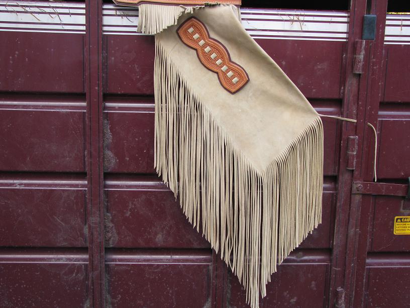

Back to the subject: As to cutting fringe - again there's more than one way, but here's how I mostly do it ...
In my work, which these days is most often 19th Century Indian style, which uses soft leathers such as elk or deer (mostly braintan or chamois) and is quite often 24-30" long or longer, I dampen and pre-stretch the hides for fringe and leave hang for a couple of days in the sun - if need be I re-stretch. This helps immensely and does no damage. I then use good sharp industrial scissors, but I DO NOT saw my way through (no blisters!)- rather I start the cut and slide/glide the shears through the leather - with practice it's easy to cut even very fine fringe. No it's no 100% perfect, but then nothing I do anyway is - only the "Great Spirit" is perfect...
The other option I use when cutting shorter lengths is similar to Luke - I dampen the backside so it "sticks" to the surface of the cutting board ( I use those one of those self-healing boards fro fringe). Then dampen the face so that the straight edge (I use a 1" wide galvanized metal strip) will "stick" and then cut with a sharp knife (your choice of course!).
In both cases I keep a strop handy and continually strop my cutting instrument......
as always - other mileage WILL vary.........
Edited by ChuckBurrows
Results of using various methods to cut fringe in soft leather and suede
1) utiliyt knife and steel rule:- leather stretches and doesn't always cut through on one pass, strands uneven and looks crap.
2) rotary knife and steel rule:- leather stretches and doesn't cut as well as the utility knife, strands uneven and looks crap and smells of cheese (maybe I should have washed the knife after using it on the pizza).
3) head knife and steel rule:- leather stretches but cuts on one pass,still uneven and looks crap.
4) jerry stripper:- leather stretches but cuts ok, still uneven and crap but much quicker.
5) get someone else to do it (a friend who knows nothing about leatherwork and uses housold scissors):- no stretch, even strands.

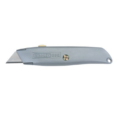

I'd never heard the term Box Cutter until 9/11, out here we always called them Stanley Knives. I've used them to cut Plaster Board ( Sheet Rock ) but you are really only cutting the heavy paper coating and then snapping the sheet along the score line and the plaster blunts the blades really quickly. I do sometimes use a clicking knife sometimes but never "Box Cutters". I don't think the blades are as sharp as a knife blade that I can sharpen myself.
Tony.
FWIW - I polish/strop utility blades that same as I do any other blades......
The international nature of the board means there are bound to be issues of nomenclature and semantics.
We, here in the UK have been 'Hoovered' and 'Fridged' and 'Xeroxed' into using the term 'Stanley knife' to mean any utility knife. I am aware of other countries having different names for these.
To me, a Stanley Knife is one of those in the pic below. I'm assuming Razor knife and box cutter are variants of the same thing. Might be worth clearing this up.
