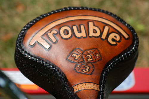

Members ChaChi Posted March 3, 2008 Members Report Posted March 3, 2008 I did this one for my daughter. Kinda rough, but I wanted it to look like a 3 year old's tricycle, not one of my motorcycle seats. If you have a good seat to start with, just remove the factory cover without destroying it and use it as a template. You'll have to disassemble it of course. Install it the same was it was attached before. If it's a metal seat pan, rivet it. If it's plastic or fiberglass, staple it. You can even cover the bottom in speaker cabinet carpet to finish up the bottom nicely. I'm starting on a seat today for a friend's son. He saved up his money and bought a way cool OLD schwinn sting ray and wants the seat done in leather. I try to get some pics throughout the process for you. Cha-Chi Quote I gotta have more cowbell !!!!

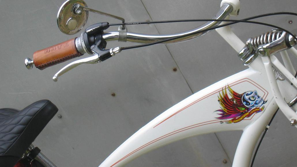

Members Pauly Posted March 4, 2008 Author Members Report Posted March 4, 2008 Hi there! I'd love to make myself a seat for my cruiser bicycle but I'm a bit daunted by the task and not sure where to begin. Wallets and belts are one thing, this seems harder. I was planning on covering the existing fabric seat. If someone could give a quick rundown on how they'd tackle it, when to mold, when to tool, how to attach to seat etc. I'd be most appreciative. Thanks. Pauly Excuse my clumsyness I'm still working out how to use this chat site...computers easy to use only when you know what your doin'. I've tried to upload a couple of picks of my beloved pushy. You can just see the seat, when I've got a minute in the daylight I'll photograph the seat properly. I've made grips one says 'love' the other 'hate' just like the finger tattoos only doesn't hurt as much. I do a lot of drawing, always have and leatherwork has given me a practical means of getting my stuff out in peoples daily lives. I like old etchings especially by Durer (spooky stuff) scrimshaw and tattoo. I'm thinking Tiki mask and jungle foliage for my seat in tan to match the grips. Quote Dark is a way and light is a place.

Members RockyWolf Posted March 4, 2008 Members Report Posted March 4, 2008 (edited) Hi thanks for the photos now your project is starting to build in your mind... you say Tiki mask and jungle foliage for the seat in tan to match the grips. Nice one !! now the next stage drew this out on paper full size using the size of the top of your seat as a guide and see what it looks like paper and pencil is cheaper and a good project need good planing to make it look right ... now you say your sewing is not very good. I suggest you get up to speed in the areas that you need to build your skills on by working some leather projects start on little things first that use stitching also at the same time use some of the Tiki Art from your seat pattern so you get used to working this in Leather little steps at a time then when you are ready use the old seat as your main pattern for your first seat project to make things easy for yourself that is ... I would make a cardboard template from your old seat to keep as from this you can mess around modifying and playing around to make more custom jobs at a later date as this I find is the best way to learn by getting your hands on the tools and leather and just enjoy seeing what if I adjust this or do this how would that look when it's on the bike... Looking forward to seeing your seat coming together Pauly I also like the look of your bike by the way... Something I haven't got the time to build Yet below Edited March 4, 2008 by RockyWolf Quote
