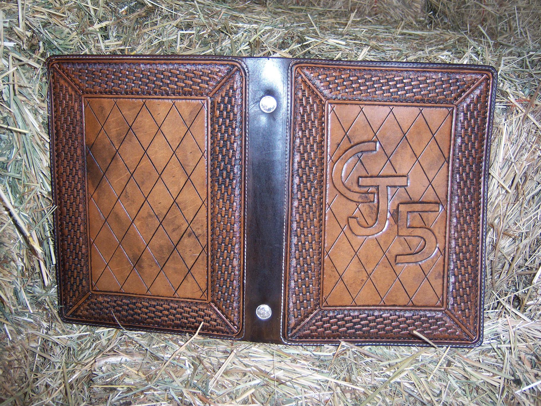

Members Tkleather1 Posted March 14, 2009 Members Report Posted March 14, 2009 the only way that I have covered one was measure your binder and all the hinge points and make the cover roughly the same size but a little bigger. and then stitch pockets that the binder itself can slip into. But my personal favorite way to do it is cut the binder portion (ring part) out of the book and then build a new cover out of leather and line it with light chap leather. then use either decorative chicago screws or nice conchos to attatch the binder. Quote

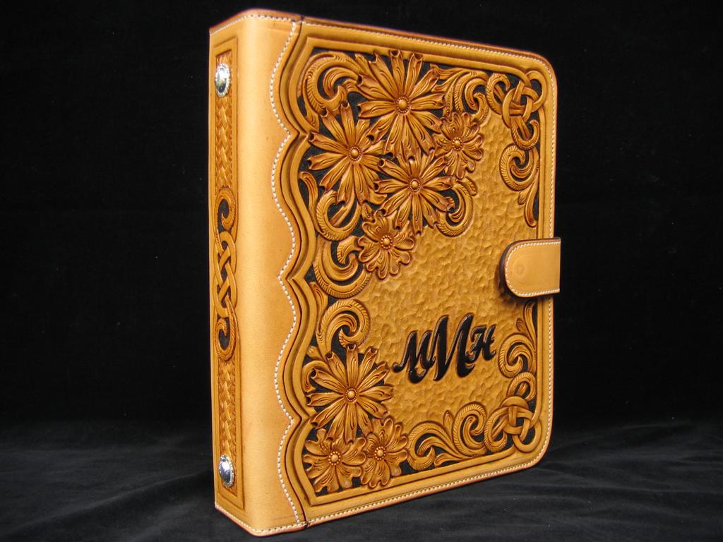

hidepounder Posted March 14, 2009 Report Posted March 14, 2009 Josh, Here's how I make a notebook or binder. It's made out of three pieces. The front cover, the back cover and the binder. This is constructed completely of new leather. The front and back are 7/8 oz and the binder is 4/5 oz tooling leather. The lining is 2/3 oz. I have not seen a binder which was purchased and then covered with leather. I think that would be an impractical approach (if I interpreted your question correctly). Tool the front, back and binder, sew them together, line them and then install the three ring binder with chicago screws and/or conchos. Obviously, any combination of pockets, etc., can be added to the interior. Hope this answers your question. Bob Quote

Members Tkleather1 Posted March 15, 2009 Members Report Posted March 15, 2009 Wow look at hide pounders and not mine. I should scrap mine and try again that thing is beautiful. But it sounds like we have all come to the same way of doing things. I obviously still need to work on it but I do it the same way now in my revamped version again this one is the first one and very experimental. Quote

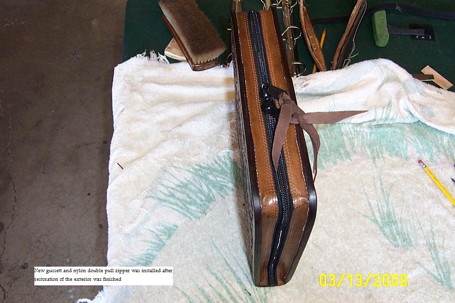

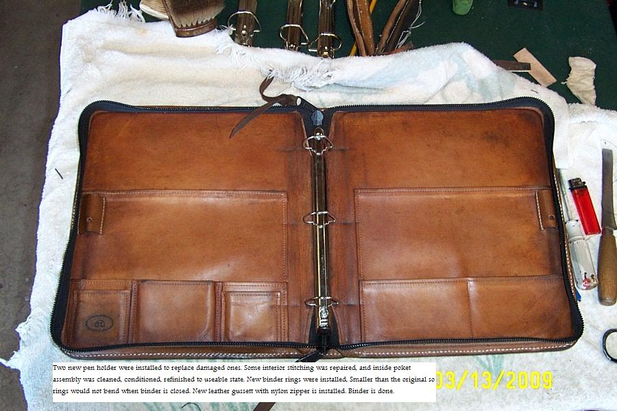

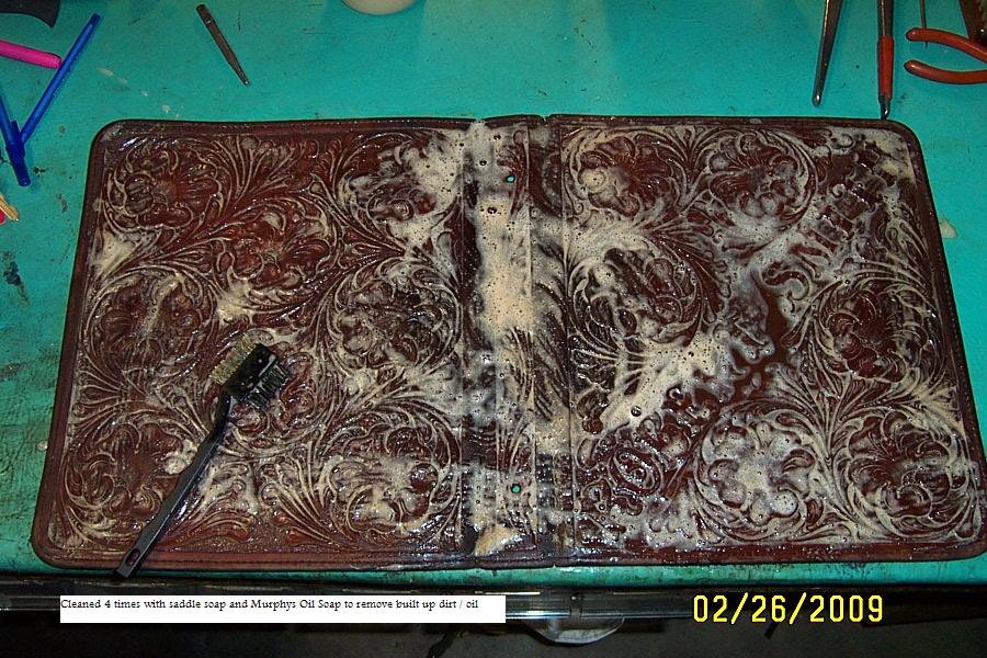

rickybobby Posted March 15, 2009 Report Posted March 15, 2009 (edited) Josh, I restored a binder for a customer that was made by someone else. It was run over by a car and someone else tried to put a zipper in and did not do it right. The 3 ring part was bent (was not a good one). I replaced the gussett and zipper, the zipper is a nylon #10 double pull. I replaced the stiffener with plexiglass from Home Depot Restored the finish by cleaning, conditioning, antiqueing and sealed The insides are a great design,(2or 2 1/2 oz) I will do something like them when I make one. The outside is 10 / 12 oz tooling leather. Here are some pictures to give some ideas hope they help. I also bought a couple different binders (there is a difference) the "heavy duty" ones are the best. I bought mine at Office Depot. I used a carbide cutter to remove the back of the rivet on the 3 ring so it would not scratch the piece I needed . Edited March 15, 2009 by rickybobby Quote
