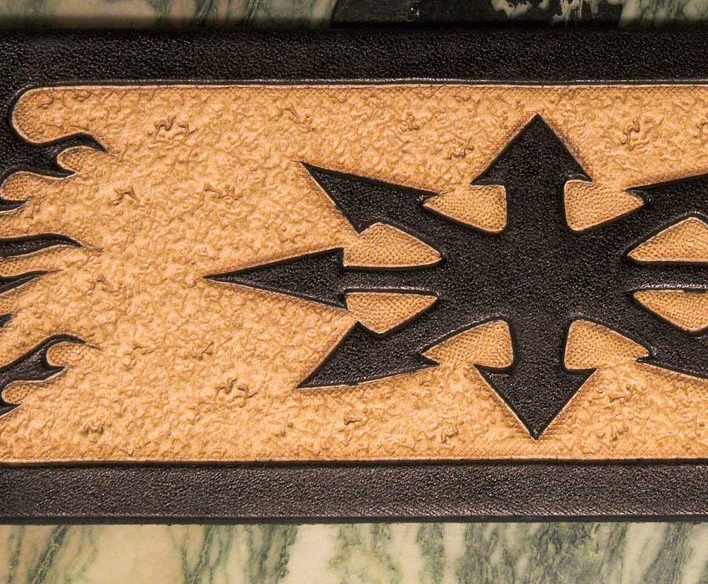

This a background pattern I use alot. I use crafttols E-294 for this type. The leather is almost dry when I apply the backgrounder and after I've gone over the whole surface to be covered I smack down the backgrounder tilted here and there with a good whack to make few extra deep impressions to further enhance the texture.

Has it only been bevelled around the image or has the whole background been pushed down then textured?

The whole background has been textured/pushed down. As you may see I have used a beveler around all edges/conours prior to backgrounding and in the narow part in the symbol I used the small dropshaped A-104 to push down the background. E-294 is a bit big to go in there but main reason is that I think another type of texture there will make the symbol "pop out" better.

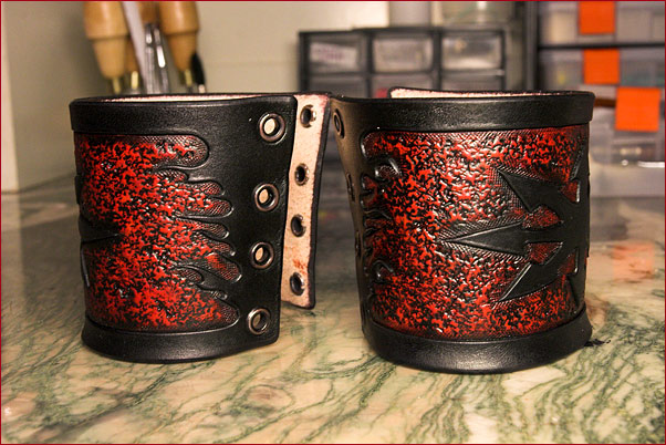

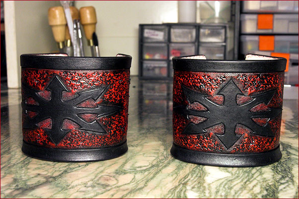

Attached images shows a complete image of this job but with a better ovierview of how it turns out when not viewing in a blown up pic that is high in detail.
