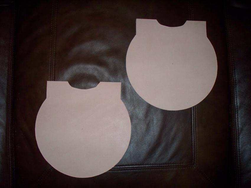

This is the pattern I made for cutting out both sides of the canteen leather.
I only use the pattern as a guide to get the layout started.
It's hard to make a perfectly round cutout of anything, but the rounder the pattern is in the beginning
the better off it will be in the end. So the white poster board pattern is only used for the the center mark and the top.
When transfering the pattern to your leather trace the top part out and mark the center point. Now remove the pattern
and use a compass to draw a perfect round circle on the leather. The center point will be used for more stuff later as
well. Be sure and flip the pattern over when you go to make the next one to ensure that they will fit together better
when finally putting them together. I've posted some additional pics showing the dimensions of the patterns. Be careful
and don't make the overall circle too small as it will be tougher to sew when you get to that stage. I use a 9" circle
and that seems to work pretty good. I usually make them out of 6-7oz or 7-8 oz leather. Thicker and you'll need to
allow even more. It has been a learning curve to come to this dimension, you can go smaller and tighter but it makes

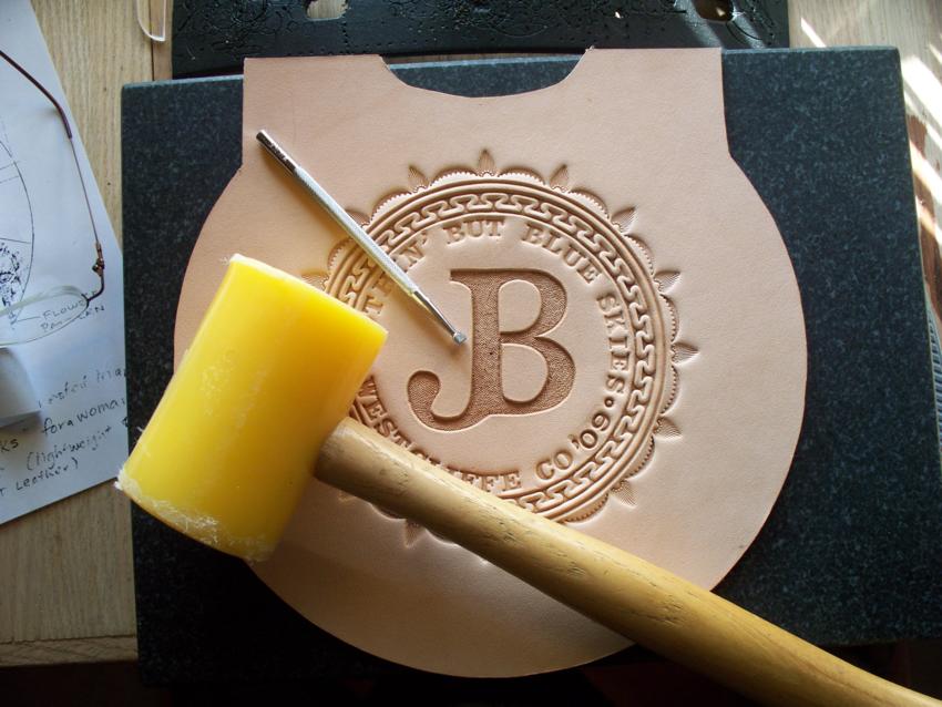

For the center of the canteen I'll be doing initials or a brand. In this case its initials made to look somewhat like a brand.
My inside secret for this is that I use picnik.com to lay out, size and position my lettering. I save a blank white page in the
paint program then upload it to picnik to use as my "background" then just start playing with the lettering til I come up
with something I like. My next big secret is that I use my computers monitor as a light table to trace the design over
onto the tracing film so I can transfer it to the leather. Yet another trick is that you can keep recycling your tracing film, just
use a different color Sharpie marker every time you use it and and you can just keep going. But in this case the designs
had no chance of interfering with each other so I just used black again.
Use a stylus to transfer the design on the film to the leather. After that you can cut the design in with a swivel knife.
Nothing too important about it but just be sure and keep the outside edges clean and straight as any mistakes will be
very obvious on these edges.
Once you get it all cut in you can start in with the matting tool. I have used several different
matting stamps but I prefer A104 as it is small enough to get into sharp corners and leaves a nice dark background
once the antiquing is on. I used in on the edges first, but not necassarily all at once, then fill in between them. When
going along the swivel knife cuts angle the tool as shown to keep the edges clean and track free. It takes
practice to get it to come out even as well as to eliminate the tool marks. Don't be afraid to go back over it to make it
more consistent as well as to keep it level. Some of the matting tools are harder to make more consistent due to the
marks on the tool face being wider spaced. But whatever you use just make it even and level with as few tool marks visible
as you possibly can.

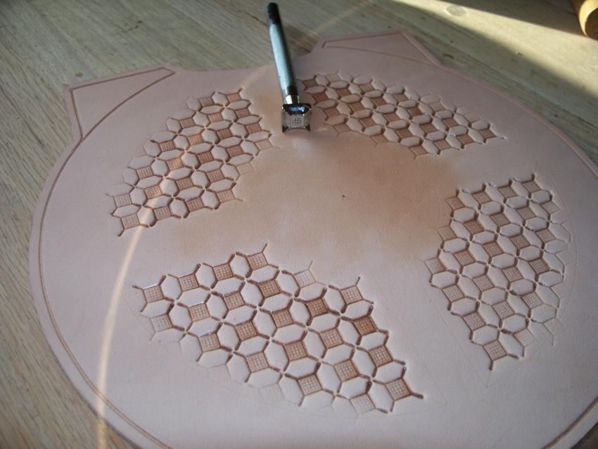

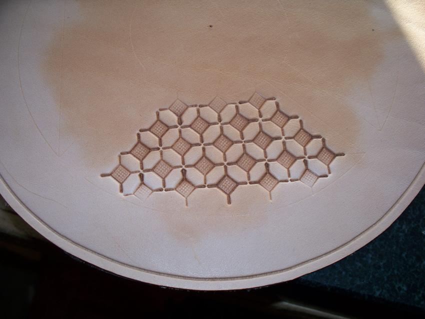

The white template in the next pic is what I use to layout the back of the canteen. The ruler gives you the basic
measurements if you want to make your own. But you get the idea. Anyway, I use a stylus and trace it out on the back.
Now in preparation for tooling I draw a line from corner to corner on each of the 4 panels. Next I start the tooling.
You can pretty much look at the pics to see how I lay this all out. The stamp I am using is a G548. You'll need to figure
out the spacing from end to end along this line to keep it even then start stamping. Wath the edges and don't go over
the lines. After you get all the full impressions made that you can come back and start making the partial impressions
to fill up to the edge. The neat thing about this tool is that you can rock it on one corner or two to get partial
impressions from it.
