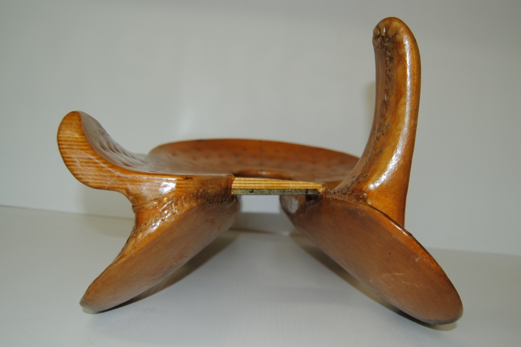

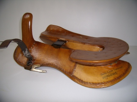

That's really neat. How much time, effort, research and trial and error did you have in this first one?
Regards,
Ben
  • Contributing Member
I agree with Ben, it looks really neat. Is it going to come with instructions on how to build a saddle on it?? :wacko:
Awesome job guys. I'm curious how you have attached the stirrup bar and leaping head.
