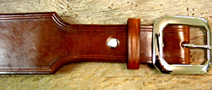

Work out the part of the belt you want 1.5 and the part you want 1". To me the distance from the wide to the narrow is a bit of a by eye thing. You want it to be a gradual blended in taper and not abrupt. As an example taper it in over say 2". Set you compass/dividers to 1/4" and scribe a line down each side (taking into account the distance you want to work in your taper). I use my round knife and work the taper in over an aesthetically pleasing distance but you can ever so lightly scribe in a faint straight line between the wide and narrow areas. Just use this faint straight line to guide you in blending in the cut.
Some people use a large round punch to get the effect like in the pic.
