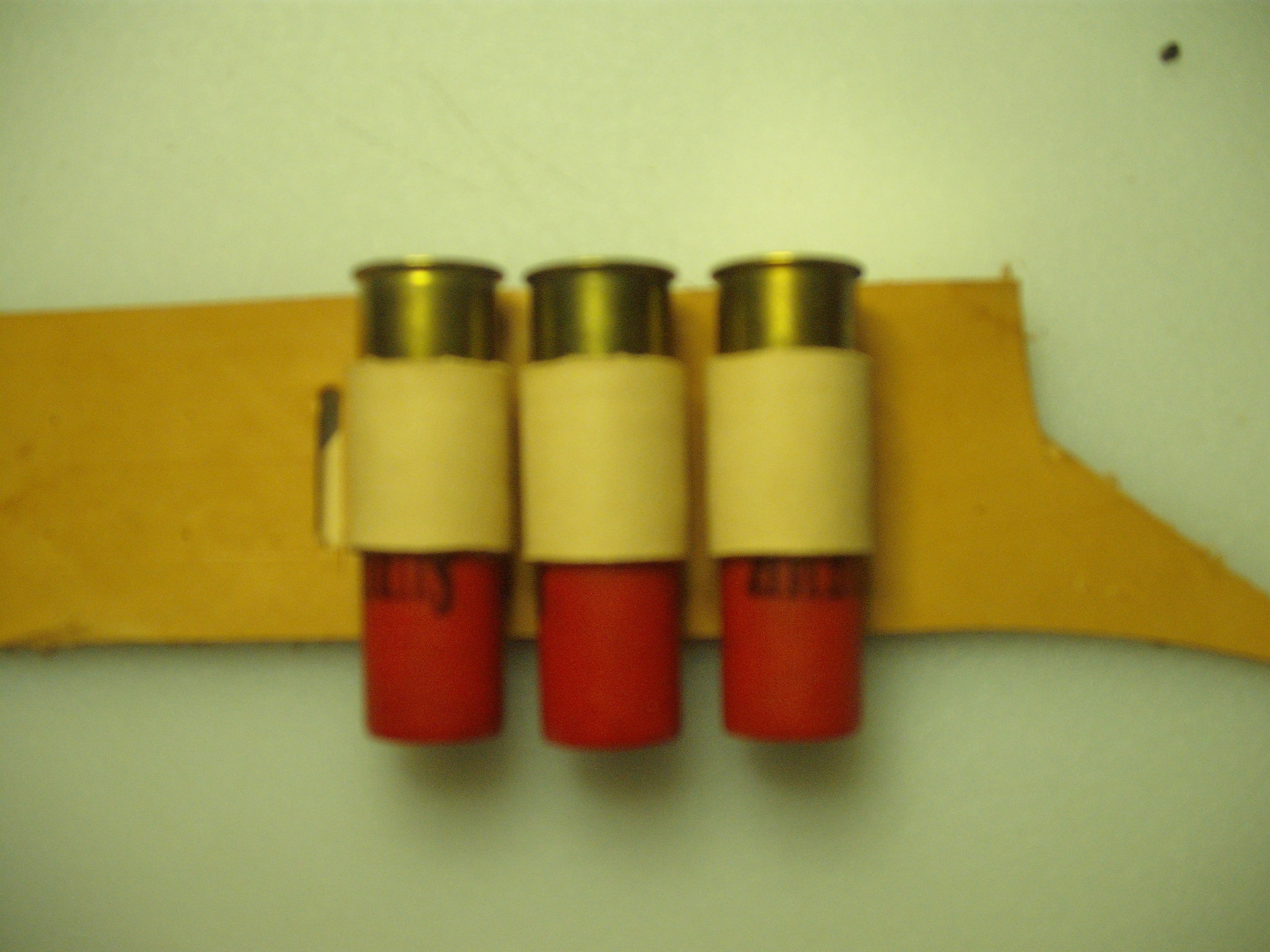

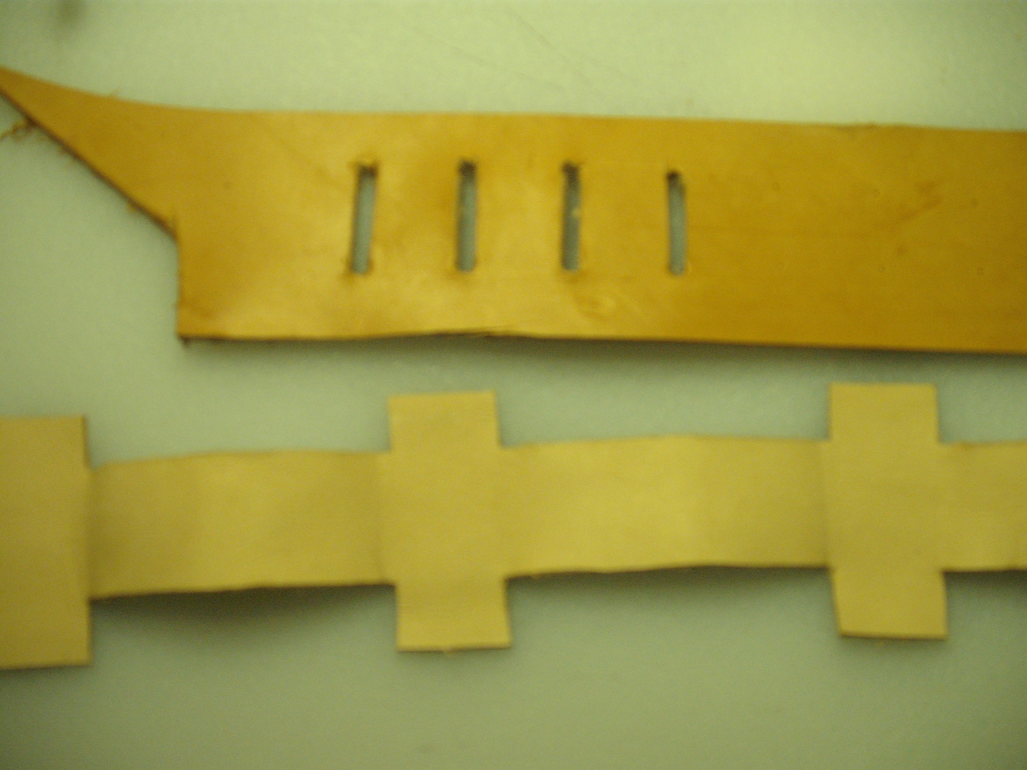

Sorry to revive an old thread, But, I was asked to make a shotshell holder for a 12ga. I did a search and found this thread. As I was working out my measurements with some scrap, I came up with this, which I thought some folks might be interested in if you didn't want to use rivets. I plan on using Badger's method of one slot per loop..
I cut my loop material the same width as the belt. Then I trimmed the areas for the loops.
Then I pushed the trimmed areas through the slots and checked the fit of the shells.
Posted (edited)
This makes it so you can just run your stitching along the top and bottom of you loops, or just stitch everything when you sew your lining. I thought this might be a nice clean way to get your cartridge loops in without any extra fastening.

I case anyone is curious: my slot spacing on the belt was 7/8" ( 3/4" would probably be a little tighter though). The loop length was 2-11/16" and is a nice snug fit to the shell. I plan on using 2/3 oz leather for the loops, unless someone thinks it's a bad idea? The customer was worried about it being too bulky. And the loops will be a bit deeper when I do the real one.
