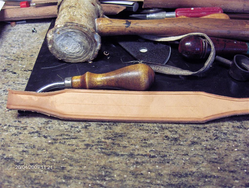

That series doesn't show how to actually do the arrowhead bw. I was making some "quicky" bootstraps this morning, and took some pictures. These will help you until I put together a full blown tutorial.
Everything depends on lines. First a border/edge line. Then a line just inside that one. Then a center line. You can draw them lightly, or bevel them...all your choices.
1st stamp - Put right front heel on center line. Left rear on inside line.
2cnd -put right lower heel in previous stamp. Front right heel on center line....repeat and rinse..lol
3rd - coming back on other side repeat. match points at center line.

  • Contributing Member
Once more, with feeling...lol
LINE1 - edge line
Line 2 - left heel of tool. and guideline for camo tool
Line 3 - Center line, right top leg hits center line
If the angle is too great, the arrow formed is fat and squat.
Too skinny, and the arrow looks like a nail.
It really is just a matter of some practice scraps to see what angle you want. Draw lines accordingly.
