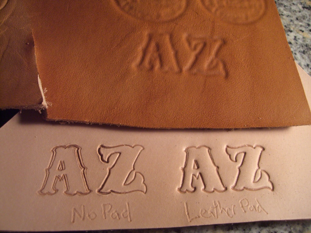

Members azrider Posted May 13, 2009 Members Report Posted May 13, 2009 I have done my last three or four projects out of 2-4oz leather. One of the problems I have had is that large stamps, like letter stamps or the barbwire borders always seem to bounce. Last week I ordered a maker's mark, and when I tried it on the thin leather it bounced quite a bit. I made about 40 attempts to get a clear impression, and was getting kind of upset about it. I use the standard Tandy Poly mallet, and am too cheap to buy a dead blow hammer with out trying everything else first. I did decide to dig in the scrap bin, and found a few pieces of thicker leather. Some 10-11oz saddle skirting took the impression perfectly once it was cased. There was not bounce at all, and I could actually strike the tool a few times if needed. Since it worked on the thicker leather, I tried putting the thin leather on top of the thicker leather, and it worked like a charm. I think it just needed a certain thickness of leather between it and the marble to keep from bouncing. Can anyone see any reason why this might be a bad idea? Quote Drygulch Leatherworks- Baldwin City, Kansas www.drygulchleather.com
Contributing Member TwinOaks Posted May 13, 2009 Contributing Member Report Posted May 13, 2009 Umm....having a leather pad under the thin leather might allow it to stretch more during tooling? Quote Mike DeLoach Esse Quam Videri (Be rather than Seem) "Don't learn the tricks of the trade.....Learn the trade." "Teach what you know......Learn what you don't." LEATHER ARTISAN'S DIGITAL GUILD on Facebook.
Members azrider Posted May 13, 2009 Author Members Report Posted May 13, 2009 I didn't think about the stretching. I tried a few stamps, and it seems like the streching gives them an almost embossed from the back look, in addition to giving a more equal depth for the cuts. Would this weaken the leather signifigantly? Quote Drygulch Leatherworks- Baldwin City, Kansas www.drygulchleather.com
Ambassador Luke Hatley Posted May 13, 2009 Ambassador Report Posted May 13, 2009 how thick is your Marble slab and what type of surface is your marble on. Quote Luke
Members azrider Posted May 13, 2009 Author Members Report Posted May 13, 2009 Its the standard inch and a half slab from Tandy. (It looks like granite, not marble now that I look at it.) I keep it on top of my rubber cutting mat, on a formica desk. Quote Drygulch Leatherworks- Baldwin City, Kansas www.drygulchleather.com
Contributing Member TwinOaks Posted May 13, 2009 Contributing Member Report Posted May 13, 2009 Formica desk may be the culprit. See if you can move to a more stable foundation...even the floor will work for testing purposes....and try a few. Quote Mike DeLoach Esse Quam Videri (Be rather than Seem) "Don't learn the tricks of the trade.....Learn the trade." "Teach what you know......Learn what you don't." LEATHER ARTISAN'S DIGITAL GUILD on Facebook.
Members DG Leather Posted May 13, 2009 Members Report Posted May 13, 2009 I use 2-4 oz leather lately and have had no issue with it bouncing..... Here is what I do.....in my living room on a carpet floor..... I built a work table.....2x4 frame with 3/4 inch plywood...the legs are 4 x 4 treated posts. on top (directly over) the 4 x4 post leg I put my 12/5x17x 1" black polished granite....I put packing tape on the back of the leather to prevent stretching..... and then I pound my DEAD cow....... When i use stamping tools I hold it like a pencil and if it is letter stamp I hold it where the stamp clicks on to the handle and i hold it literally as tight as I can pressing downward.....I got a 20 oz rawhide hammer..... and I give it 1 single hard shot and every time i do i cringe that i am about to demolish what is left of my busted knuckles from younger years......Alls I can say is leather work as taught me that all the faces i hit was not worth it cuz now 1 hour of leather work and my hands sieze up (more info than you needed....but I am sure you will live!) hahaha anyways I am new to leather workin but from reading these threads repeatidly daily...probably obsessively.....I learn alot... PS Obsessed is a word use by "lazy" people to descibe the "dedicated" Quote

Members DreadPirateRedbeard Posted May 13, 2009 Members Report Posted May 13, 2009 I like that ghost look on the upper piece. I have a new little trick for effect. I can incorporate the "ghosting" with regular tooling. Now to create a piece to try that look on! Quote Don't be scared live to win, although they're always gonna tell you it's a sin. Grab ahold don't let go, don't let them rob you of the only way you know - Motorhead The key to immortality is first living a life worth remembering. - St Augustine
AndyL1 Posted May 14, 2009 Report Posted May 14, 2009 I think of all the leather you may waste having ghosted stamps would be a lot more expensive than spending 8 bucks on a deadblow hammer from Harbor Freight. I always use the right tool for the job. Just my 2 cents. Quote Blackthorn Leather on Etsy • Blackthorn Leather on Facebook
