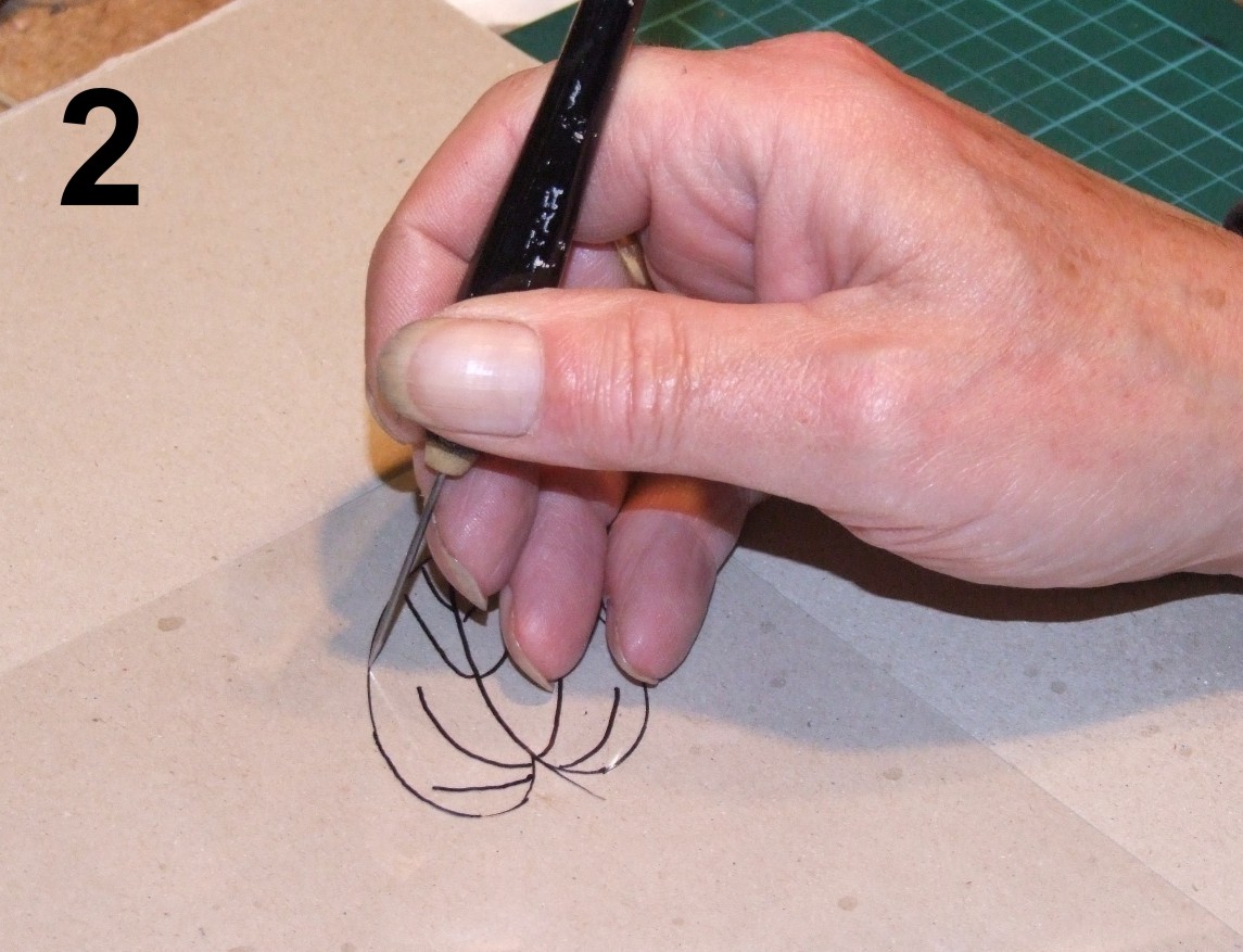

1. Trace the design onto the film with a fine waterproof (spirit-based) pen.

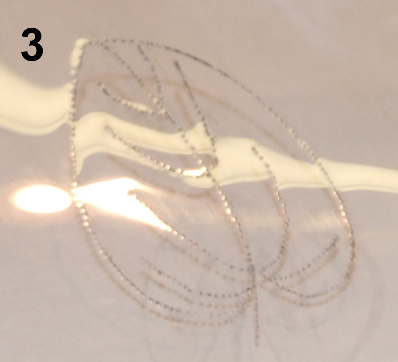

2. Prick through the film with a fine-pointed needle, following the traced lines, with prick-marks about 1mm apart. Don't prick through too deeply . . . just enough to penetrate the film.
3. The prick-marks will raise little 'pimples' on the underside of the film.

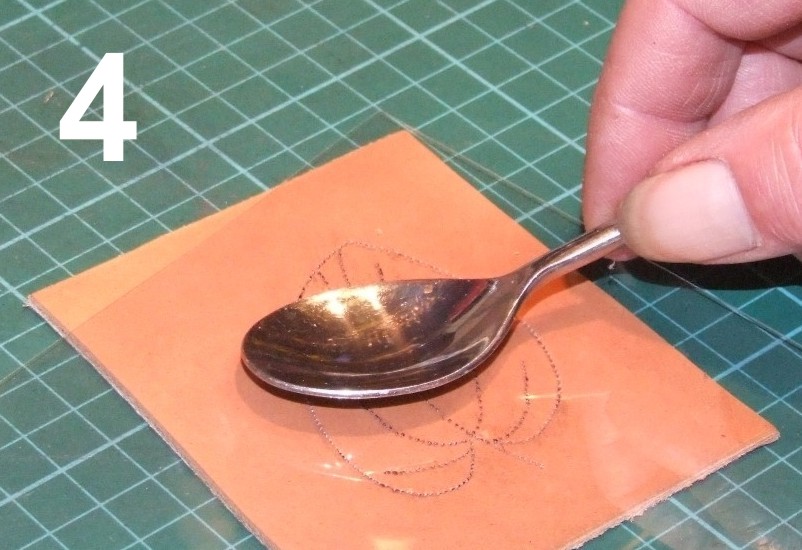

4. Position the film, right-side up, onto the cased leather, and rub over gently with the back of a spoon or a smooth burnisher.

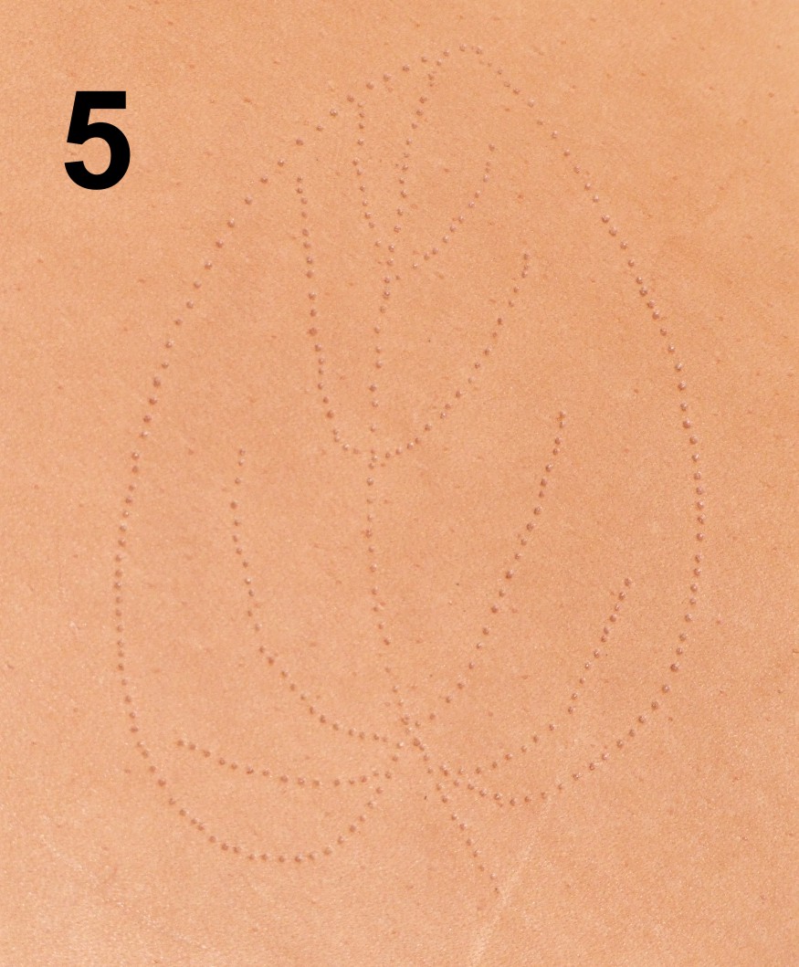

5. The pimples on the back of the film are transferred to the leather as a series of dotted lines.

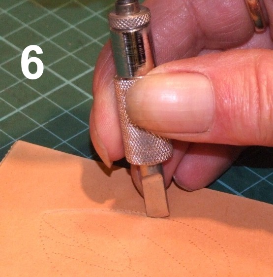

6. Either join the dots with a fine stylus, or carve directly along the dotted lines. If you stray slightly off the line, it's not a problem - the dots will disappear when the design is bevelled.
